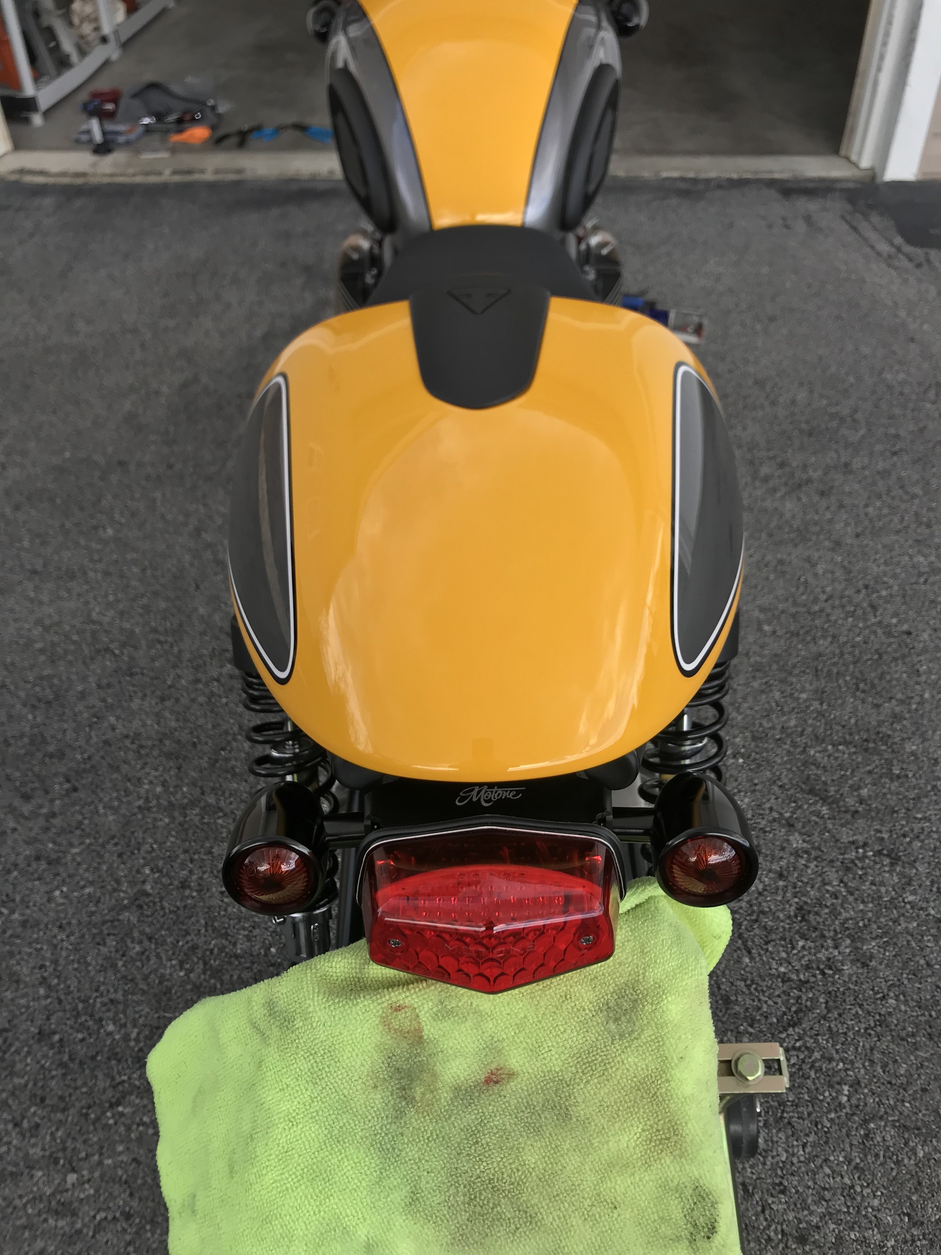

    Here’s what I have to work with, starting with the rear first, my 2018 Street Cup. I already have the Motone tail tidy, which wouldn’t change the addition of these signals too much.

    The lights are an easy straight bolt on, the hardest part being getting them at the angle you want and matching. The only hang up was that the oem lights had bullet connectors slightly larger than the ones on the Motone lights, and caused them to fit loosely. Squeezing the connectors on the adapter harness tightened them back up, no problem there. The rest was just running the wires to suit your preferences.

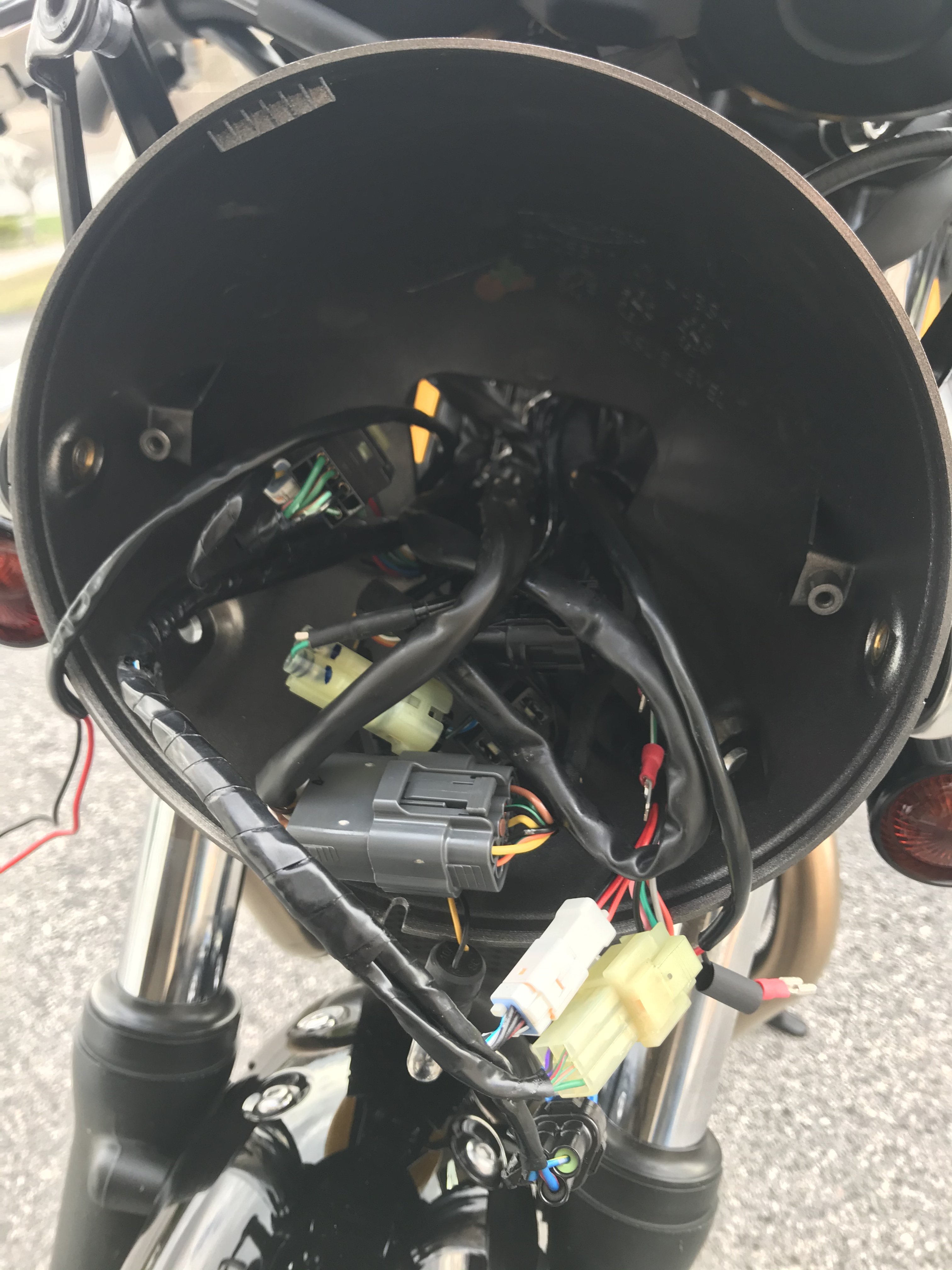

    The wiring stuffed into the headlight bezel can be a nightmare! Don’t panic, take your time, and take pictures! A Haynes manual will help and I suggest it as the very first thing you ever buy for your bike.

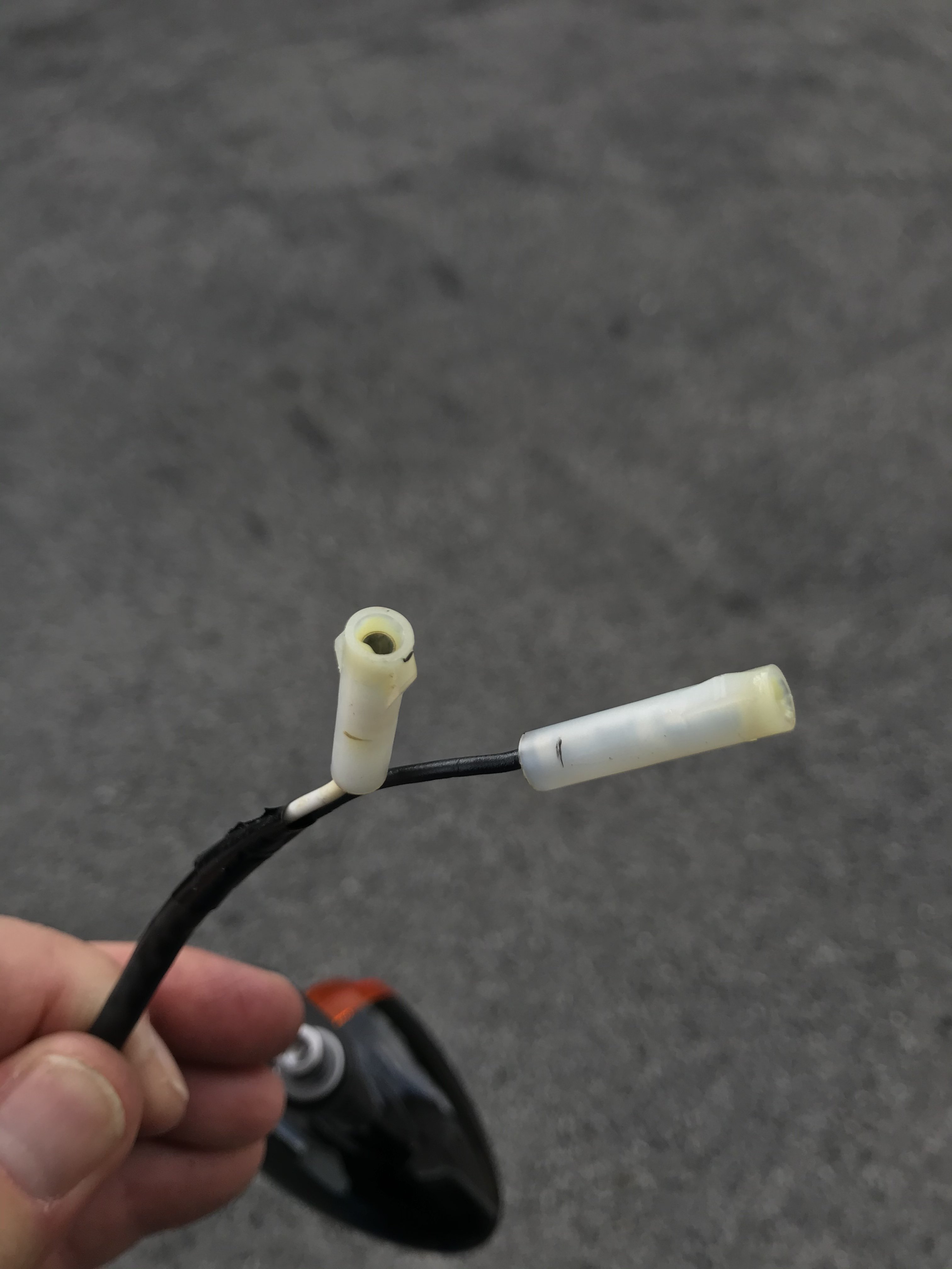

    So here’s where I hit my first snag. I didn’t realize that the powers that be at Triumph do not know what consistency is. At the back the indicators plugged right in with the supplied and prewired harness, at the front the factory used a completely different and female bullet connector on the oem indicators meaning the new ones will not simply plug in.

    My mistake was that I did not realize that Motone offers an adapter harness for the front indicators that allows plug in installation without cutting the original harness. They do not mention this is needed on the listing when purchasing the lights. It only cost about 15£ and would have saved me a bit of bother. One quick run to the auto store had me sorted though! I chose to go ahead and cut the oem connectors off the harness and replace them with insulated spade connectors. I also used a bit of shrink tubing to ensure they are protected and will not come loose. If I ever need to reinstall the factory lights I can simply change their connectors to plug in.

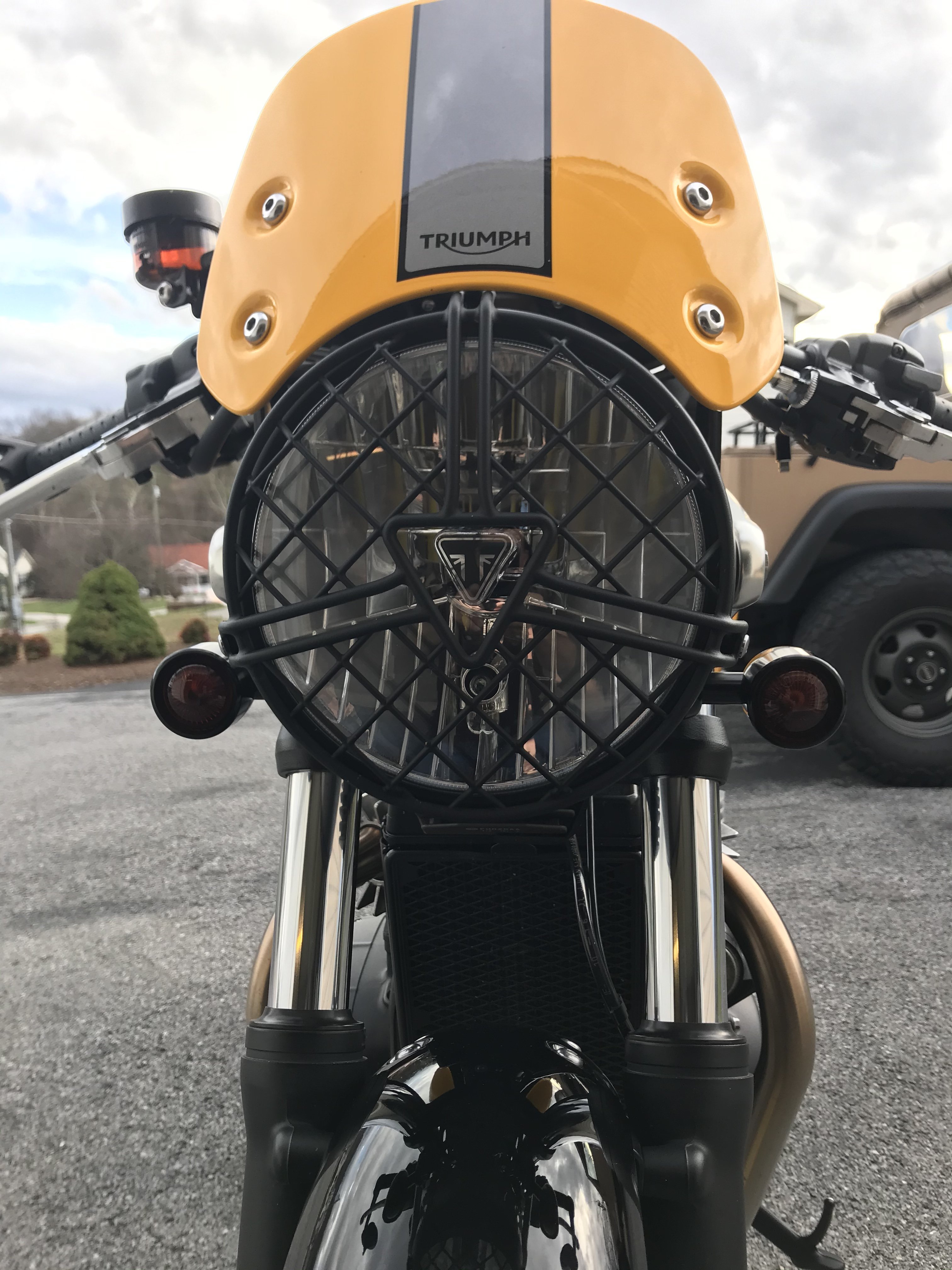

    This was a definite change for the front of the bike, getting rid of that hammerhead shark look.

    Over all I’m very pleased with the result, and other than a couple fiddly bits not a difficult project. I completed it in an easy afternoons work. The sleeker low profile of the lights almost disappear on the bike, but when you notice them they look quality that fits the finish of the rest of the bike. As far as safety they are as bright and noticeable as the factory units, and have the E and DOT markings for legality. They come in several finishes to suit any bike, including black anodized with brass bezels if you don’t want plain black, brushed silver, and polished silver. Hope the few details I’ve mentioned helps someone, as I’ve not seen any installs mention them. Cheers!
