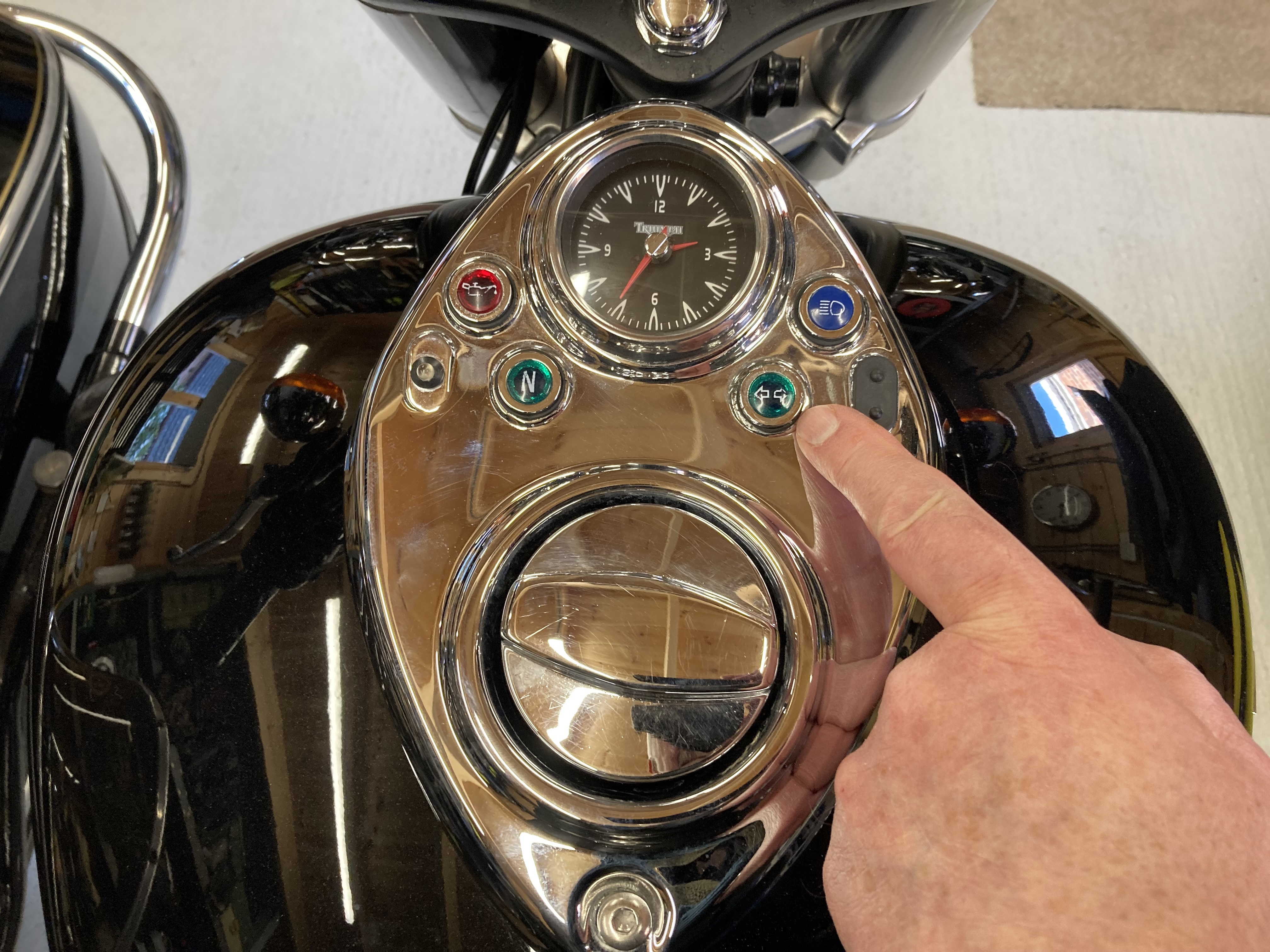

    I have a 2009 America, and have changed all the main bulbs to LEDs. All working ok except the idiot light on the dash for indicators. Due to the piss poor construction of this light (ie a small bulb pushed in an inacessable rubber holder) it was shorting and making the r/h indicator flash when the l/h one was selected. To remidy this I have disconected the idiot lamp. My question is, Is this an MOT requirment? I still have an audible alarm for the indicators. Any MOT testers out there I would appreciate your advice. Cheers in advance.

    Unfortunately I'd have to respectfully disagree @Pegscraper as the " if its fitted, it has to work" mentality applies in my opinion.
    If the light lense wasn't there i.e. a grommet in its place, then possibly a pass.
    Think about daytime mot's, as soon as you put one light on the bike, you have crossed over the line.

    @MICK LEONARD As @Eldon said take the holder out and replace with a blanking rubber it should pass as the bleeper takes the place of the light.

    Many thanks for the replys on this. Its a grey area and I have just brought some 3mm led lights with inline diods from amazon (still waiting for an invite to bezos yacht) and will try to cobble together an idiot light to fix this. Will post the result.

    "A tell-tale is not needed if a direction indicator on each side of the motorcycle can be seen from the riding position. A direction indicator tell-tale can be audible or visual."
    I would take from that that the OP's problem is not a fail as he has an audible tell tale.

    Hi Martin, many thanks for that link, and it explains exactly what I was asking. So as I have an audible tell tale (even though I can see the indicators from the riding position, as stated earlier up on the guidance) I don't need a visual one. Cheers
