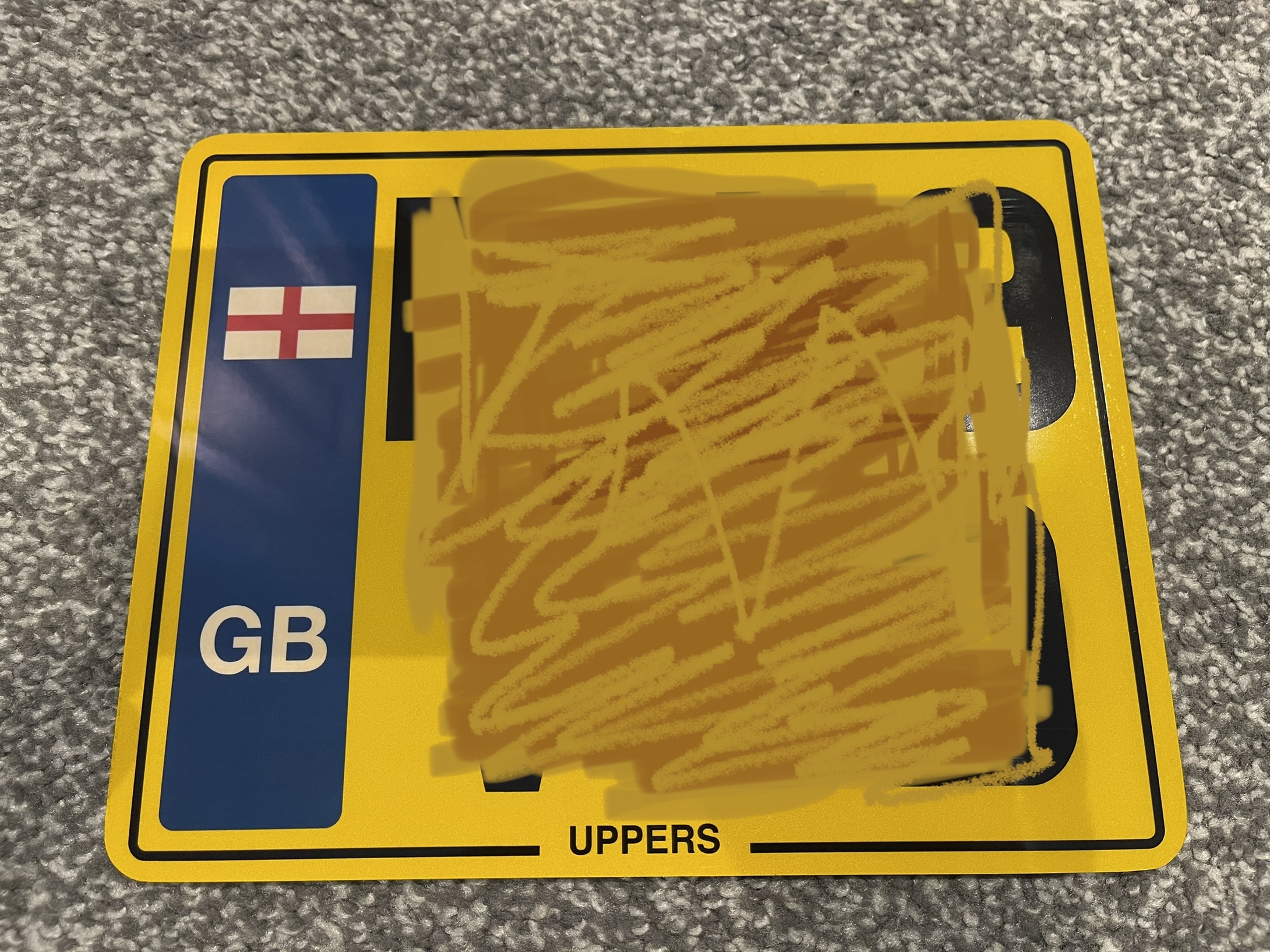

    Just had a plate made for my upcoming MOT. In hindsight I should have just got a simple version made but instead I added a border and the GB badge.
    From the my research this all seems fine - a border is allowed proving there is a 5mm gap, GB and the flag also allowed if no wider than 50mm and reflective.
    Should I order a plain one to be safe?

    Being pedantic. Legal plates can only be done by registered number plate suppliers and their name and post code will be on it, as will the British Standards mark to say it meets the correct standards. (See the DVLA rules.)
    Yours just seems to just have 'Uppers' as a makers name (I.e. your username here) so I'm guessing you didn't get this done by an authorised maker. Who would have asked you for proof of ID and proof you have a right to the number plate, e.g. V5 document.
    Now whether an MOT tester would check all that is doubtful, but just thought I'd point out you don't seem to have a legal plate. (For my bike I once got a plate from a registered supplier that didn't have the legal character shape :()

    Being pedantic, it's UK, not GB as country identifer now...

    That’s a good spot and yes, it was not via a formal legal source. I should get an official one made up to be on the safe side given I cut the original one down just a bit to much.

    The GB is no longer acceptable on your plate for travel abroad. U.K. is now our designated initials. I just bought some U.K. stickers and stuck one on my existing plate.

    To be even more pedantic ........
    1) There is NO legal minimum size for a number plate - the size will be governed by the legislation around the letter/number configuration; the character sizes and spacing and the minimum space surrounding them. The layout is governed only by the registration 'style'. So, technically, if you were fortunate and rich enough to have a motorcycle with the VRN "ABC 1" then the actual plate size could be (legally) very small indeed - can't be arsed to calculate the size as it's all stated in millimetres and I'm a non-metric sort!
    2) The plate needs to show the British Standard Number (BSAU145d); manufacturer's identification and suppliers name and postcode.
    Having a standard one fitted for the test is a sensible idea since, if you got pulled for a dodgy plate on the way home from your test, both you AND the tester could/would be in some trouble.
    I know that the tester I use would pass my bike with a small plate but I wouldn't compromise his integrity (and his tester's licence) by risking getting caught with it on within a few hours of it being tested.

    Being ultra pedantic….
    Unfortunately your information source is incorrect.
    There should be an 11mm gap between the letters and the country identifier, not 5mm. That black border is also too close and should also be 11mm away.
