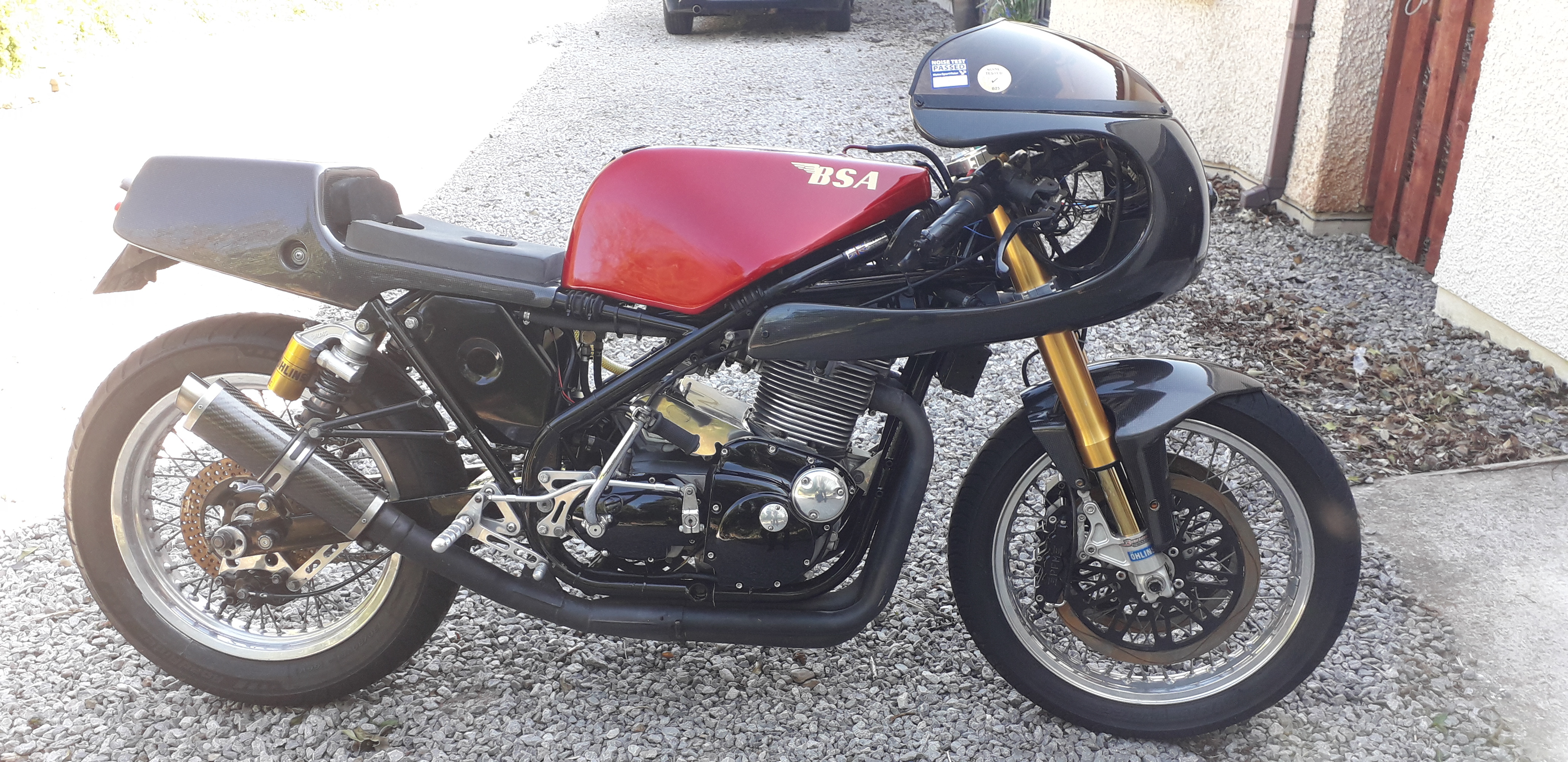

    Spent an hour or so Polishing the Harrier today. Even managed a blast up n down my drive just to check it was OK

    988cc 850 big bore and stroked crank/, megacycle cams and Keihin CR carbs .
    it goes well :)

    What a real gem it is. Got me dribbling with excitement. Tell us some more about it and the engineering that went into building.

    Joe. Basically the Harrier was a commission from Norman Hyde to. Harris Performance to build a frame very similar to the One used on tbe Rob North triples.
    The main difference is comfort i think as this feels a bit more comfy thsn a North.
    This bike has the same steering geomoetry as a n R1 yam, the yokes are one off items made by harris.
    Tbe forks are of an Aprillia and tbe discs are gsxr1000 with pfm calipers. It stops on a sixpence. The hubs front are resr are one offs.
    All the carbon fibre was hand laid by harris and looks superb close up.
    Unfortunately i cannot take credit for any of the work it was done by a man called Nigel Waring.
    Oh and the engine was built by Neil Beadling who is regarded as the go to person for meriden triple engines. It runs a Newby multi plate clutch with belt drive and semi close ratio 5 speed box.
    It has a Trispark ignition and uses Dyna coils.
    Since my ownership i have fitted lights to it . Led spots on the front and more recently an electric start as it can be a bugger to start and if it kicks back you know about it. It caught me last yesr and i had a bruise on my calf for two weeks, funnily enough i never tried to start it without a bike boot on after that Lol.
    I had it on the dyno last year as it seemed to be overfuelling. It was doing 25mpg. I bought a set of leaner needles and shimmed them to get the AFR where i wanted it and i now get about 37mpg and that is round tbe lakes which has lots of twisties :D:D:D.
    It truly is a mix of the old and the new and sounds glorious with the 3 into 1
    I spoke with Nigel and he said he stopped counting tbe cost when tbe budget exceeded 25K.

    Lovely bike Feckless.:cool: That dyno sounded amazing:p. With the extra mpg, did you get smoother running, especially at idle or surging?

    Bottom end is way better pulls niceand clean from 2k revs
