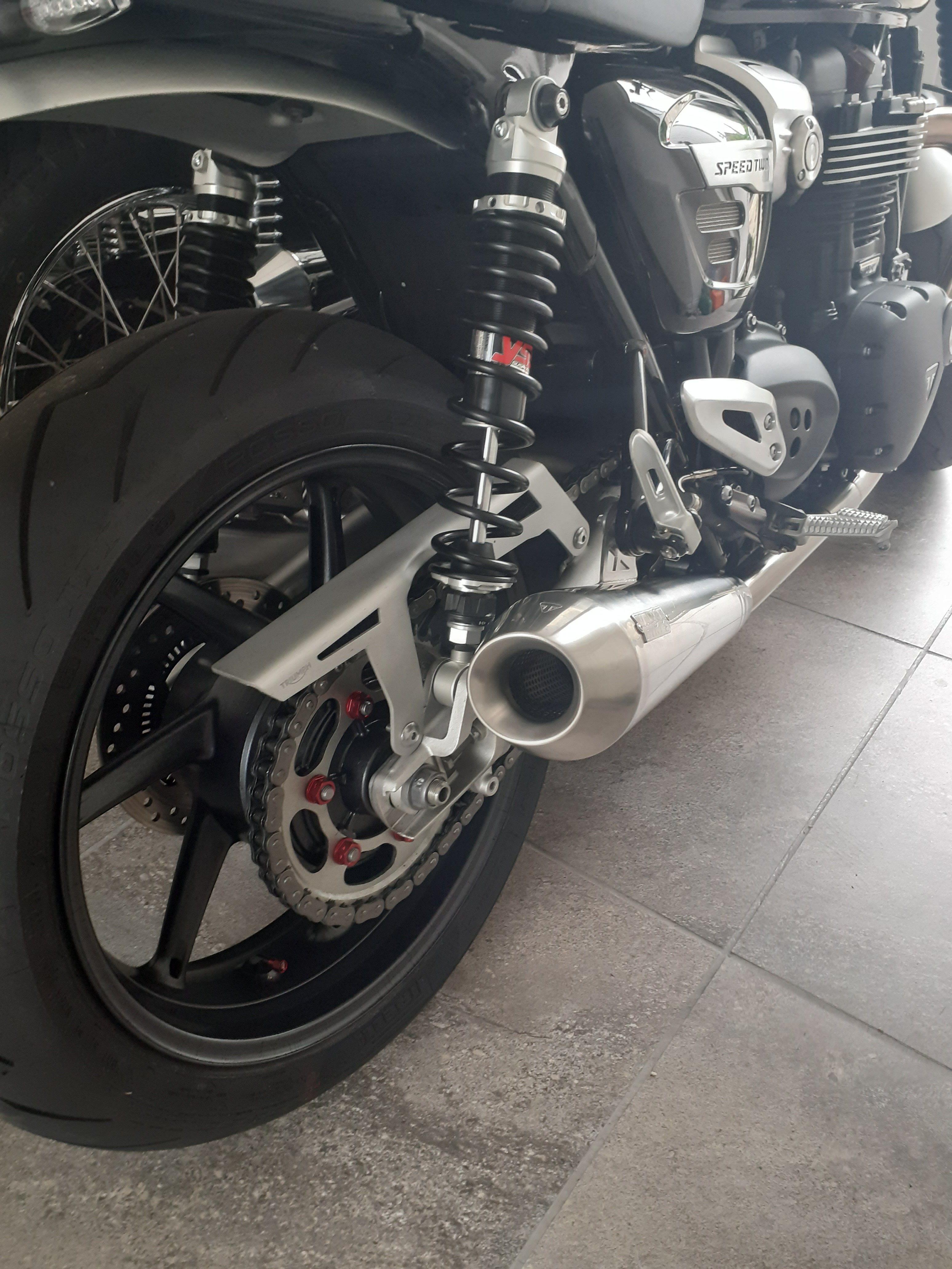

    So the bikes are both run in and the first 500 service done, we had the decat done before collecting the bikes as part of the deal and should have had V&H cans as well but they did not arrive in time so eventually got them done on the first service this week :) They sound good with a deeper smoother note and we will get some miles on them before i decide on drilling the baffles. As we are both tippy toe on the bikes i have found some YSS shocks that allow me to lower the rear 10mm and they also have nice spring adjusters and rebound adjustment as well making it nice n easy to set the sag for us both and i have gone with the standard spring and Su has the next one down as she is lighter than me, i have also dropped the yokes over the legs 10mm to keep the trail the same for now. First impressions of both of us riding my bike with the mods and Su's bike standard back to back are good so i will get Su's bike done next :)

    Both bikes done now as i was waiting for some spacers for Su's bike that go in the bottom mount, Surprising how just 10mm front n rear make all the difference. Su is now both feet flat foot and i have a good part of the ball of my feet down and a bonus they look good.

  5. Bryf
    Bryf Guest
    Just noticed the red anodised nuts on your sprocket, they look good :heart_eyes: Where did you get them???
  6. darkman
    7,629
    Evilbay, think it was Brooks Barn ?? just type sprocket nuts red Triumph :)

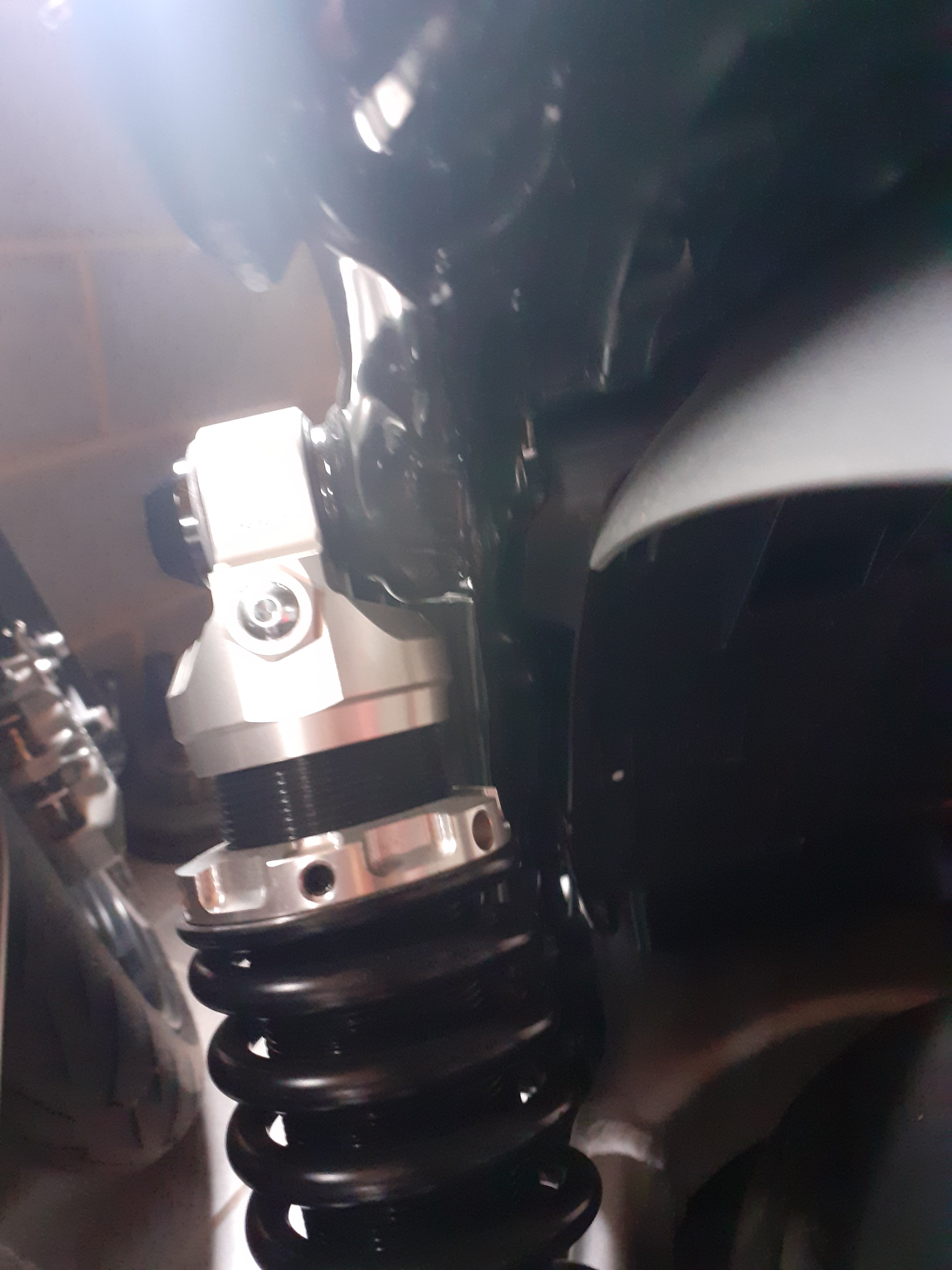

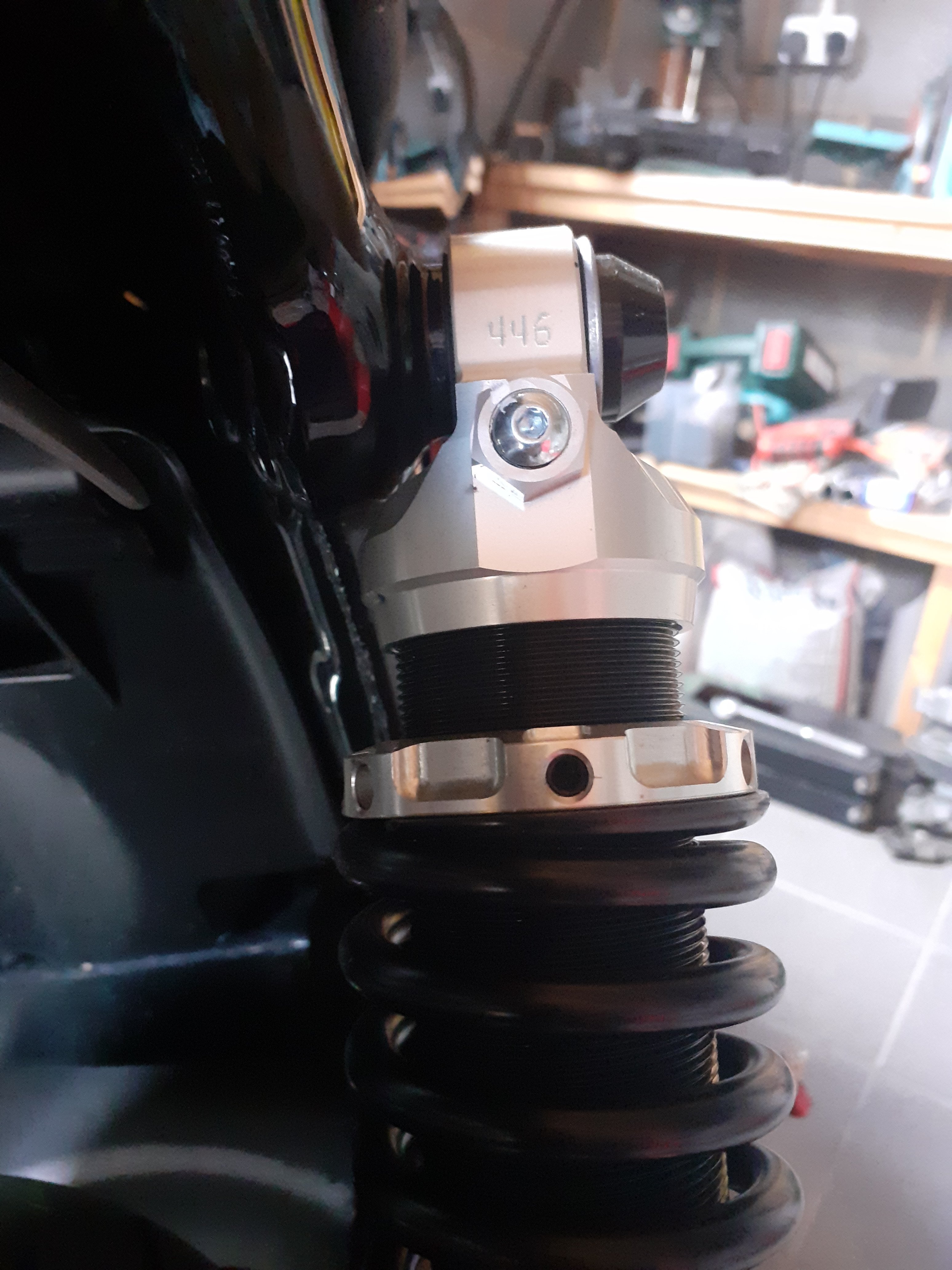

  14. Ethan_Rogers10
    Ethan_Rogers10 New Member
    Jun 21, 2020
    27
    United Kingdom
    Quick question - any reason you didn't use the original spacer that is used for the stock shock?
    Also how are you finding clearance between the top of the shock and the frame after now having them fitted long term? Did you fit spacer washers or leave as is?
    Thanks
  15. darkman
    7,629
    Hi, in June 2019 YSS did not make a specific rear shock for the Speed Twin so i just bought a pair of 10mm shorter shocks off the shelf and modified both mounting holes/spacers top n bottom to fit the bike, there are no washer/spacers fitted other than the outer retaining washer at the top and no clearance issues.
  16. darkman
    7,629
    Here are pics
