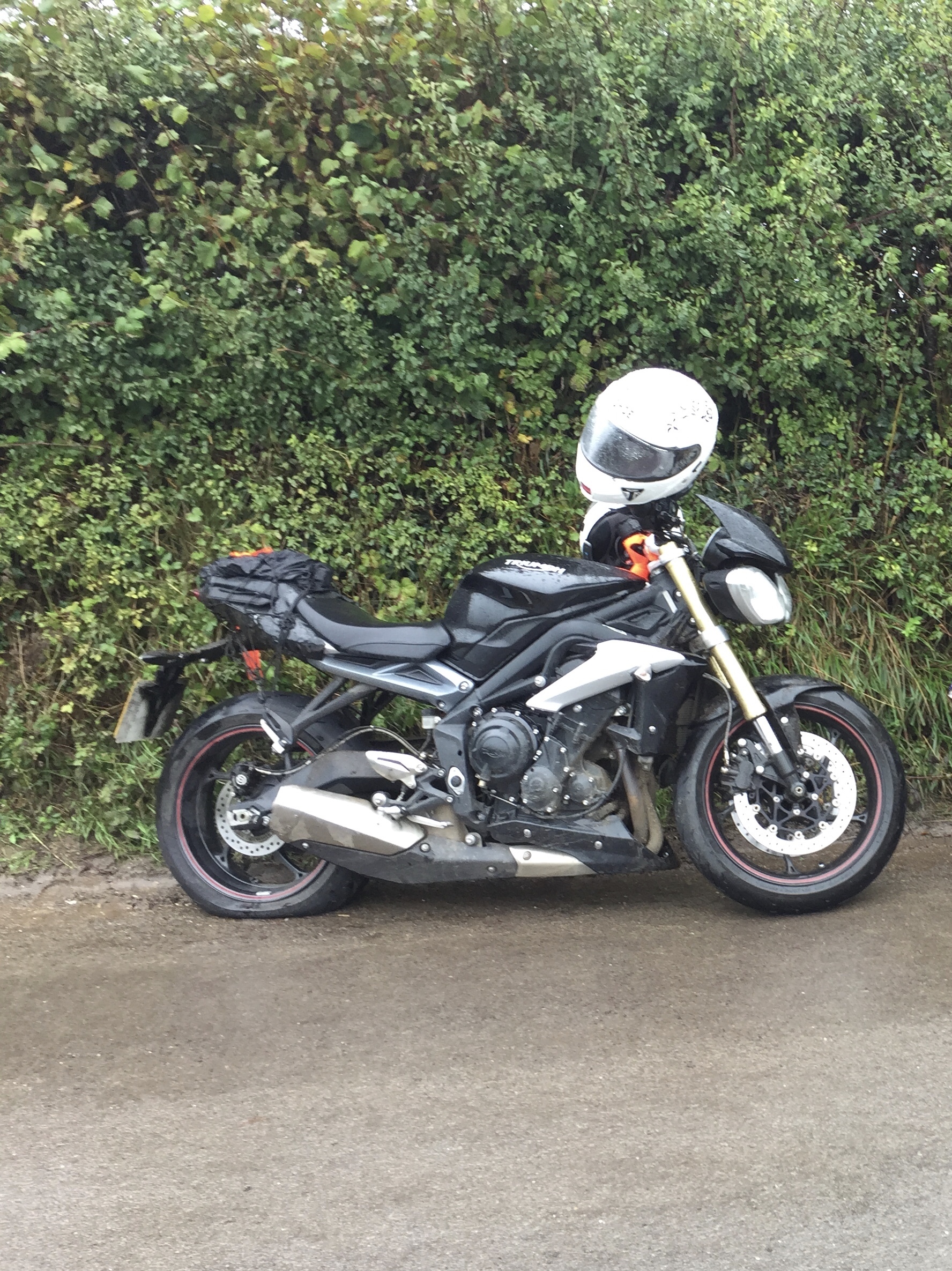

    I have a michelin road pilot 5 on the back and pirelli corsa on the front. Have heard lots of stories about mixing makes. Reason for the mchelin on the back is a puncture on a Sunday far from home and it was the only tyre that I could get at the time ( thanks Laguna Triumph -you saved my bacon!)
    Has anyone had any issues with different makes on their bike?
