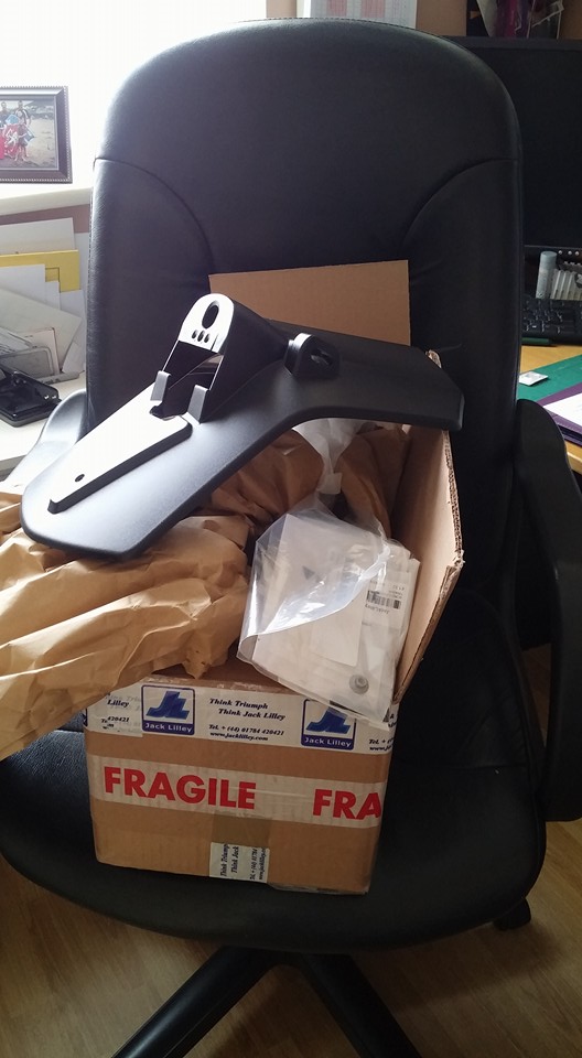

    Found out that Triumph do a full mudguard version of their street only offered abroad so Jack Lilly can get me one to replace the stalk number plate holder, should keep she who must be obeyed back cleaner and dryer.

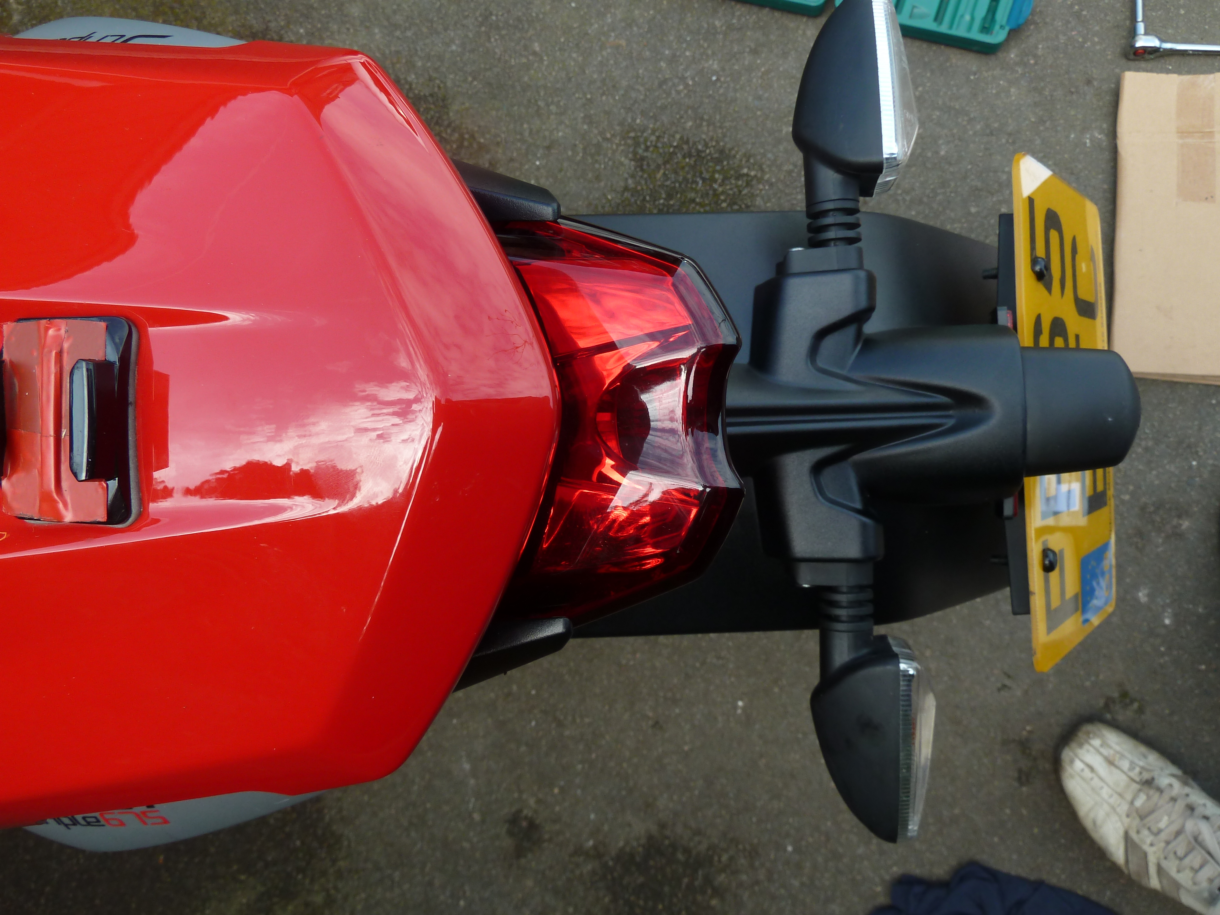

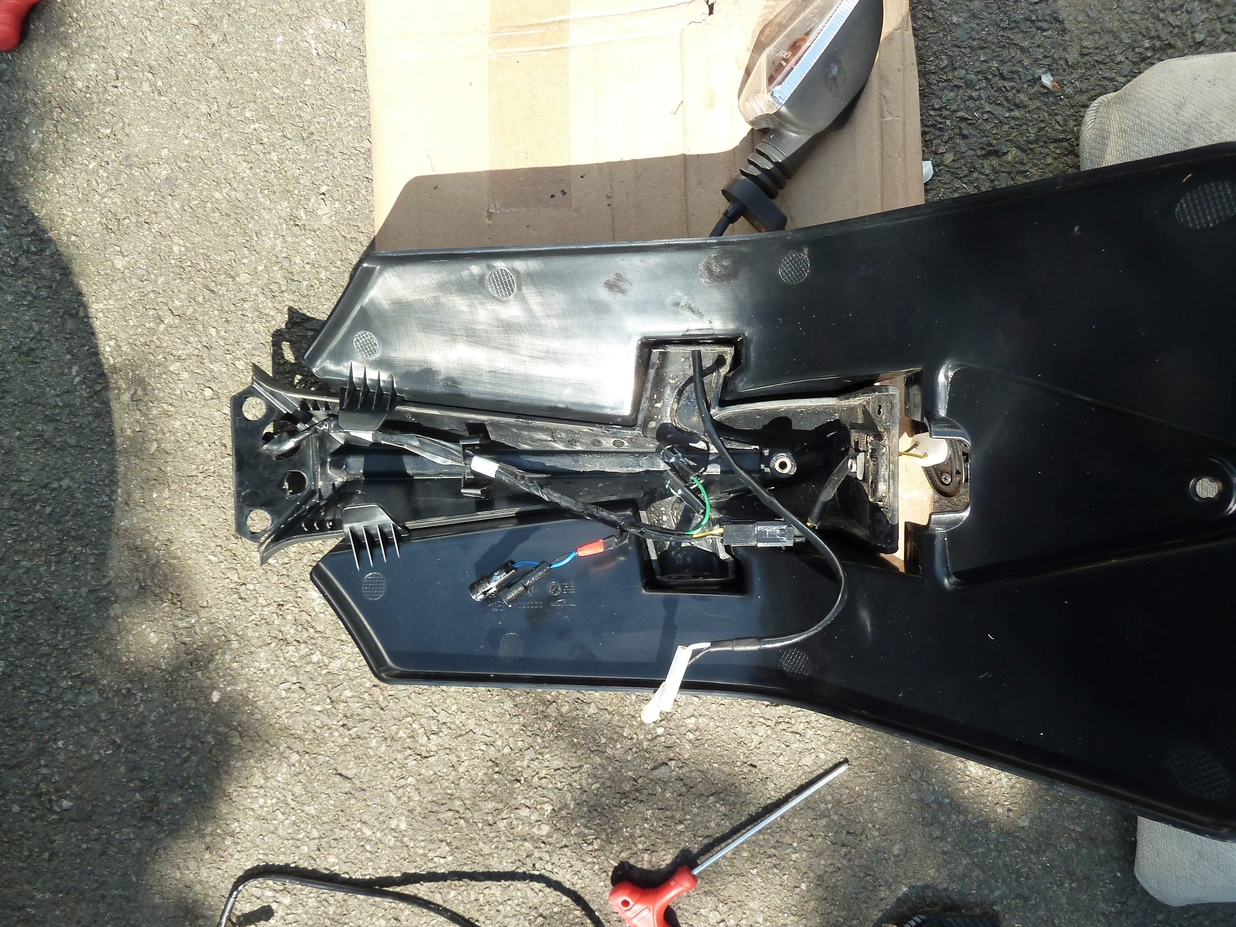

    Mods so far on the Street: Belly pan, front cowl, heated grips, full engine crash protection including sliders, paddock stand bobbins, S W Motech Sports tank bag with quick release tank ring, SW Motech Blaze soft panniers. We have also bought the item below which is supplied by Triumph in some countries (not here) and when fitted over the existing stalk number-plate stem will make a full mudguard for the back

    I'm sure many owners will hate the look of this but its on to do a job. Its a Triumph part; Jack Lilley Triumph were very helpful and got it to us next day.
