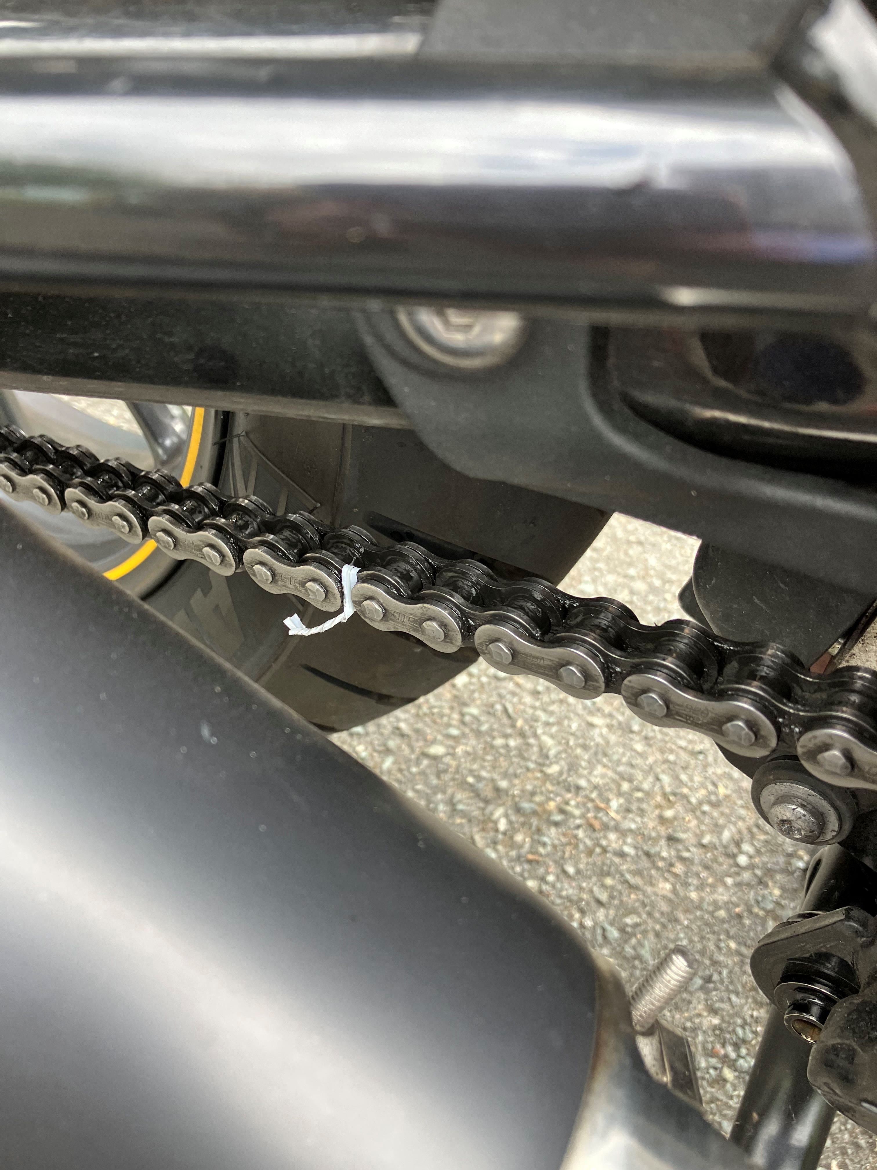

    You all probably know this trick but my brother showed it me year or so ago and I thought I'd share it.
    I hate cleaning, adjusting and lubricating the chain its messy and time consuming and I rather be riding or getting on with life than that level of maintenance. Its also my experience that I tend to over lubricate the chain and end up with lube flung over the back wheel, the back of the bike and sometimes the back of me!
    One of the reasons is that when the lube I use is sprayed on the chain it comes out thin and clear so its hard to see where it is and whether I have applied it to the complete length of the chain, so I tend to run the chain round several times to be sure I've covered the chain and so I end up putting too much on.
    But ... if you twist a bag-tie around one of the inner links on the chain you now have a landmark to work to; see below.
    They're thin enough not to jam in the final drive, so start applying the lube while rotating the wheel (by hand not the engine for obvious reasons!) and when the tie arrives where it started you know when you've covered the full length of the chain:cool:. Remember to remove the tie when you've finished for obvious reasons! Thanks Bro, really helpful tip:).

    Most modern machines have chains with the soft link a different colour, this is for quick identification come chain and sprocket renewal, so it is easy come chain cleaning and lube nothing else is needed, also with modern chain lubes you can easily see where you start (if no colour soft link is present). I am not sure why it needs to be more complicated than it needs be.
  6. RevPaul
    RevPaul Senior Member
    Apr 21, 2020
    753
    Cheshire, UK
    I don't think I am making things complicated, just the opposite.
    The 2018 Street Cup chain didn't come with a different colour soft link, neither did the 2018 Tiger XCa that my brother owns. As for the lube; Muc Off All Weather (which I use) applies clear, thin and watery: It only thickens and adopts a pink shade a few minutes after application. So with my ancient eyesight, I can't tell when I'm overapplying lube without the simple method I shared.

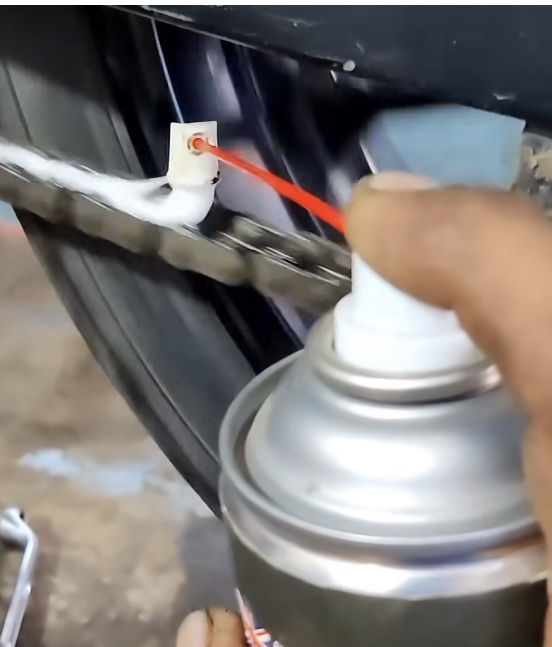

    @Sheila plenty of tips in this thread. I also use Kerosene to clean the chain every 3 months and then regrease using Motul spray.
    I have seen a video of a spray end being applied to the tube to direct the spray to the chain :idea::party:

    Fitting a spray end to trend of the tube, simple genius, wish I’d thought of that.
