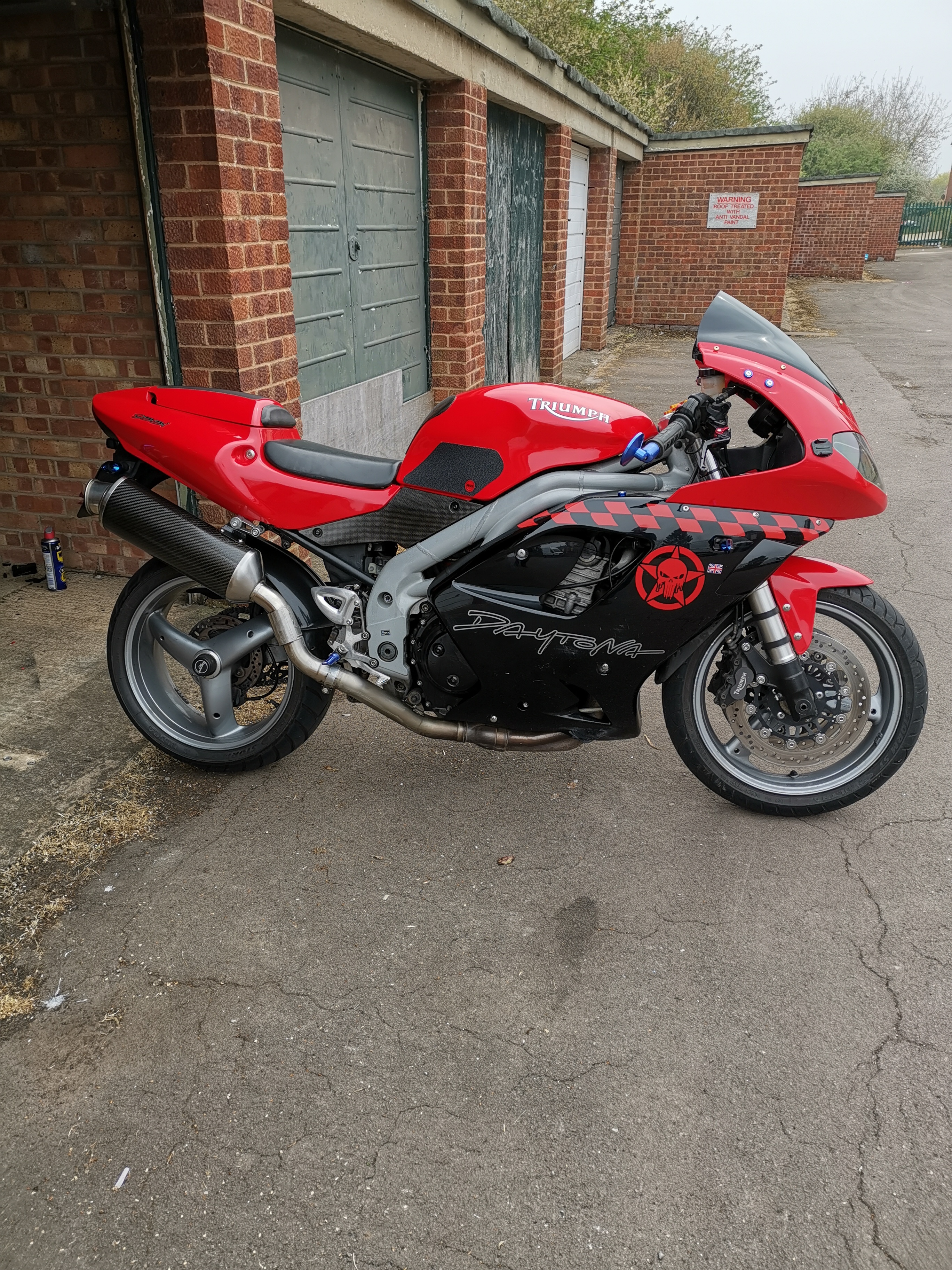

    Hi guys finally got bike back to something decent looking, I am running my 05 daytona 955i with the max mid range map and have high level triumph race can. Although bike rides well it just seems a little low on grunt won't even lift front in first gear but accelerates well. I'm going to see what air filter is fitted as got a feeling it could be k and n or something similar and was wondering whether to go back to stock to see if this crisps things up a bit. Bikes done about 45000 miles but seems to have been looked after mechanically as have loads of receipts and paperwork for bike. Anything I should be looking at to crisp things on the old girl. Thanks peeps.

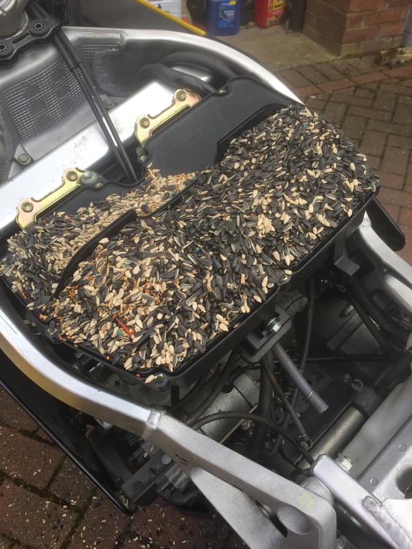

    This was my friends Blade which wouldn’t rev above 5000 rpm
  10. chipmiester
    chipmiester Member
    Mar 25, 2019
    30
    tewkesbury uk
    Holy shit that's bad
