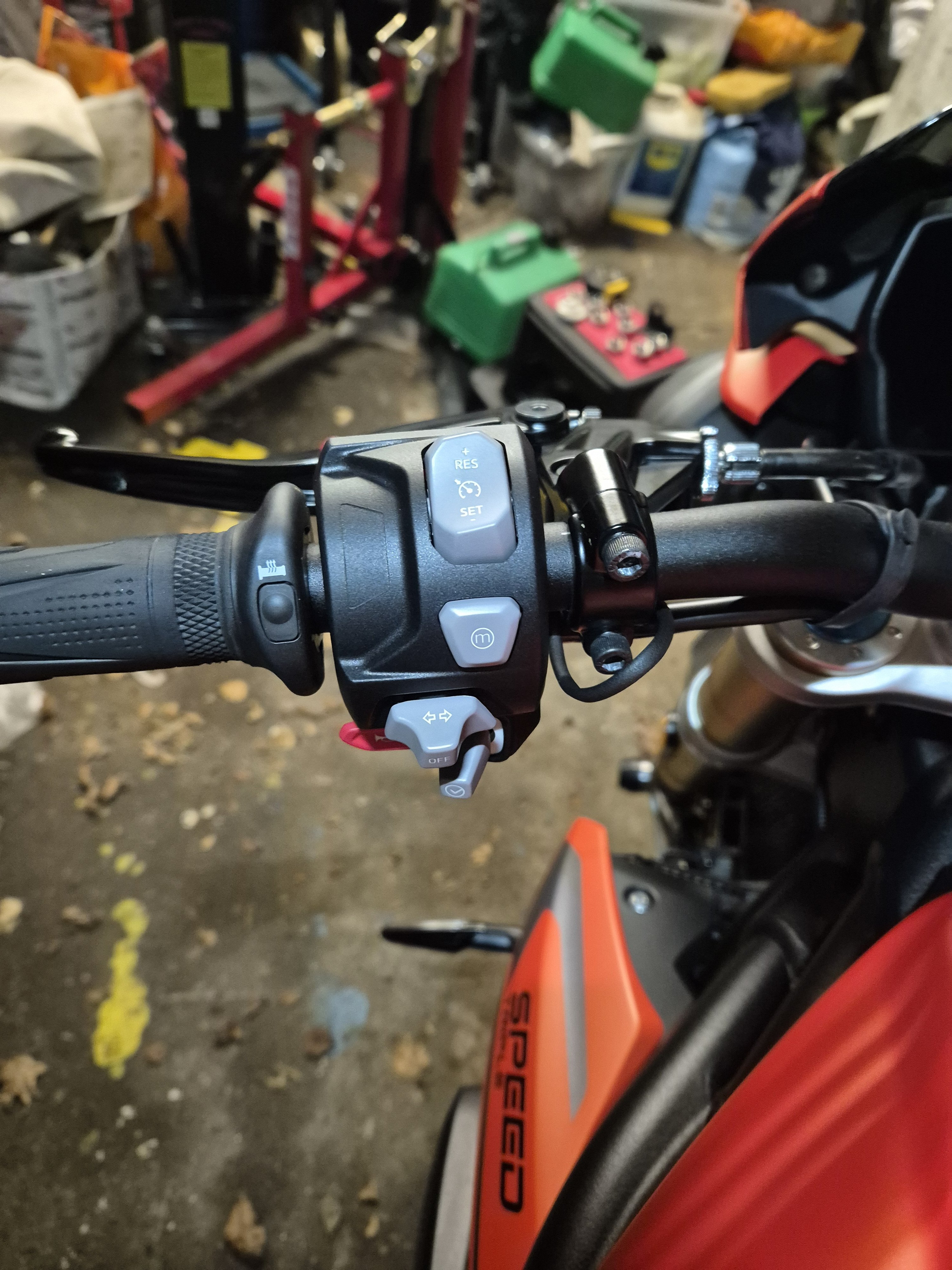

    So the toggle in the left hand switch cube started sticking and it was replaced under warranty. However the replacement does not have a switch to change between DRL and low beam. Has anyone else had the switch cube replaced with this version? UK bike.

    It was the dealer that changed it. Gave a story about the part being superceded by the one now fitted. Photo attached of new switch cube.

    So how do you now turn on the headlight low and high beams ?

    The "flash" button no longer flashes the light, instead it either put on main beam or puts it off. To "flash" headlight meand a double tap.

    Looks like the wrong part to me. Have you checked on the Fowlers website for the part?

    I agree. Two switch cubes are listed, one for DRL and one without.

    Thanks, one it, emailed Triumph aftersales and will phone the dealer.
    Phoned the dealer , wrong switch cube sent, correct one on order. Phew !!!
