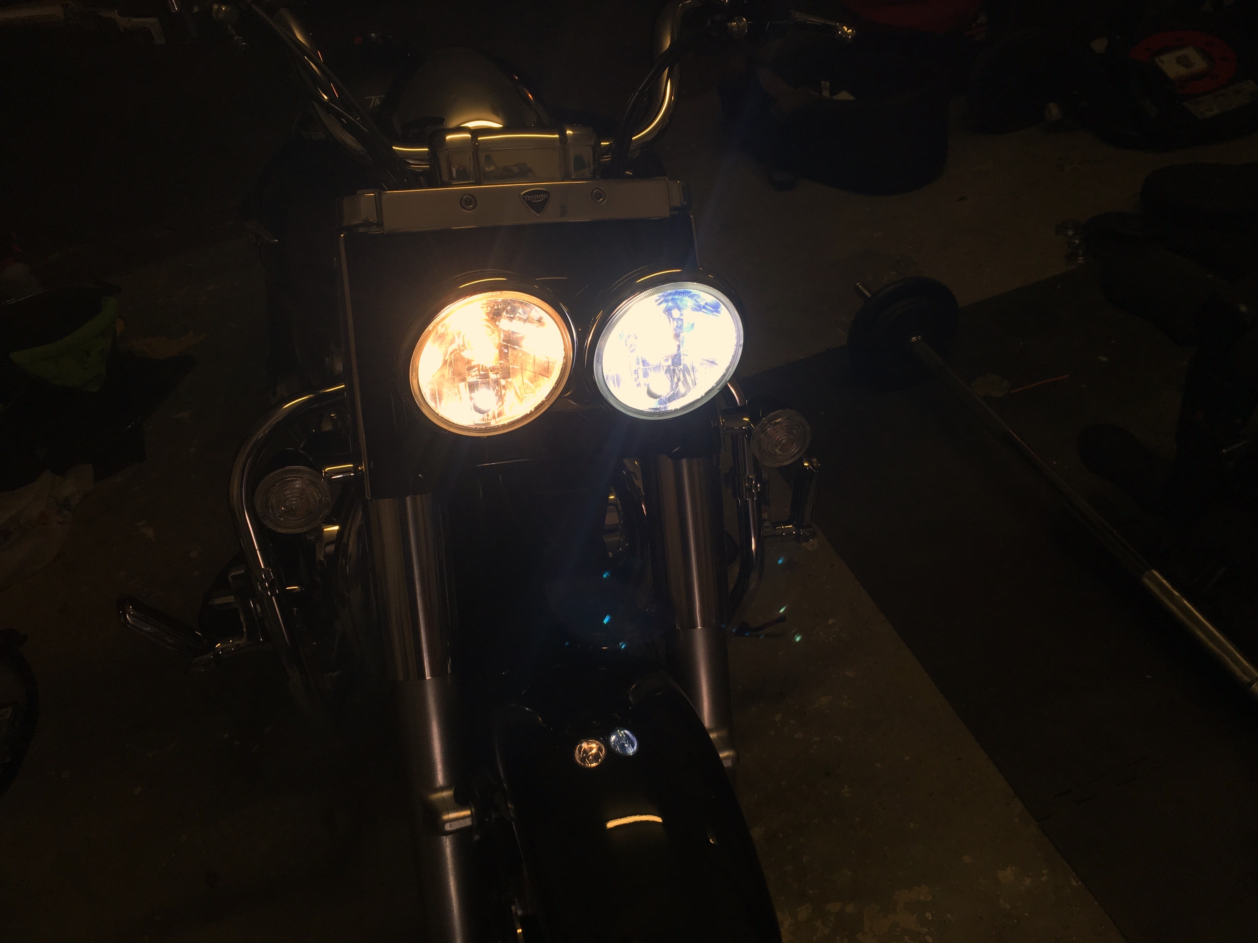

    I just wanted to show you guys that after many weeks of ordering and sending back LED bulbs for my Thunderbird Commander, I finally found a set that work.
    I ordered many bulbs, one was such a wide diameter that it wouldn't even fit inside the headlamp mirror assembly. Others would fit in, but had such a bulk at the rear the mirror assembly wouldn't fit back into the headlight bowl. Others that came with external power packs that I couldn't easily fit without disassembling half the bike. And yet another one that fit, went back together, but that didn't work as it should do with high/low beam illuminating the wrong parts of the road, due to a very strange triangular shaped bulb.
    Anyway, the bulbs that finally worked, are these ones from amazon:
    https://www.amazon.co.uk/dp/B071RBGQ6G/ref=cm_sw_r_sms_apip_f9GGTxW6klp1a
    They fit easily, went back together, have a brilliantly white light, the orientation and lighting from the bulb is as it should be, have a 3 year warranty, and best of all, the visibility at night is astonishing.
    I had originally set out to just change the very yellowy light that the stock bulbs put out as a cosmetic improvement. And this can be seen below from the picture I took having changed just one bulb below. But hadn't expected to get a significant improvement in night time riding. Hopefully the attached pic (which I don't think does justice to how good it actually looked) shows it off a little.

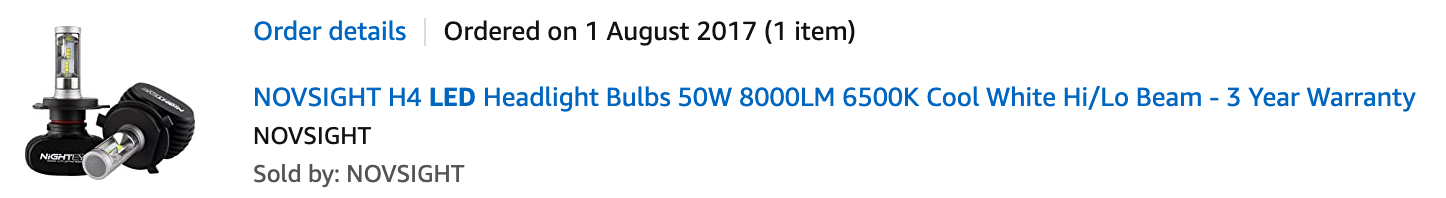

    I see the link above no longer works, but from my order history, attached is what it was at the time. There is one on amazon now branded as NightEye, but they're no longer available, but I found them here:
    https://www.wish.com/product/5833f3...ABEgIN0PD_BwE&hide_login_modal=true&share=web
    They appear the same except for the branding. Best of luck! Let me know if you get them and how you get on.
