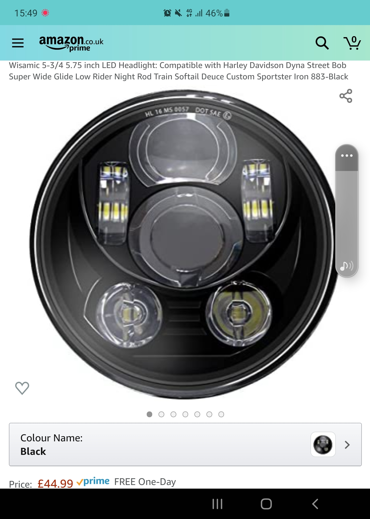

    Thanks for the Information. I'm tempted to try this one from amazon, but still on the fence at the moment.

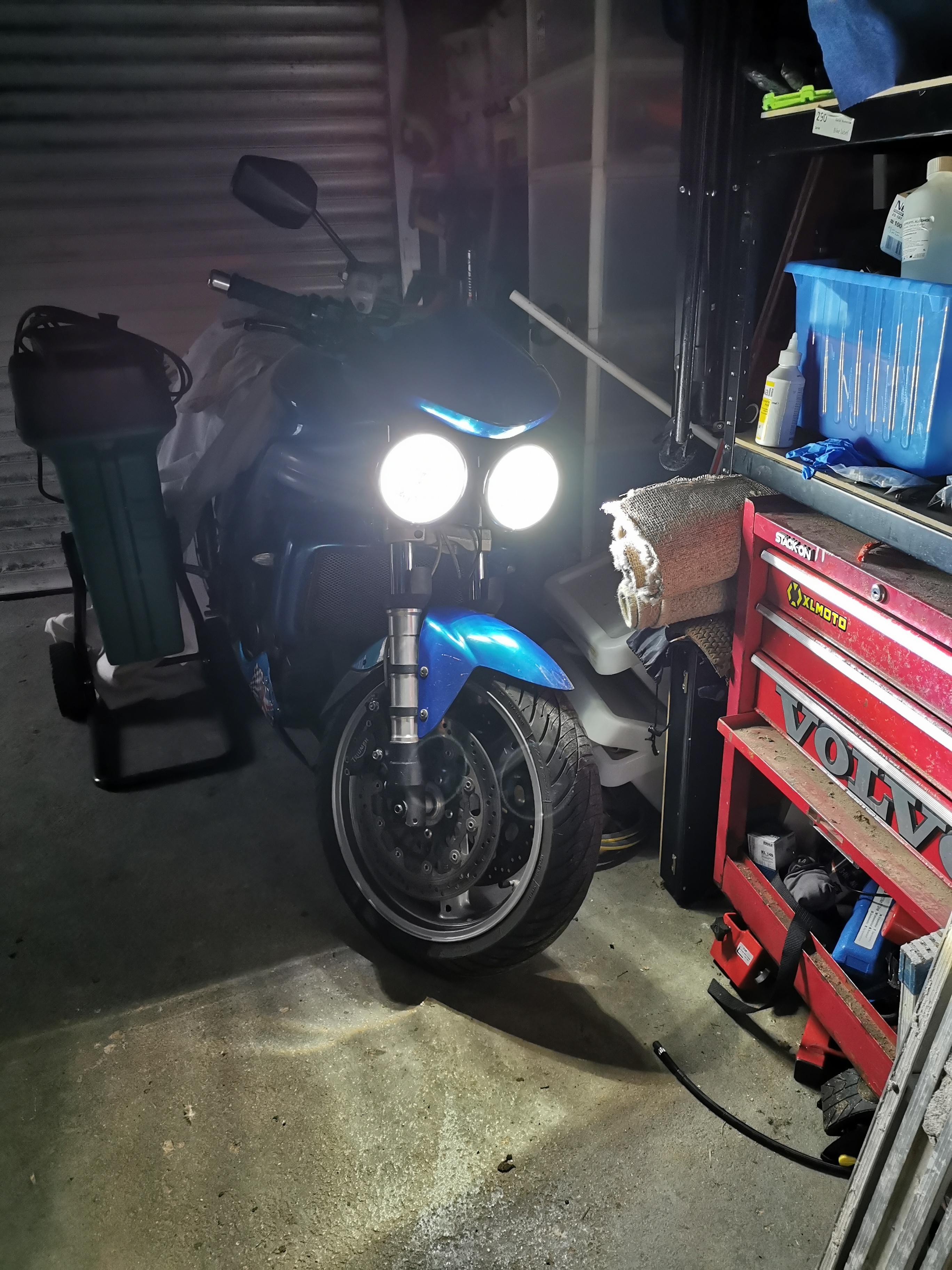

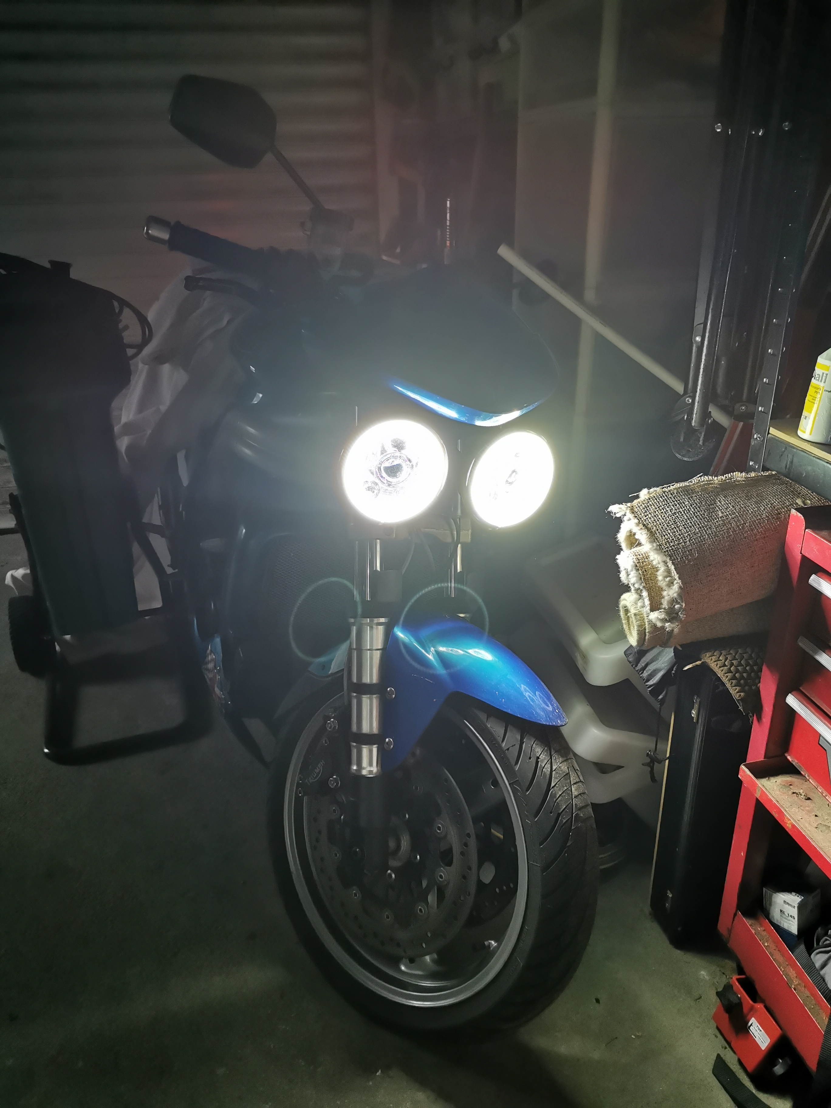

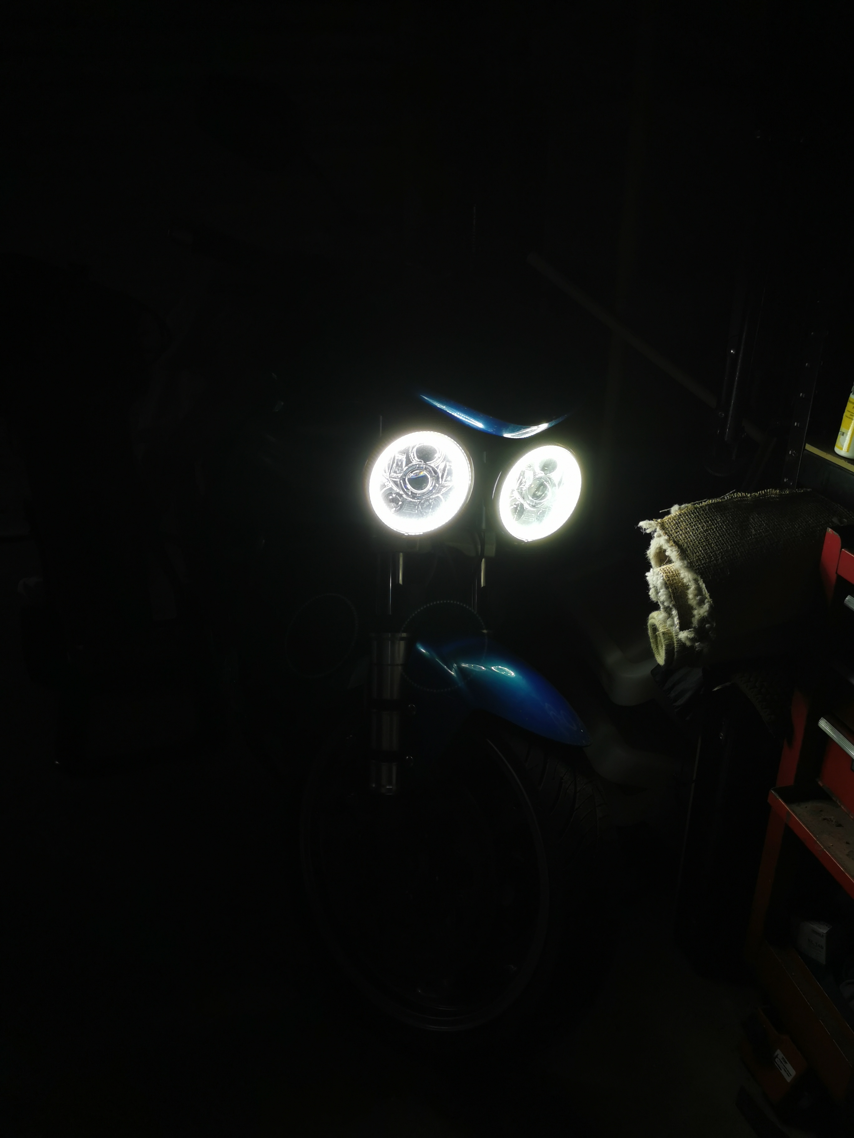

    Hiya, I bought these wisamics (https://www.amazon.co.uk/dp/B07G972T2M/ref=cm_sw_r_cp_awdb_imm_1EFZQSHXNTY0M0XWVE3D?psc=1) for my 2002 Speed Triple - in blue as that's the best colour :p - and i am very happy with them.
    I do not have massively high standards. But on the whole they are great. I have the 'halo' ones. I found them easy to fit, and although a slight squeeze they fitted in the original housing ok. The connections were easy and morealess plug'n play.
    I have run them (on the side light) which is the outer halo only and are excellent daytime running lights and perfectly good headlights in urban areas. I can only imagine what the dipped headlight will be like...and goodness only knows what full beam will do!
    I have had no issues with heat.
    I didn't realise, they are sold as singles, not doubles...bear that in mind if you have twin headlights!
    There was an issue elsewhere.on the forum about the MOT compliance for LED upgrades. My understanding from that thread is that these are all ok - but always keep originals anyway.
    So...if a thumbs up from an eager, non technical, keen but not overly zealous biker is useful...then I recommend the wisamics.

    Well as I expected. It didn't fit lol.
    The lights state 7inch but they come just a tad smaller than that meaning the outer housing ring on the street cup does not hold the led light in place.
    It's a easy fix if I wanted to use it, I could get some rubber tubing and run it around the ring and that will secure everything.
    I don't think I would of used this particular led headlight even if it did fit, as I plugged it in to see how the light looks, the beam pattern is a complete mess and doubt it would pass a MOT.
    So for now it's back to standard and will probably opt for a led bulb when the bulb needs replacing.
