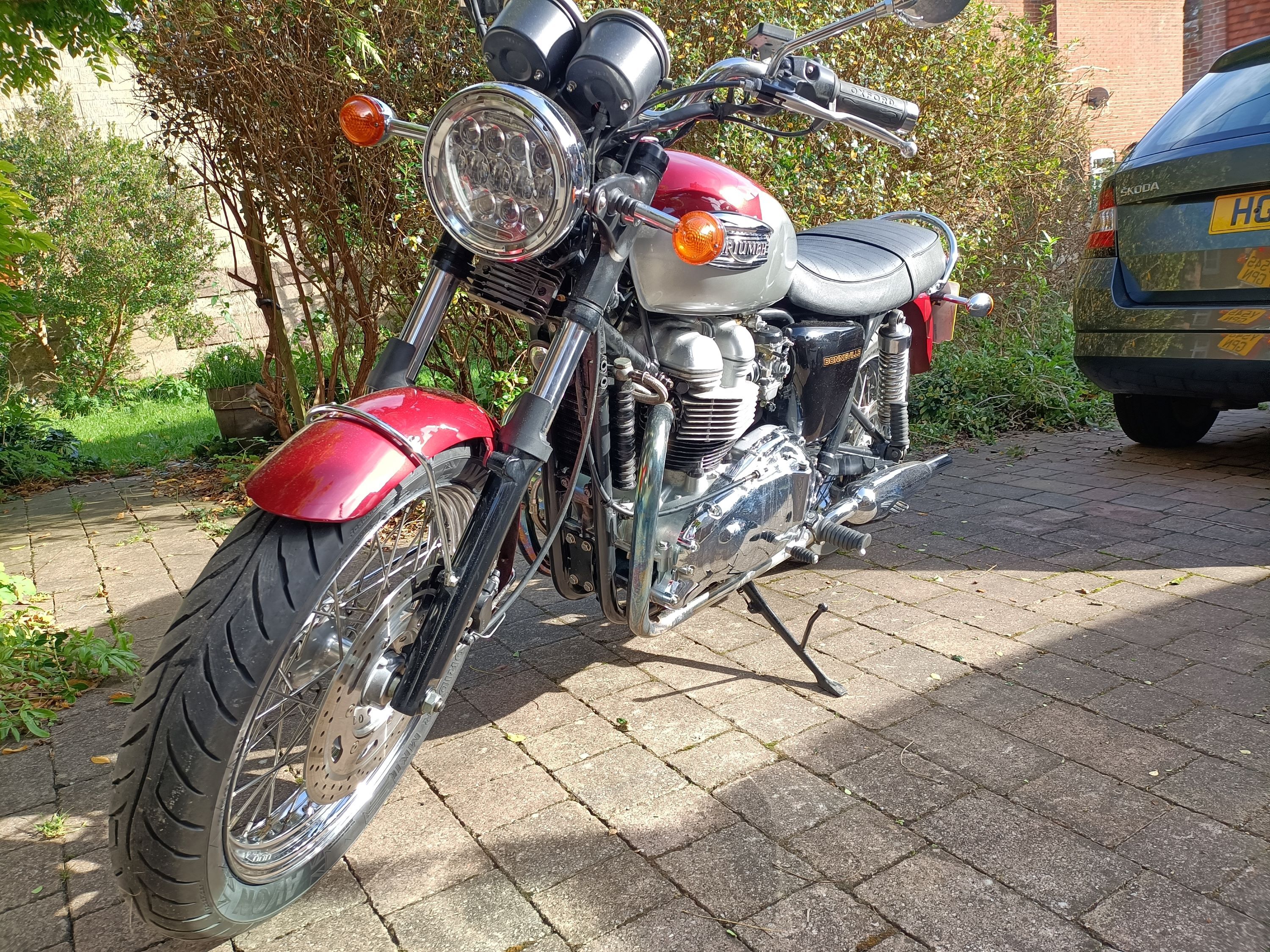

    The bike that I have just bought has a very good LED headlight, it gives a very good light, however I aim to return the bike to original spec and replace it with an OEM headlight, problem is that I can't find one.
    If anyone has one in the loft that they would like to sell (or swap) please let me know,
    Thanks Tim
