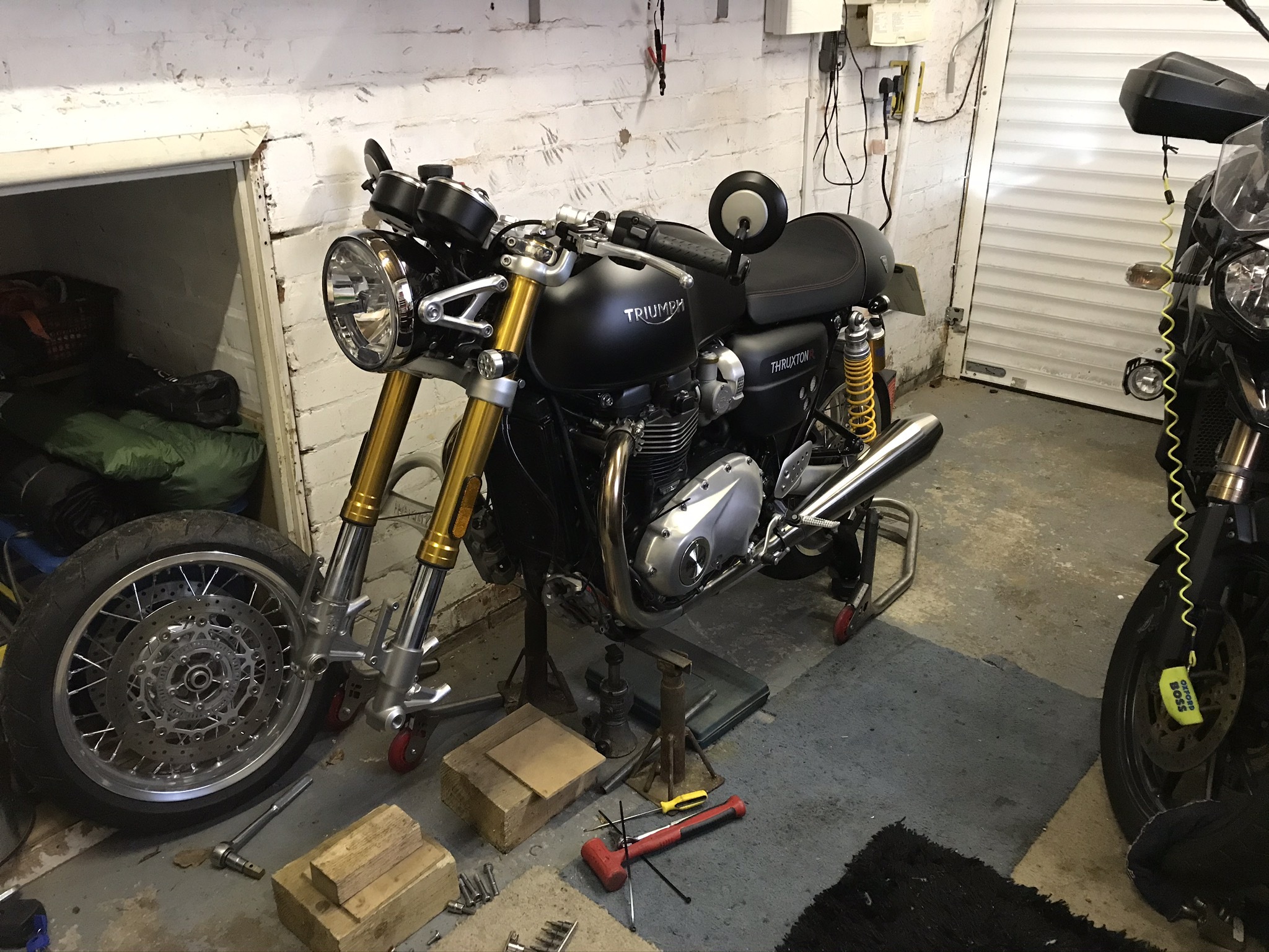

    When I bought the Thruxton I already had an ABBA stand for my VTR so made some adaptors to suit. Used in conjunction with a bottle jack and a piece of wood it makes a very stable lift that is great for long jobs where the bike has to be in the air for a few days.
    Recently treated myself to a cheap hydraulic lift as I plan to pull the swing arm out. I am not totally confident about the stability when raised but it is certainly convenient.

    I use jack and a a bit of two-by-four under the engine cradle and if I need extra stability lower that onto a few bricks. Together with a rear paddock stand that lets me get either wheel off. However, when I needed to get rear suspension out, needed to buy a front paddock stand as well....
    (Rear stand above is just taking weight of dangling swingarm)
