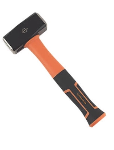

    The above is the universal adjustment tool for anything non electrical.

    I would like to state that no percussive tuning was required in the removal of the aforementioned system* :mad::p
    And I did have to put the replacement downpipes and Tors cans on, which was just as easy ;)
    *mainly because I wanted to be able to sell it afterwards....:D
