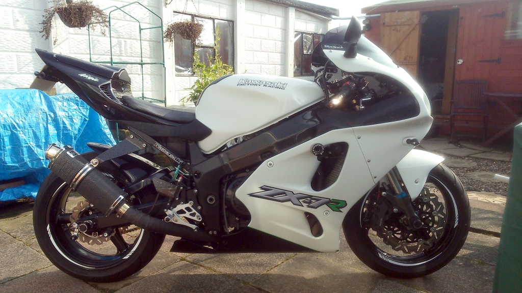

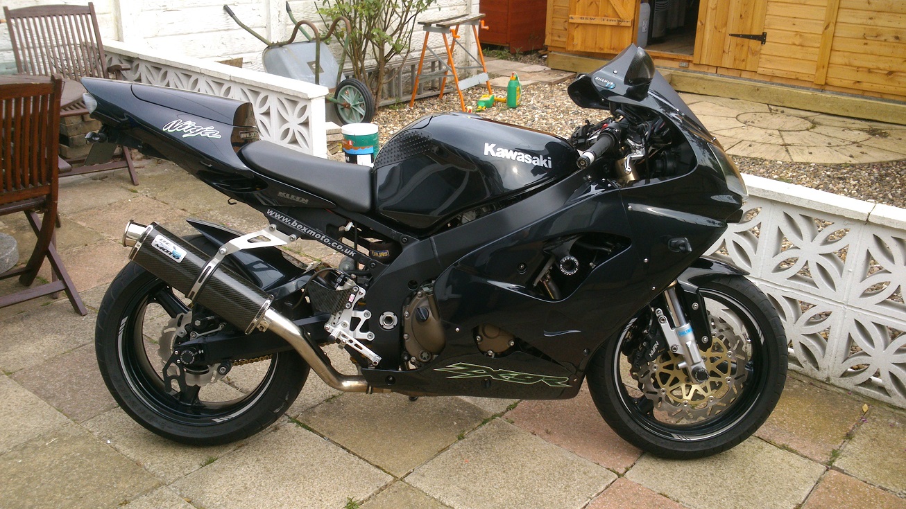

    After years on Kawasaki Ninja 4's I'm really starting to get into my recently acquired Speed triple. I was happy when I picked it up but realised that some personalisation and maintenance would improve it. It doesn't and never will have the shear "shove" of my 9R and 7/9R but the power is more than adequate and the torque is more than enough. I've checked the ECU map with the Tuneecu software and found it was the correct map for the high level TOR can. The fuelling wasn't perfect but after balancing the throttle bodies it is now seamless from idle to redline at all throttle openings. Whilst doing this I replaced the plastic fuel couplers in the tank.
