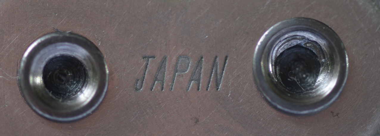

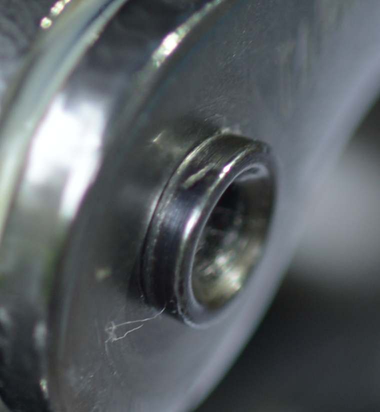

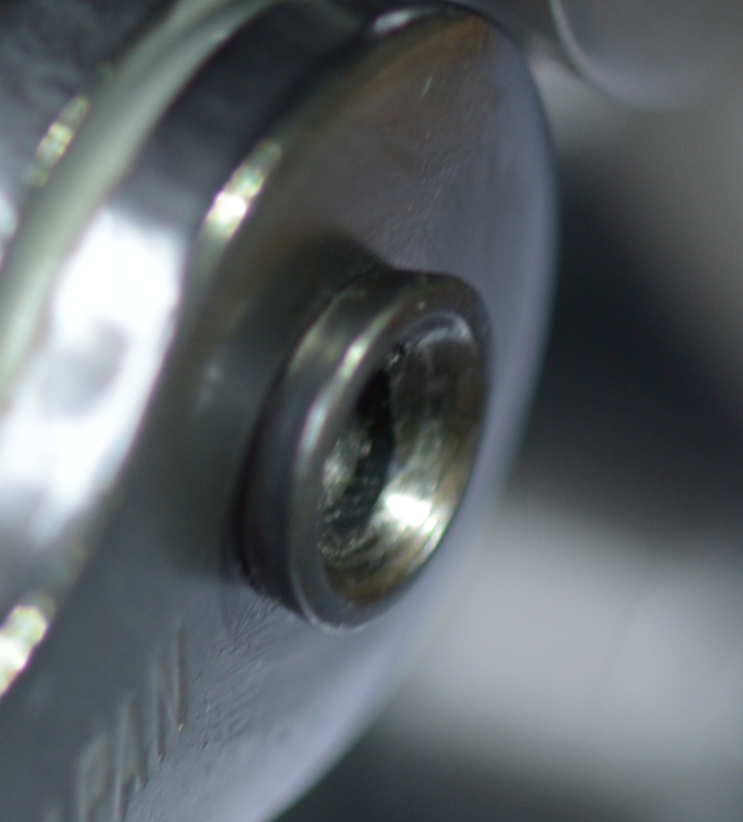

    After quite a bit of hassle with hard rivets and soft tools, I've managed to riveted a new chain together. In the process I ended up splaying the heads a bit more than strictly necessary but they look fine and uncracked to me, so I'm happy that they're safe. However, I wanted to get a second opinion from someone as this is my first time doing this. (The one on the right is a little chewed on the inside due to the tool head getting chewed.)

    Look fine to me...dont forget that the force on a chain is not lateral its all longitudinal so the rivets themselves only have to cope with minimal force that's why you can use river clips.

    Thanks. Yes, I realise about lateral forces being minimal. Putting the side-plates on required about 50nm torque turning the tool, and I was half wondering when doing that if riveting was even required. ;)

    The more important bit is the clearance between sideplates and does the link move freely...
    Splaying the rivets is obviously important but not that difficult to do as long as you don't overdo it and tighten the clearance up on the side plates.
    I do mine with a Whale chain tool using a 5lb club hammer for finesse, as long as it's peened over it'll be fine :D

    That's fine, well, side plates 0.1mm too close, but that still leaves the tips of the X ring still well separated.
    Perhaps if you use a hammer, I've spent 3 days and chewed up two riveting tools! Still, I've learnt my lesson, not doing that again.

    I used to be splitting my chain most weekends when racing to change gearing, essentially as long as the link moves freely and the rivet is peened, it'll be good - 600hp tends to show up any weak links ;)

    you need to measure both with a caliper to make sure both the same and not over tightened
