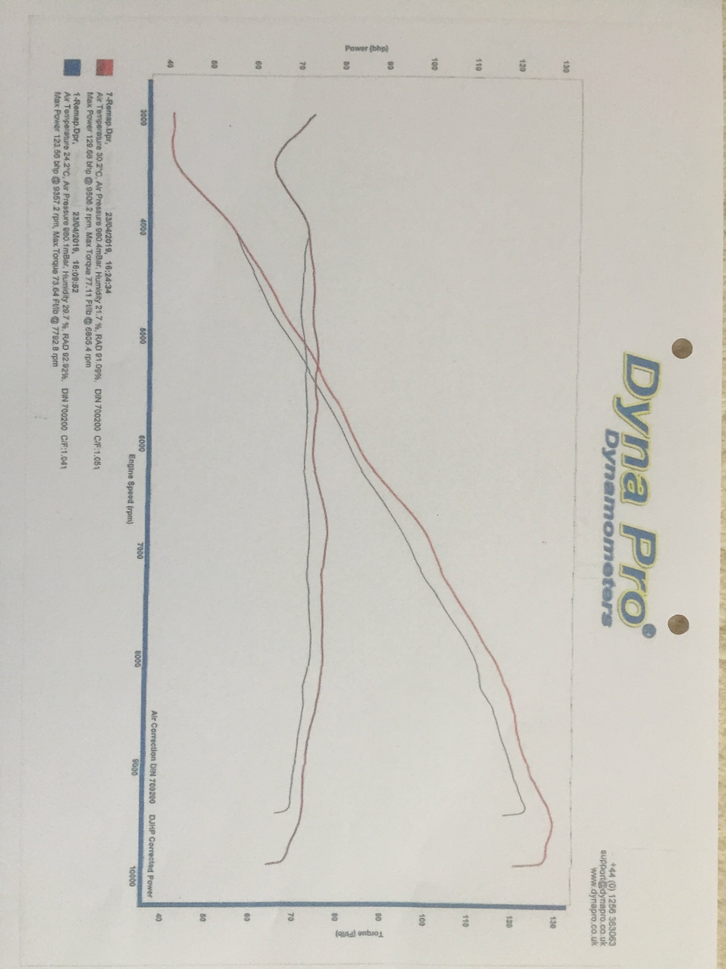

    I've been wrestling with the "Hilltop vs Other" question too.
    I like Tune ECU because:-
    You can load / unload maps yourself.
    You can see what the maps look like.
    You can set the throttle bodies and do diagnostics and maintenance etc.
    With Hilltop its all a blank. No idea whats going on.
    If I understand it correctly once done its there for life? ie you can't undo it and revert to std without going back? Is that right?
    Anyway due to the transparency of Tune ECU and the "black box" approach of Hilltop, I finally bit the bullet and went with a custom tune via Tune ECU applied by a reputable tuner, (who shall remain nameless just for now).
    I attached the dyno print for info.
    (The bike's a Speed triple with K&N and Arrow Lowboy btw)
    If I am reading this printout correctly??
    The Triumph stock tune for speed triple with low boy, 20524, was very good?
    and the new Custom tune is a slight improvement?
    I was told the max revs were increased from 9450 to 9900 rpm which partially explains why my new max 129 bhp was at 9500 rpm whereas the previous max of 123 bhp was at 9300 rpm, so I appreciated the honesty of the tuner on this point, as anyone will get a bigger max number if the revs are increased.
    I clearly have gained a bit of torque mid range up from 73 ft/lb @ 7800rpm to 77 ft/lb @ 6800rpm which is at 1000rpm lower than before!
    (This is good right?)
    Did a quick squirt this afters to try it and it feels great.
    (Was OK before mind).
    Compared the new map with the previous one on Tune ECU and there are clear differences so I am confident I have got a true custom map.
    Need to do some miles to get a better feel for it, but would appreciate any comments on what this printout really means as its all new to me.
    Cheers
    Taff

    Looks like a well worthwhile improvement if both taken on same dyno on same day. Increasing max RPM may be risky as the load on piston rods etc. goes up a lot with engine speed but I guess you are not going to spend must time at 9900 rpm.. Its good if you have options. With the later bikes you cannot do the ECU upload/changes so its either PowerCommander or Hilltop... looks a good result anyway :)

    I am no expert in all this ecu mapping malarkey but I sort of can read a graph.
    I think the 2014 map I had was pretty good as the torque was even and the bop was steady across the rev range so the dyno reinforced my feeling that the bike was fairly good already. The custom map has not changed anything significantly but it has been upped a tad which is fine.
    Apparently the 1050 triple is well over engineered so the increase from max 9450 to 9900 is probably no problem. The beauty of tune ecu is I can easily reduce it myself if I can’t trust my right hand.
    At this stage (no experience of any mileage) I feel quite pleased.
    All this came about after test riding a new speed triple rs.
    The torque of that was quite something but the cost of trading the 2014 was astronomical and an engineering tune would have got the same / more for a much lower price plus I would still retain “user interference”.
    I’m sticking with what I’ve got.
    Love the Speed Triple and love fiddling with it.
    Taff

  15. Taff
    Taff Member
    Nov 27, 2018
    31
    Cymru
    I wish I understood what Hilltop actually does.
    At least I can see it on tune ecu although I don’t understand it!
  16. Taff
    Taff Member
    Nov 27, 2018
    31
    Cymru
    The new speed triple RS did feel like I was one gear down on the 2014 R, so you could be onto something there.
    Triumph claim 150bhp for the new RS and 130bhp for the old R and I really thought I could feel that difference on the test ride, which started me off on this tuning business, so I don’t think it is just gearing.
    The dyno does show I can just about scrape 130bhp flat chat which is ample for road use.
    Anyway I’m keeping my old bike. The difference was not enough to justify the cost and the locked ecu etc closes the door for me. If I needed 150+ bhp I could get it and more with a head skim and new cams for a fraction of the cost of a new RS but I’ll never use it so I’m sticking with the 2014 R for the time being. It’s one of those “keepers” if you know what I mean? It intoxicates me and I can’t give it up!
    Taff

    Looking at your graphs and riding it between 7000 and 8500 should give a very rewarding ride.
    Do you really need to race it to the red line?
    A good improvement across the board there and I'd be happy if it were mine.

    I’m no expert but the newer bikes certainly seem to benefit significantly in the lower rev range. Mine was ok already so I’m pleased to know it was alright before the custom map and is even better now.
    Took it for a squirt over the Brecon Beacons this morning and it rides beautifully.
    Well pleased.
    I didn’t say who tuned it earlier as I wanted to be sure I was happy with it.
    Well now I am well chuffed I can recommend T3-Racing.
    Taff

    Am I correct in thinking the triumph tune (blue) is pretty much as good as the new custom tune (red)???
    Just to be clear I’m pleased with the dyno print either way, since I did not know before I had the bike dyno’d whether it was ok or not, so I have no issue with the tuner.
    I wanted to know where I was before and after and now I think I was ok before the custom tune.
    Which would you go for?
    The blue line (factory) or the red line (custom)?
    As far as I can tell the bike runs tip top either way.
    I have noticed the O2 sensor is on with the Triumph tune and off with the custom tune.
    Does it matter??
    Cheers
    Taff

    Thanks Little Ade.
    Bike certainly rides well.
    I was curious whether to switch the O2 sensor back on or not?
    I suppose it was disabled deliberately so will leave it switched off.
    This thread was all about “Hilltop vs Other.”
    This is why I prefer “Other”
    I can change it at will.
    If I had gone with Hilltop the change would have been permanent and irreversible.
    (I supposed Geoff would reverse it on request?)
    Pleased I did this now as I can see where I am. I can compare tunes on tune ecu and see precisely which values are different too, although I won’t be dabbling with any of these values myself.
    Taff.
