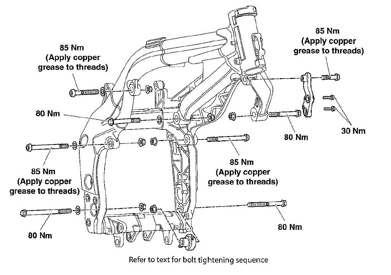

    I would loosen and re-torque all the engine mounting bolts to specification. Vibrating at standstill is a powerful clue it is not related to the wheels or suspension.

    do you know where I can find the correct torque for this model?

    You may need a workshop manual as the order in which you tighten is as important as the Newton metre value for each bolt.
    Haynes online? https://haynes.com/en-gb/search?query=Tiger Sport
    The newer bike has the same chassis....?
    Otherwise your dealer can supply a genuine Triumph manual.

  12. sprintdave
    May 25, 2014
    1,501
    Birmingham
    I believe you need to tighten them in a certain sequence as in last post. Seen this problem before somewhere

    Yes need to torque the bolts. And like someone said play with the bar end weights. I find on the old Bonnies when I dismantle bits I put them back with some silicon sealant helps vibes. Also try a rubber washer under the bars and headlamp bolts. Hope you get it sorted. And welcome to The Family.

    someone has the procedure/sequence to tighten the engine bars? (I can't find it)
