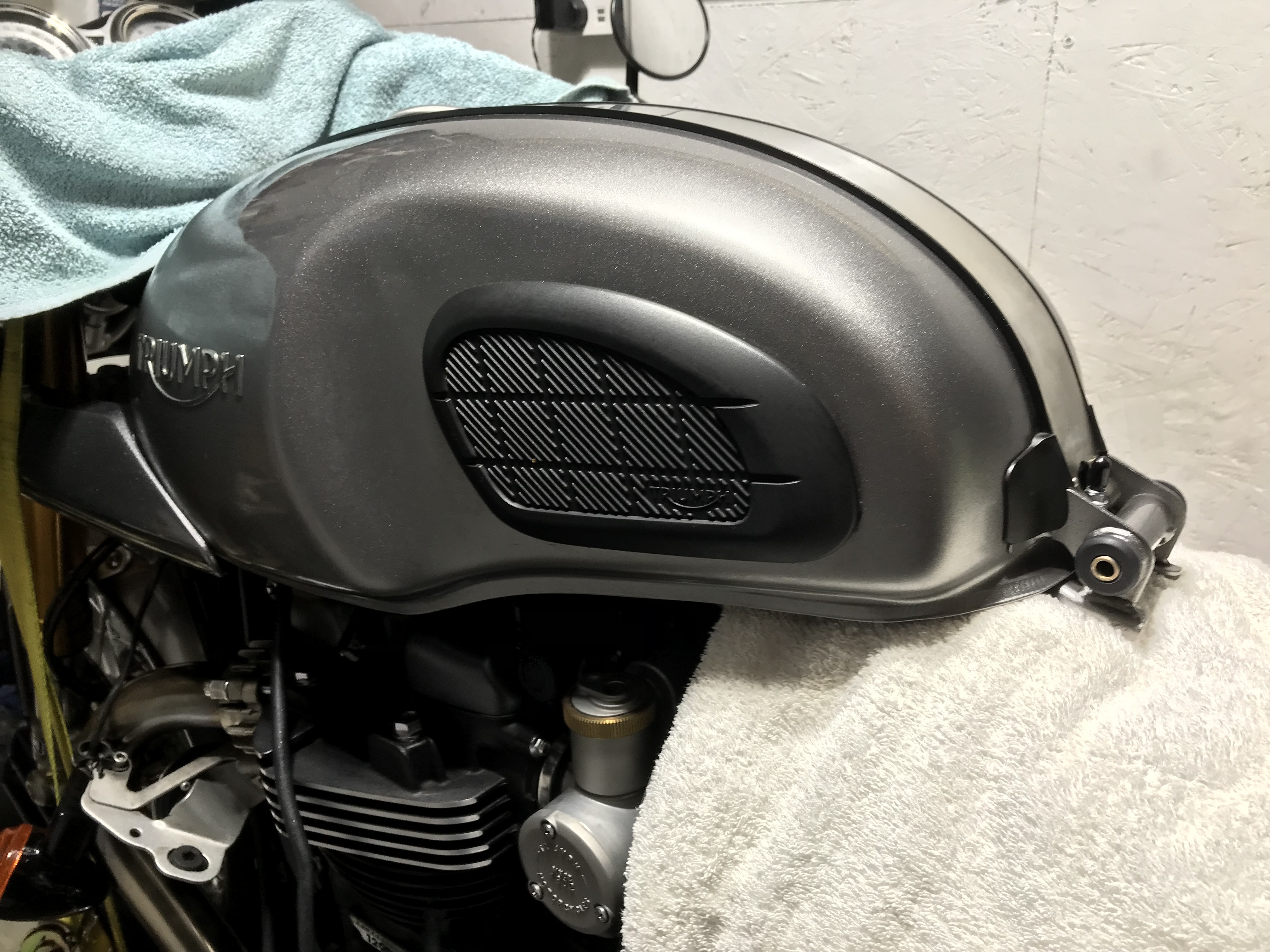

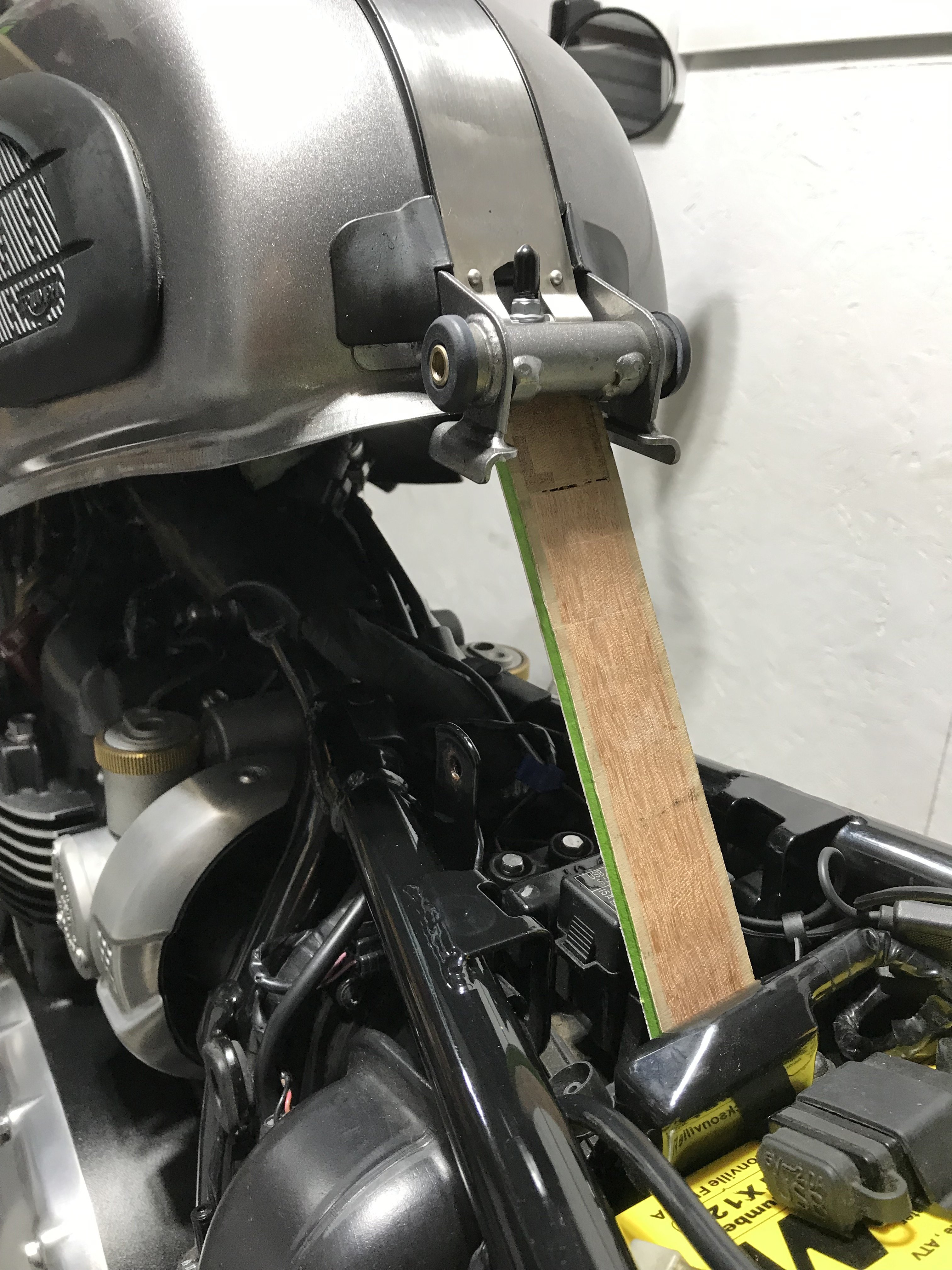

    2.Cloths positioned to protect the tank during removal & replacement. The tank is fixed to the frame by one horizontal bolt and nut at the rear (Seat removed) and located on 2 rubber mounts, either side of the top frame spine at the front. The front indicators are each fastened to the underside of the petrol tank with 2 screws. The sides of the fairing are pushed onto rubber grommets in the indicator brackets so these were also pulled apart and the indicators moved out of the way. The petrol tank can be eased back on its rubber mounts then lifted and propped up at the rear. In this position the 2 electrical connections and 1 fuel hose connection can be undone.

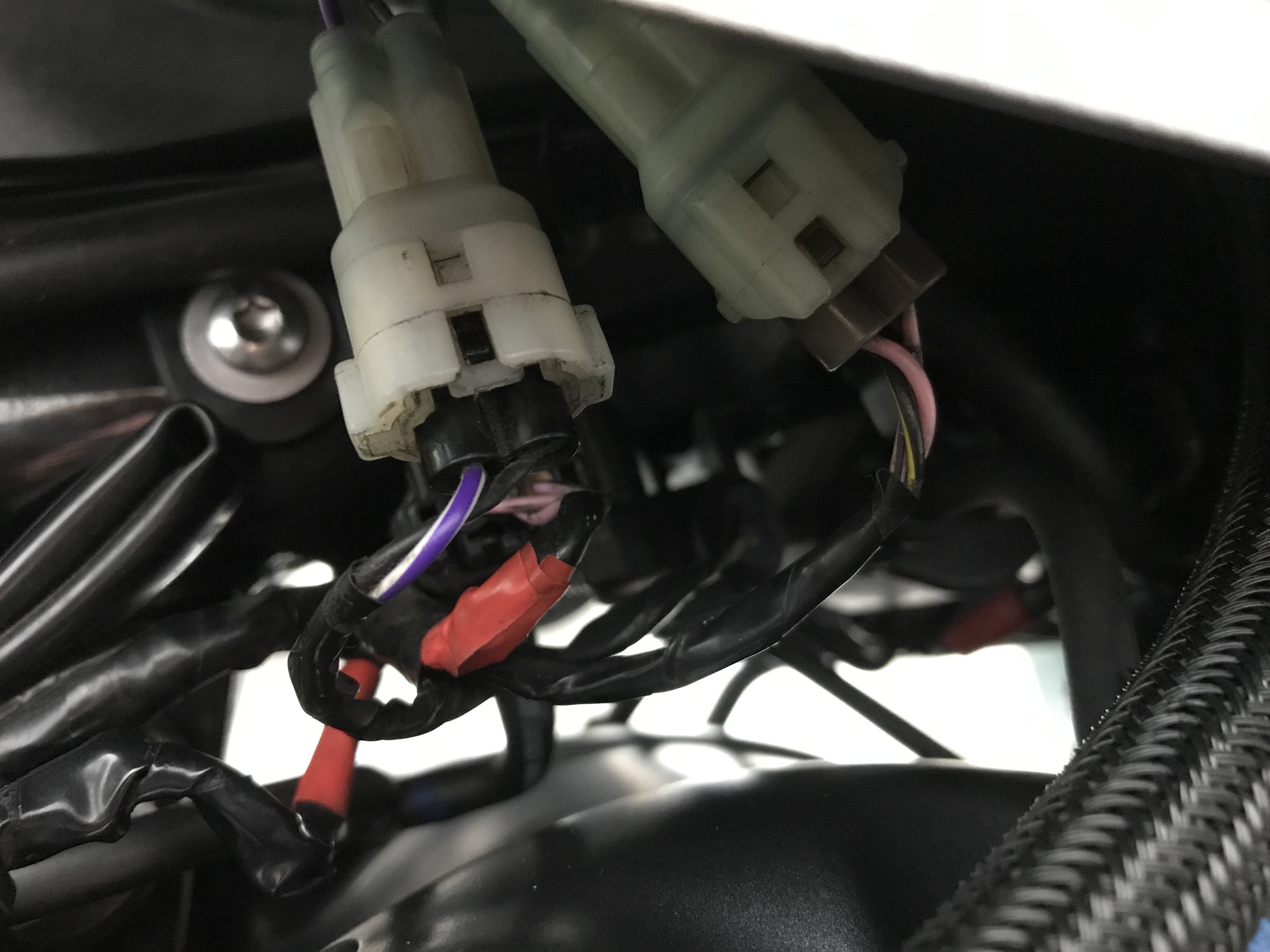

    4.The two electrical connectors are released from small brackets by pushing them upwards.
    5.To unplug each one use a small screwdriver to push in the tiny catch, at the front, then pull apart. The 2 connectors are different and will not fit back together if you mix them up.

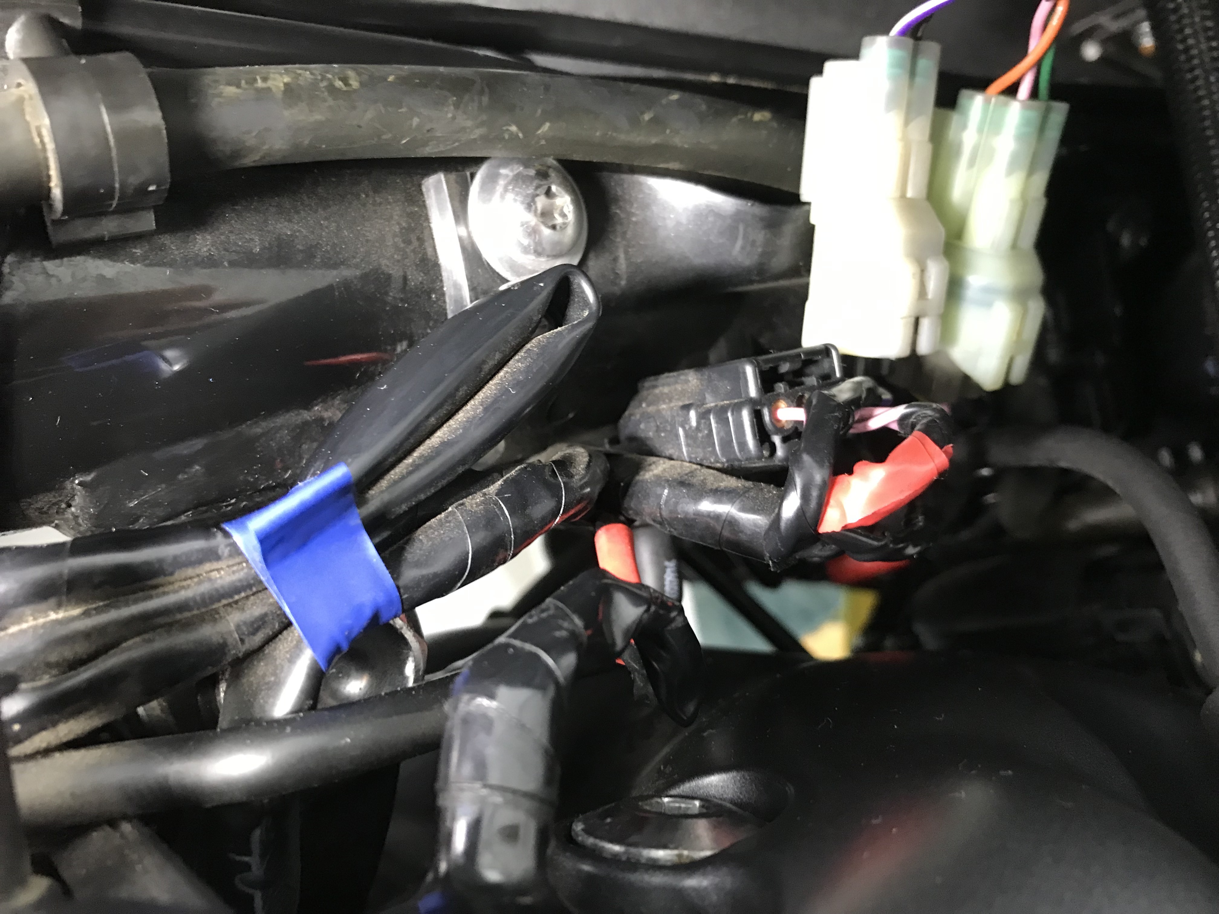

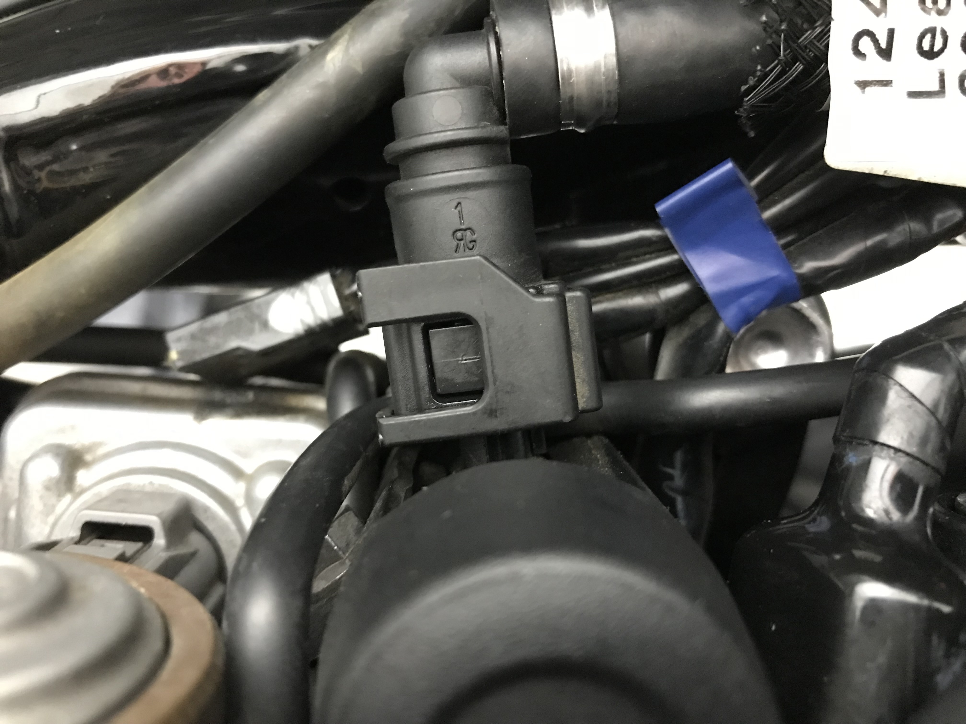

    6. The fuel hose proved to be awkward. The clip (backwards facing C shape) must be pulled towards the right (blue tape) as shown in this photo, which gives access to the square buttons, front and rear. Using thumb & finger both buttons need pushing in (guitar playing fingers) before pulling the complete hose & connection up and off. The hose incorporates a self-closing valve so there should be no more than a drip or two of petrol but have some rag handy. Reverse process for reinstallation but keep those buttons pressed in until the connector is pushed fully down. The clip will not slide back into position and, more importantly, the connection will not be secure unless it is correctly pushed home.
    7.The photo shows the connection and clip in its fully fitted position.

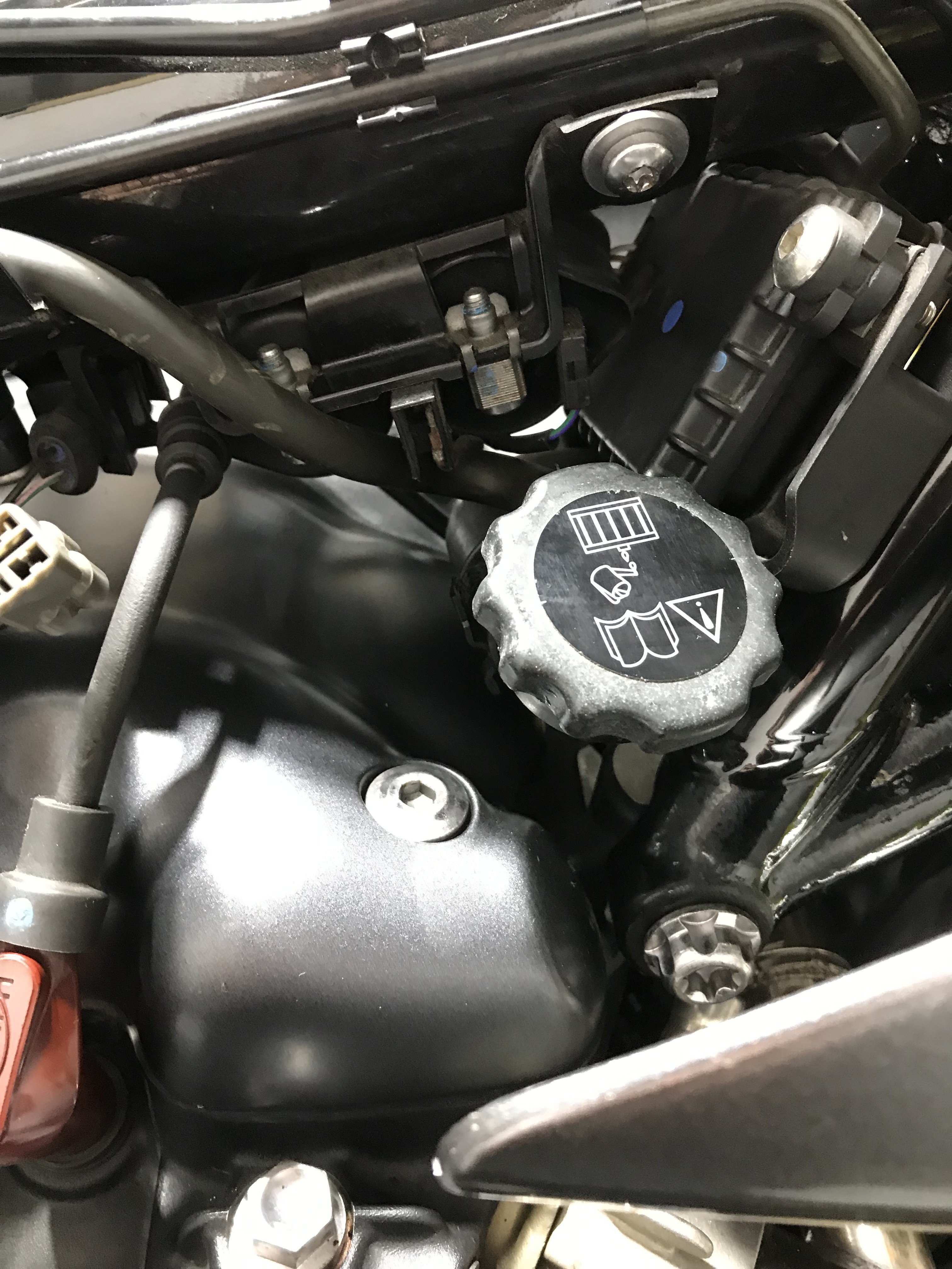

    8. With the disconnecting work completed, prop is removed and the tank held almost horizontal while pulling it gently back of it's rubber mounts. Put it somewhere so you don't kick it or drop spanners on it. The radiator cap is revealed. With the bottom hose disconnected I flushed water through the radiator several times.

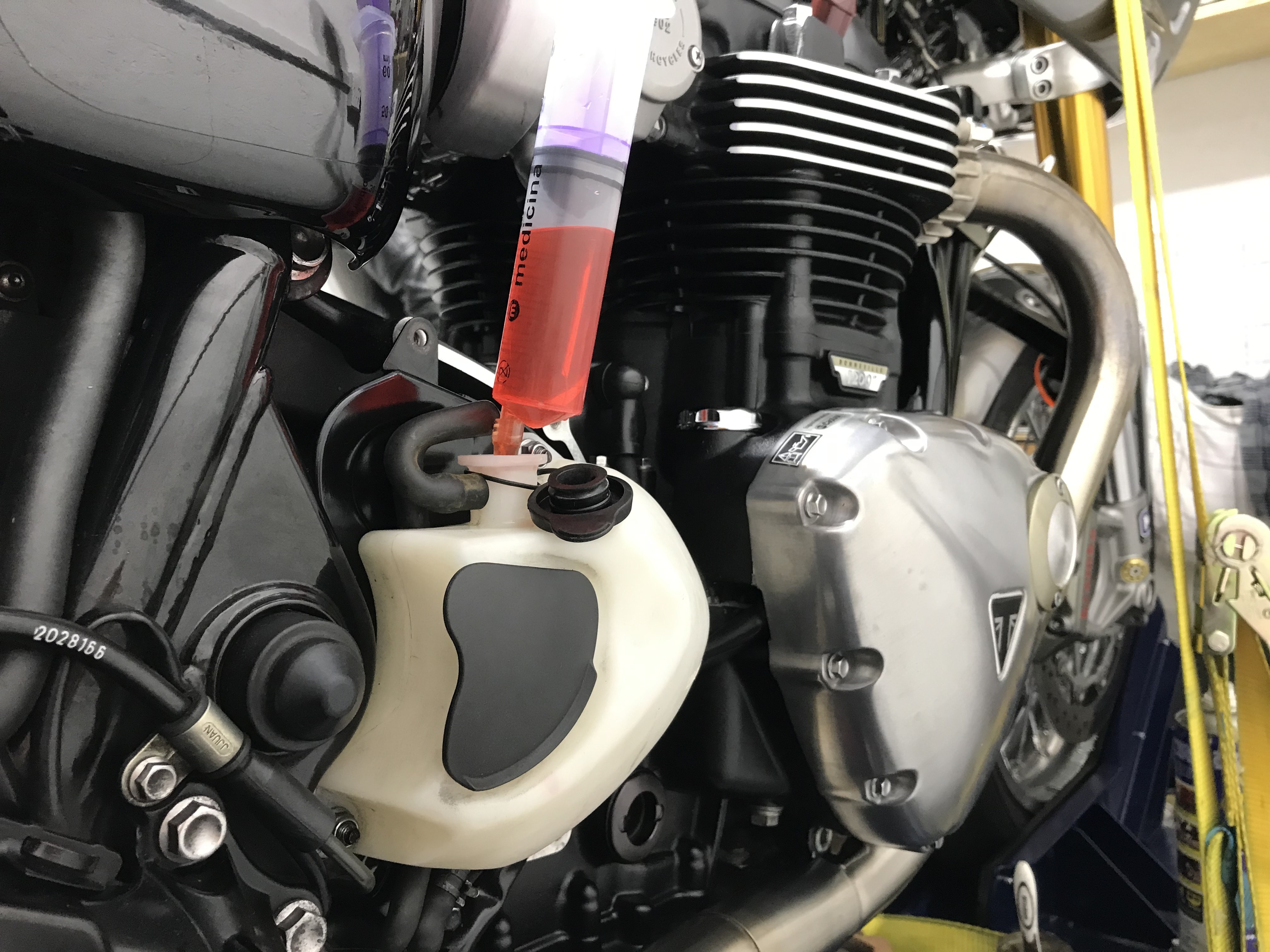

    9. 4 screws to remove the alloy cover of the expansion tank. I used a syringe to empty it. 2 nuts hold the expansion tank in place but you only need to remove it to wash it out. The breather hose can be left connected at the top but look for where it is routed behind the lower frame rail. The bottom hose will need to be disconnected to remove the tank and it has a clip.

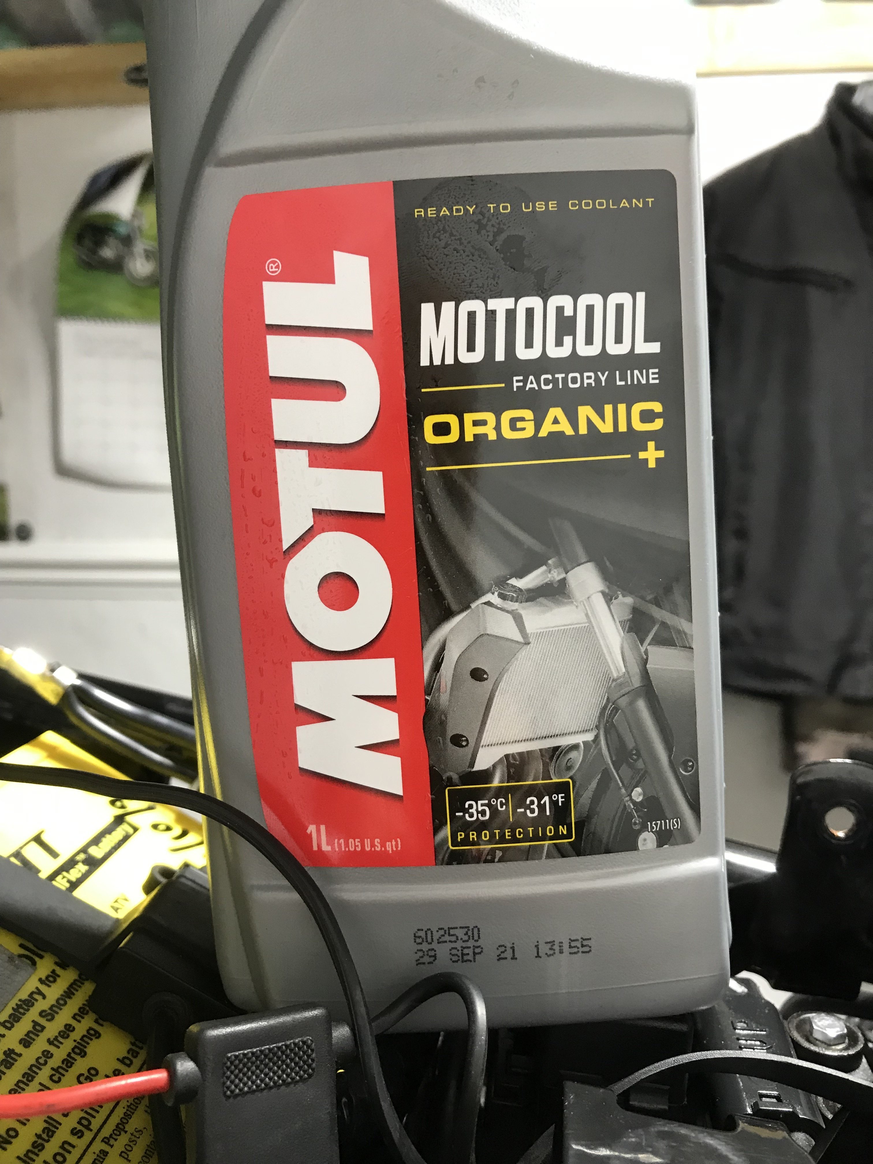

    10. My coolant of choice.
    11. I used the syringe to fill the radiator and also to the correct level in the expansion tank. The radiator must be be filled slowly to prevent air locks. It is also recommended to lift the rear of the bike to position the radiator filler as high as possible relative to the rest of the system. Using the syringe avoided spillage and kept things slow and steady, with lots of squeezing of the bottom hose ( which you remembered to re-attach) at regular intervals. Don't forget to put the radiator cap back on.
    12. Even with brightly coloured coolant, checking the expansion tank level without removing the cover requires a special kind of eyesight. After the first ride I will remove the petrol tank and check the radiator level.
