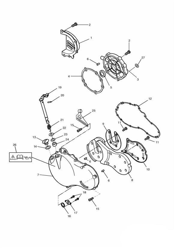

    I recently performed and now the clutch won't disengage (when putting the bike into gear it jumps and stalls). I have tried to get it unstuck with some simple tricks I found on YouTube but nothing worked. I tore the bike down again, picked the clutch plates off and put them in an oil bath, making sure every plate got coated well. I later assembled it back together and the clutch still doesn't work. I have gone trough the mechanic book several times and everything is fitted the right way. Any suggestions?

    If it's not disengaging the problem must be with the actual lifter shaft assembly surely??
  5. Sprinter
    6,029
    Are you loading the spring when you assemble part 19?

    Very good tips! The clutch feels and looks to be functioning properly! When I release the clutch lever it snaps back like it should. If I look down the oil filling hole I am able to see the clutch move...

    That is the logical conclusion. The problem is in the actuator.
    It sounds like the vertical rod is not engaged with the lifter pin. The clutch lever will operate under the resistance of the cable spring (albeit more easily) but the clutch will remain clamped by its own springs. Having it apart three times (we’ve all been there!) simply means repeating the same mistake/oversight......

    The steel plates may be slightly different thicknesses and not interchangeable and are the tabs on the outer plate offset to the rest? I am not familiar with your particular clutch but they are pretty similar.
