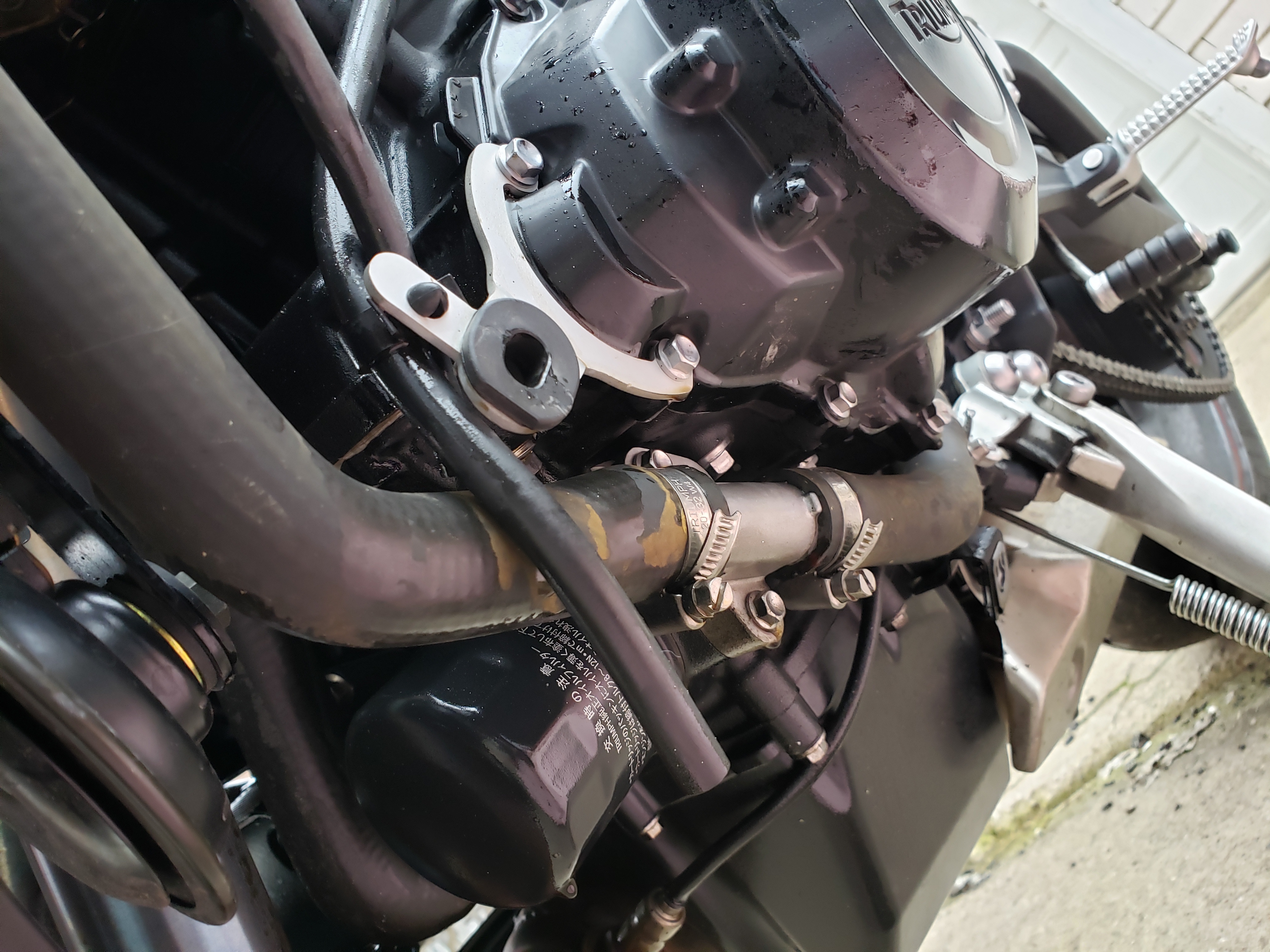

  10. YOsH
    YOsH Member
    Feb 2, 2019
    50
    Ohio
    Well, I took off my side fairing and judging from what I seen I won't be up and riding anytime soon... Take a look https://s.amsu.ng/woWD9Gdn19nN
    ....Welp there goes my brief and uneventful start and end with motorcycles. Bought my dream bike and rendered it useless in less than 2 months. Thanks everyone for the help, support and pointers.

  14. Eldon
    Eldon Elite Member
    6,155
    By the looks of the photos posted by DD it looks like serious, possible crank issue, but unfortunately it's taken the crank cases out.

  16. Eldon
    Eldon Elite Member
    6,155
    #16 Eldon, Mar 24, 2019
    The white smoke and oil everywhere is easy to explain; something let go, burst the casing and hot oil and/or coolant sprayed on the exhaust/hot bits and vaporized.
    The awkward bit is the "Red lining noise" even if the throttle stuck wide open the rev limiter should have saved the motor.
    I've seen a few cbr600 motors blow with oil and smoke everywhere but they were from crank oil starvation due to centrifugal forces. This caused a rod to drop and burst out.
    I'd certainly be interested to take a look inside to see what failed, pity your not in the UK.
    As DD said that sump gasket goo doesn't look factory so it would have been good to know what's gone on before.

    Whereabouts is the balance shaft on this motor?
  19. Tiglet
    I wonder if when the bike went down for the second time and on its right hand side if the engine was running for any length of time and by YOsH own admission of not be mechanically minded I wonder if the engine oil level was low also resulting in oil starvation of the left side of the crank.
    Could this have been the start of the problems.
    Then when giving it the berries,bang rod and crank go resulting in a cracked crankcase beside the internal damage.

  21. Callumity
    Callumity Elite Member
    Feb 25, 2017
    3,358
    Nr Biggar
    My working suspicion is that you have been sold a complete pup. The amount of silicone used to rebuild that engine tells me it was not the most expert mechanic and the bike was patched up to look the part and get rid......
    Candidly, I think you have been had by someone all too happy to sell out of State with no comeback. As others have said, you need a new motor......used but with a warranty of some sort.
