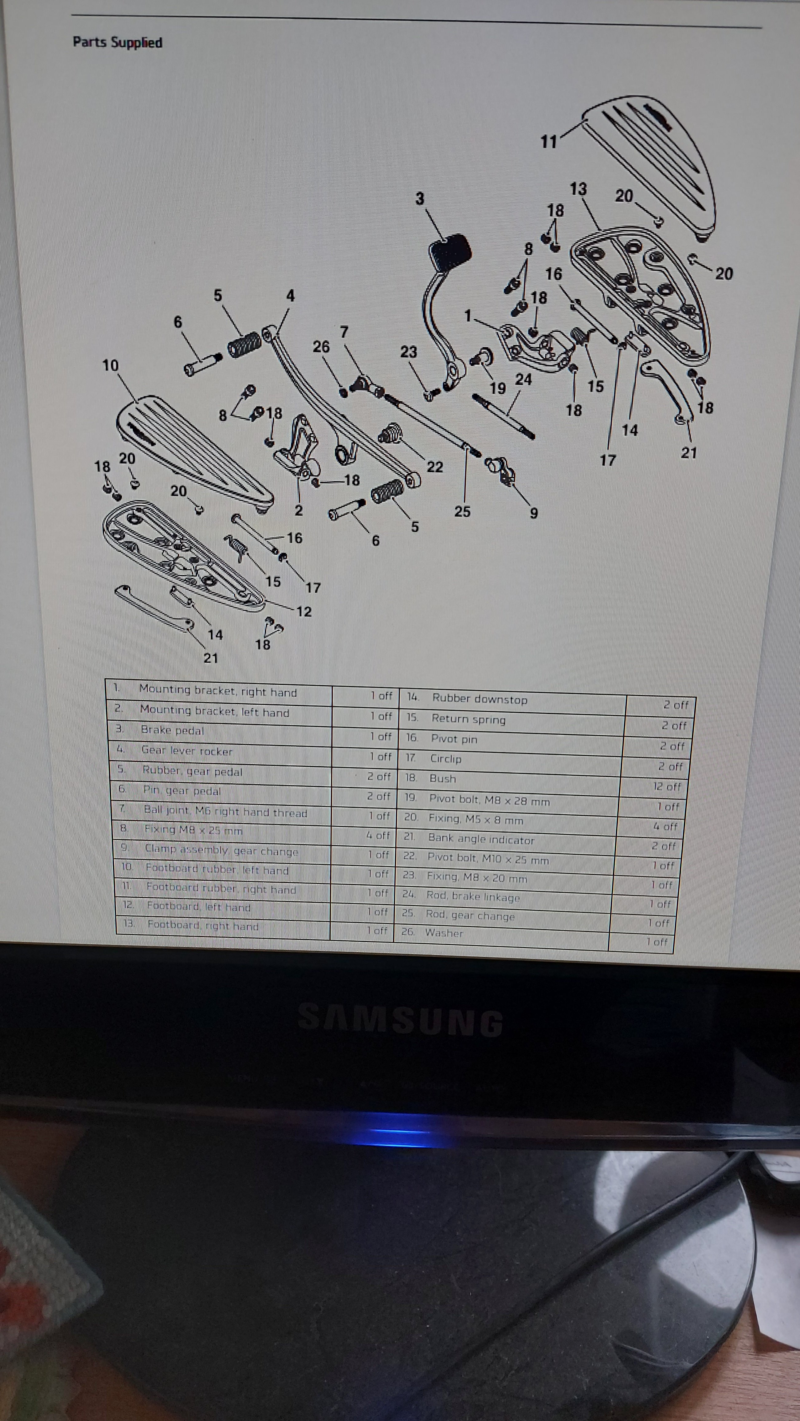

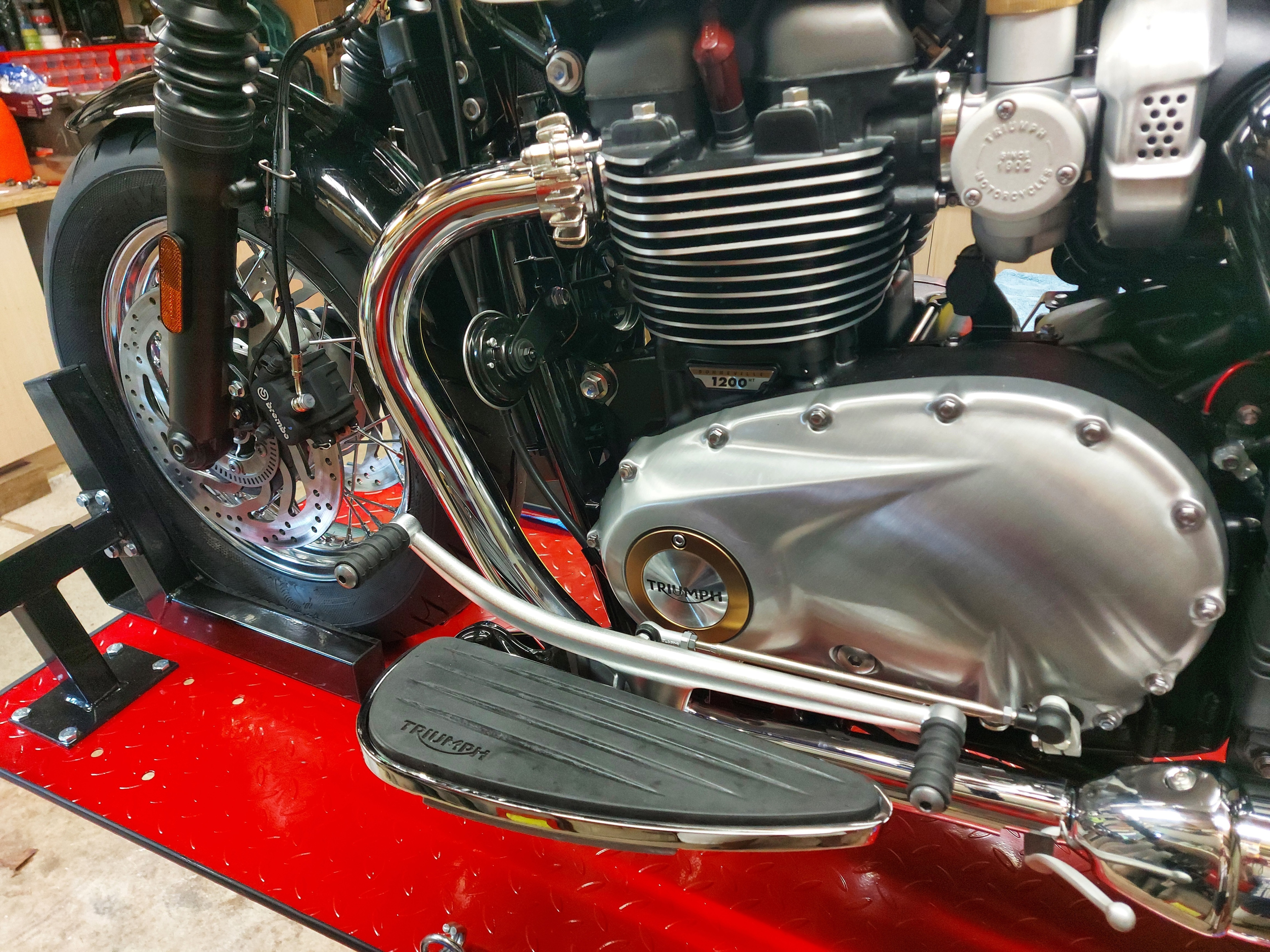

    There's a heal toe shifter that comes with the Triumph Footboard Kit (A9770117) so a Triumph part does exist...
  7. learningtofly
    Sep 25, 2018
    2,084
    Much appreciated, thank you. Will see how things progress but perhaps speak in the future.
  8. learningtofly
    Sep 25, 2018
    2,084
    Good to know, thanks, although this part is seemingly for forward controls only.
  9. CraigHew
    CraigHew Member
    Jul 25, 2021
    66
    Whitchurch, Shropshire
    The forward control heal/toe shifter connects to the gearbox spline by a rod. I'd guess the rod would be easier to adapt than a shifter casting?
