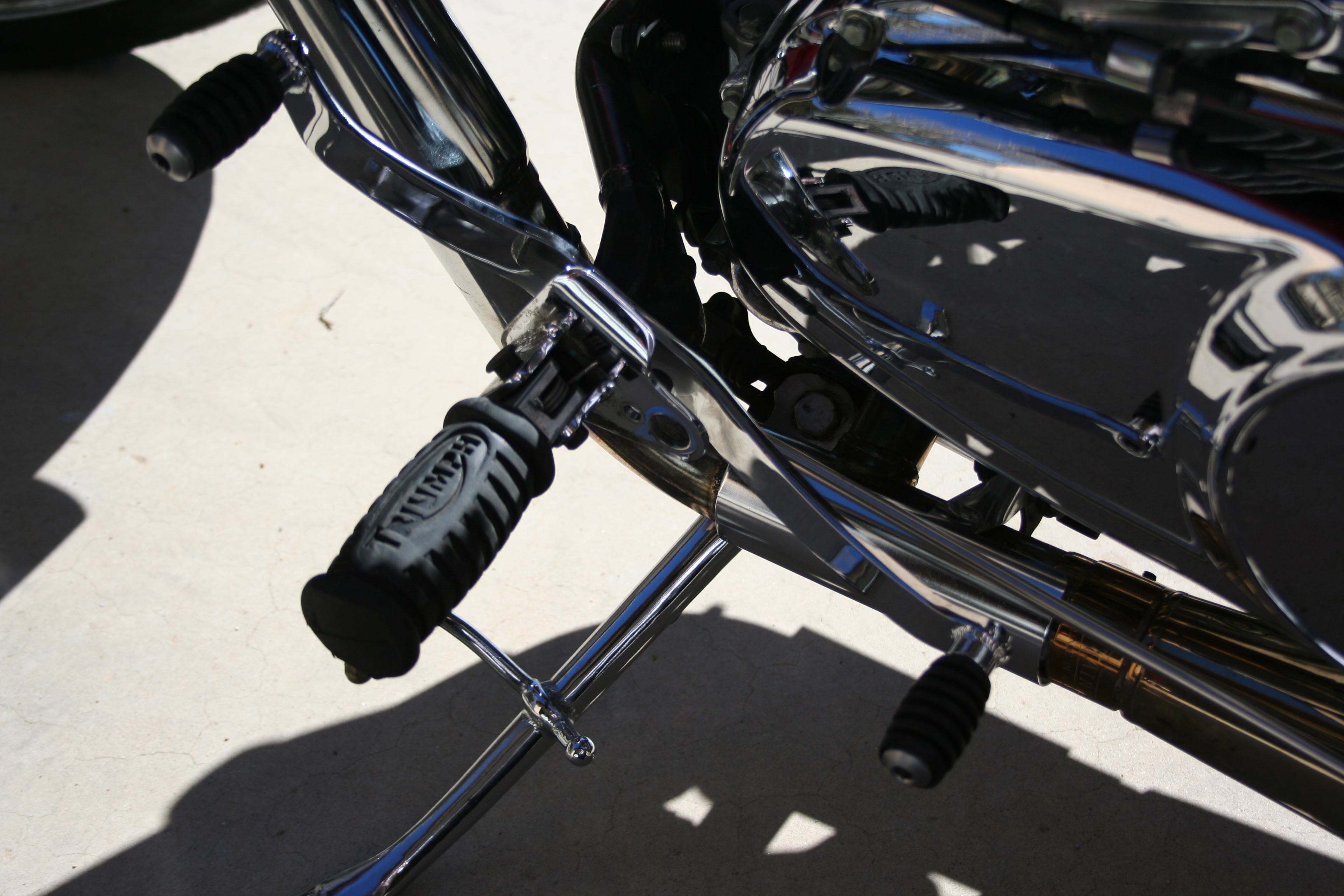

    Don't think you are going to find one for that bike. I don't know of any aftermaket shifters. Triumph made them for the later ones like the air cooled America/Speedmaster. This is mine. It is modified somewhat. The stop is removed from the footpeg and the shift rod has been lengthened so the rear peg sits a lot lower. 2002 America. ...J.D.

    Been looking for one for my Speedmaster too Punchy so interested if you find one and will share if I do

    The one above will fit the Speedmaster (air cooled). It is a factory accessory. There was one for the early (carburetted) version and a different part number for the EFI models. Do a word search for Triumph heel/toe on the internet and you should come up with one for your "Speedy". ...J.D.
