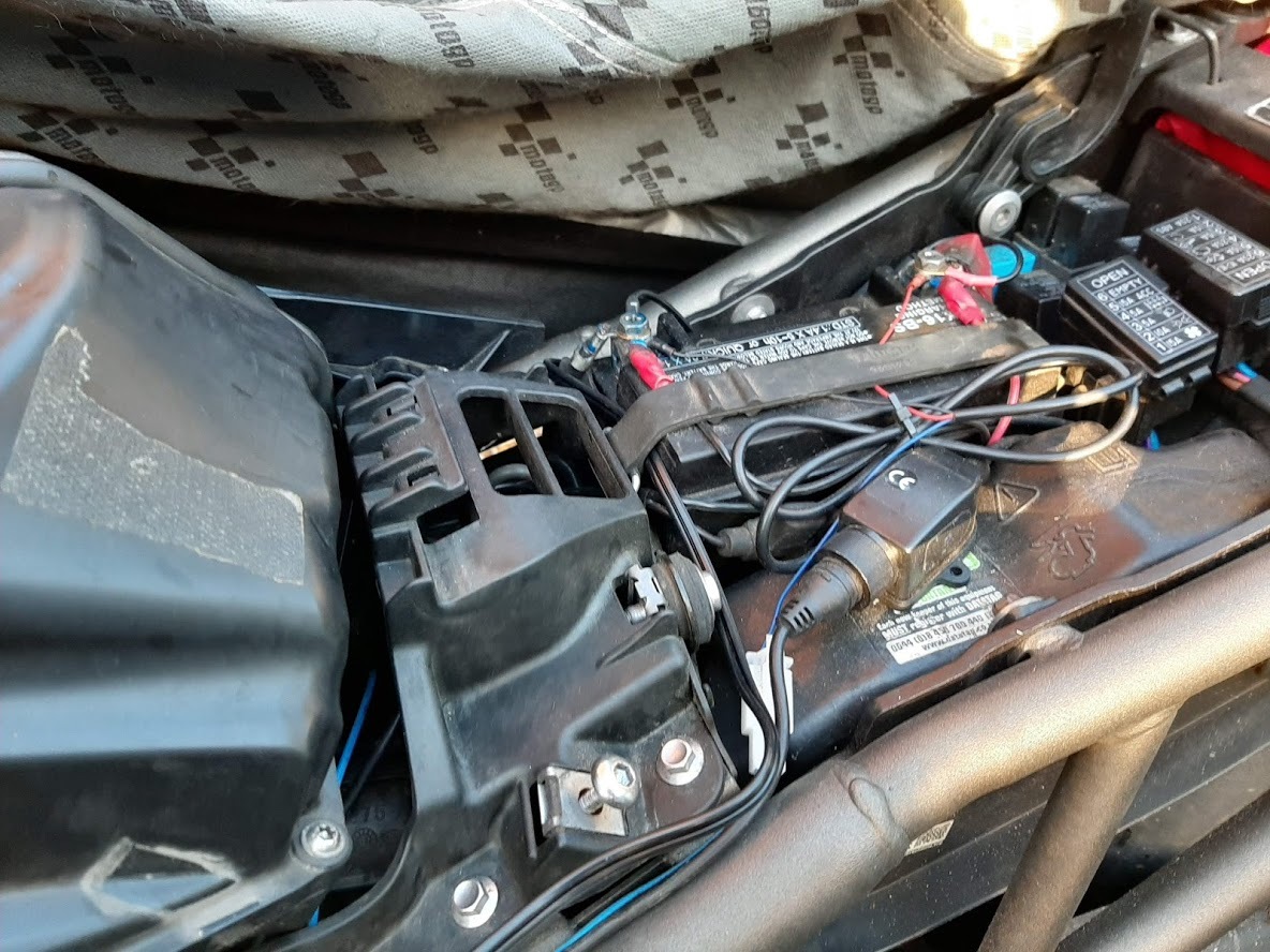

  10. steve lovatt
    9,216
    I have now fitted them to my XRX.
    Relatively straight forward and it has no effect on the ride by wire throttle. The electronics for that are housed in the RH control not in the throttle tube.
    You will need to cut and file a lot off the tube to get the new grip on. Once all the raised bits and the lip at the bar end are removed you still need to file off another layer - use the spiral groove as a guide. I used a file and medium grade sandpaper.
    I took the LH side tank fairing off to route the wires from the battery.
    There is a hidden clip on the inside of the fairing that attaches near the bottom side of the radiator - careful with this as it easily snaps off!
  11. steve lovatt
    9,216
    Its had two washes since that was taken!
