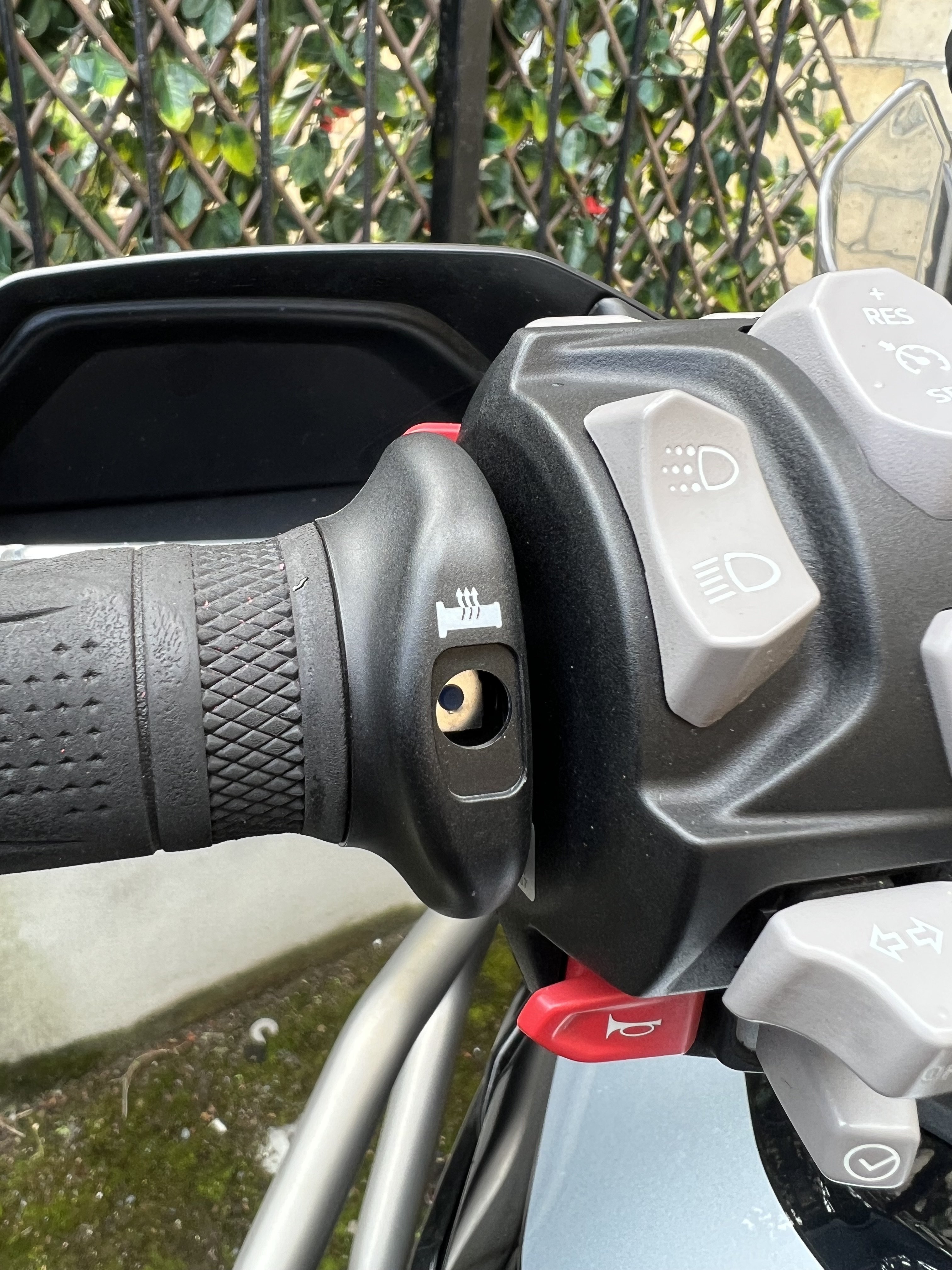

    I recently lost the rubber switch that controls the heated grips on my 21 plate Triumph Tiger 900 GT Pro. The local dealership in Plymouth informed me that the switch cover is not a part that can be ordered. A left hand heated grip would cost £153 plus 1 x Hr of labour, I was quoted a ballpark figure of £235 to make good.
    The switch still works, so I’ve kicked that particular job down the road for now. Has anyone else suffered a similar loss?

    The 2 year Factory Warranty expired in March 23 & was therefore ruled out by Triumph Plymouth. I’m exploring possible fixes using silicon grommet inserts. I’ll post my results if successful.

    Thank you for all the comments. This is my1st fix to keep the weather out. I shall continue to look at a smaller more permanent solution in the mean time. On a positive note, the switch operates perfectly with my makedo grommet.

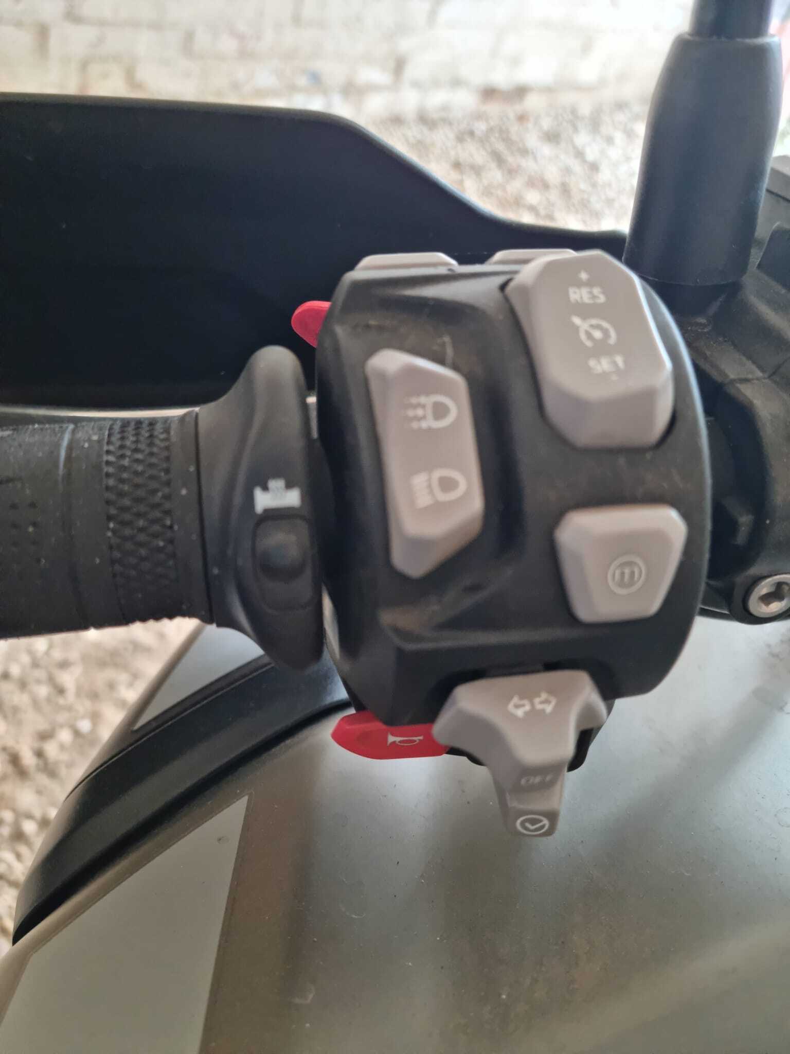

    That’s a brilliant post Paul. Thanks very much for taking the time to dig further than I did. My brother has a Tiger 800, I’ll ask for a comparison pic of his switch. Many thanks indeed.

    My nephew has a 1200 Tiger, his left hand switch gear looks identical to mine. I’m going to splash £6.89 with World of Triumph by ordering the 1200 part & see how I get on. Thanks again @RevPaul for pointing me in the right direction.

    I've had a long list of triumphs, and heated grips on all of them. I can assure you, the rubber button is the same on all of them even if the grips are a different fitment. But I doubt very much you'll be able to get the rubber bit on its own. I hate the way big companies operate like that but sadly thats just the way it is. Hopefully you get lucky and find a salvage or faulty grip cheap. Otherwise I'd just keep working on a home made solution.
