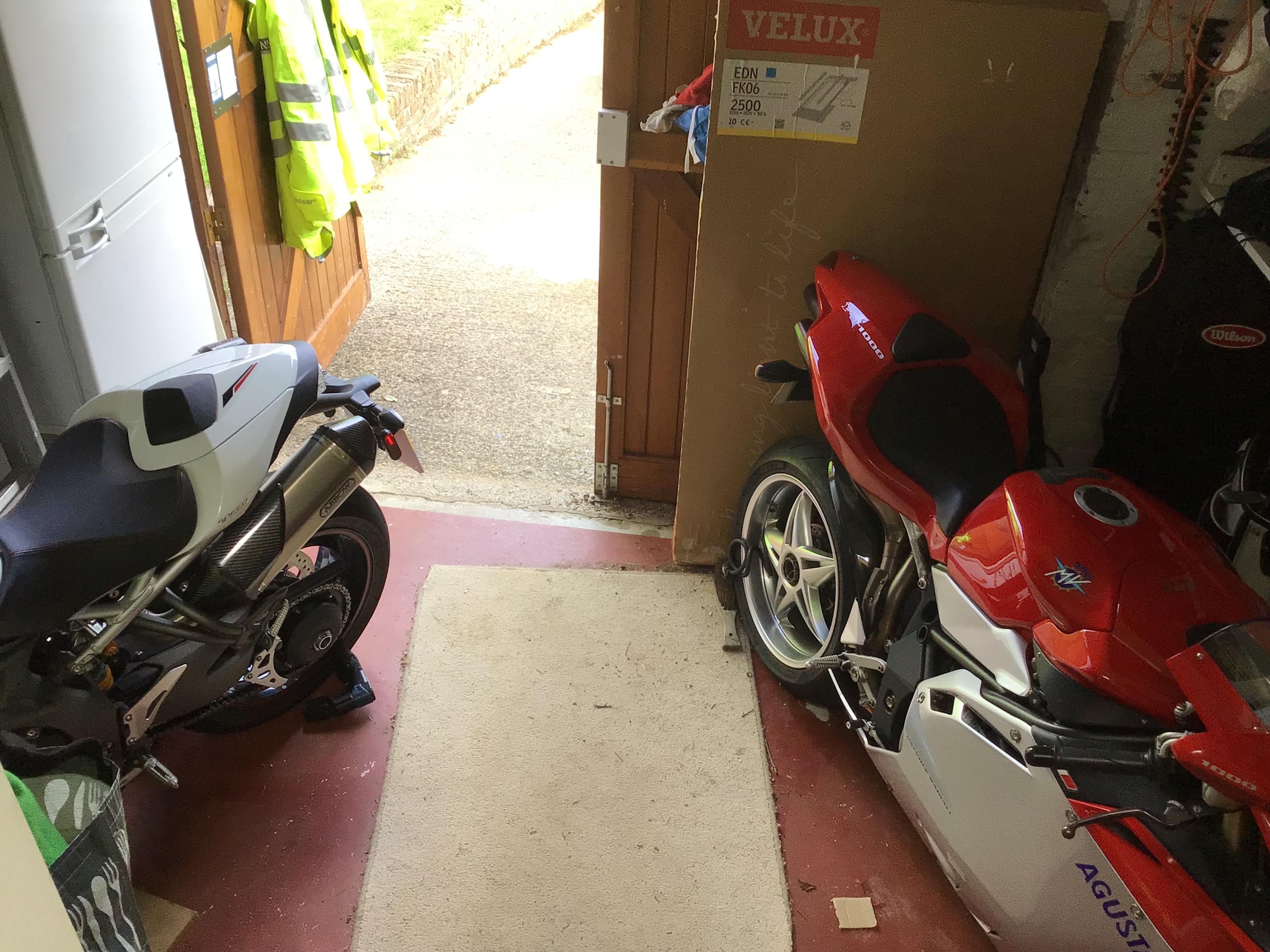

    I’ve been looking at the possibility of installing a turntable in my garage. I’ve two bikes in a very small garage and have to ride past a car up a slope into the garage. The car is on our drive which has retaining walls either side of it and there is not much space to get the bikes between the wall and the car.
    Once in the garage I cannot turn the bikes around so I have to back down the drive trying not to scrape the bikes or cars….As we all know, going forward on a bike is much easier than going backwards, hence the idea of a turntable. Has anyone fitted or installed such a thing? If my bikes had a centre stand then it would be an easy fix, but my bikes do not have them.

    Thanks for all your reply’s. Great to have such collaborative forum members. Looking at the garage again it’s very tight to get a dolly to work. It looks like I will need a turntable type arrangement on the floor.

    I'm struggling to see how a turntable would help in that space/situation. To get a single turntable to work would, I presume, mean moving one bike out of the way first?
    If you're thinking about something like this
    https://www.amazon.co.uk/EasyTurn-Motorbike-Motorcycle-Centre-Turntable/dp/B07KRBVGG8
    then you'll need centre stands on the bikes.
    If you're thinking of something like this
    https://www.motea.com/en/motorbike-...MI8uzPiISn8gIVV-vtCh1AmQbQEAQYESABEgIhCfD_BwE
    then you'll probably need slightly more room as it will be the full length of the bike in wheel-ahead stance, plus a few inches for the dolly base.
    The 1Jac will, literally, turn the bike in its own length (possibly slightly less as you can spin it with the front wheel in the steering locked position) as the four double wheeled castors can each turn 360 degrees on their individual axes as you can see here
    The Abba Skylift is a rather different arrangement altogether and is, I think, designed more for maintenance work than manoeuvrability.
    I do wish you luck with resolving the situation - I'd HATE to think of a situation that would risk a single mark on the peerless beauty of that F4!!

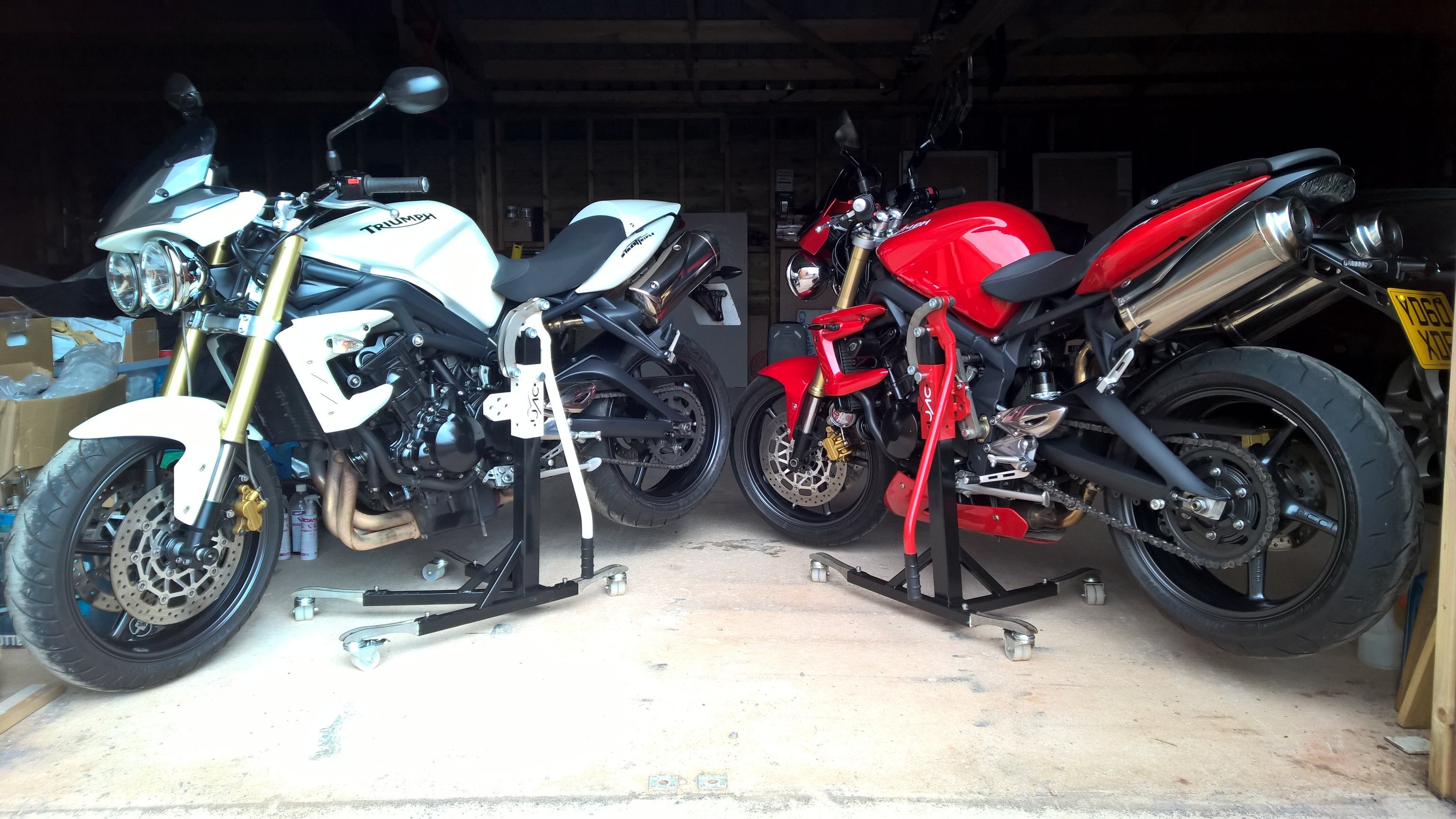

    Pleasure, Sir. A few questions there so I'll try to take them in order.....
    Yep I have two for the Street Triples. They were originally intended to allow me and 'er indoors (hers is the white one) to ride into the garage; jack them up, spin them round ready to ride out - much the same as your current situation though with very slightly more room. The cunning plan ALMOST worked, Mr. Blackadder, sir. The wife is STILL not confident enough to lift the bike onto the 1JAC or shuffle it around - even on the stand - so I end up doing it all anyway. <SIGH> No big deal - she's worth it. And I DO mean the wife, not (just) the bike! You're right - the 1Jac isn't cheap but, take it from me, before I bought mine I tried saving money by buying a well known German brand's version (it's a direct copy - there's a L O N G backstory to the 1Jac's loss of "patent rights" ... but that's for another time) which is, in fact, made in China, and I can honestly say I was happy to take a substantial hit on the cost of return and pay the extra for the 1Jacs! They ARE that much better.
    Can you attach them to either side of the bike? Hmmmmm.... that will depend on the nature of the frame and the mounting lugs on the bike - the only people that can answer that are 1Jac - luckily they are super helpful and both technical and after sales support is top notch. I suggest you phone or email them and ask - they will be very willing to work with you to make sure you get what you need. I do have to say that I'd have HUGE difficulty operating the stand on the RHS of the bike - it's almost a natural instinct (for me) to go to the LHS of the bike and I always feel very apprehensive when I have to manouevre a machine from the RHS. However, I'm pretty sure that I remember having to take one or other bolt out and turn it around to fit one of the lugs so I'd gues it might just be possible. I'd guess the logic might suggest that, if the fittings are both on the left that you'll just have to spin one of them around to keep the stands 'facing in' for the storage position - if that makes sense? Unfortunately, changing the adapters isn't a quick job at all so, sadly, a single lift is unlikely to suffice in your situation but, again, it's something you could ask them.
    I've had my 1Jacs for a few years now and, I have to tell you, it is STILL a bit nerve wracking for me lifting the bikes onto them. Putting that F4 onto one for the first time would probably have me wearing a nappy to catch the results! Just photogaphs of those things - F4's that is - cream my jeans, so to speak, so handling ("fondling" is probably a more appropriate term!) one onto a stand, any stand, would be terrifying! However, therein lies a point - you cannot have bought one of those and have been thinking about how to save money on a stand for it? That would defy all logic, though I guess to some extent the cost and value of F4's might defy some logic or reasoning.
    Seriously, though - you have what is, arguably, the world's finest looking road bike and you'd contemplate putting it on a dolly? NAH, doesn't compute. For me, at least.
    It's a pity you're a distance away, I'd be happy to let you play with my 1Jacs (OOOH ERRR .... BLIMEY, MOTHER!!) to try before you buy.
    I think I dealt with a guy named Chris Liles at 1Jac - very well worth a phone call.
