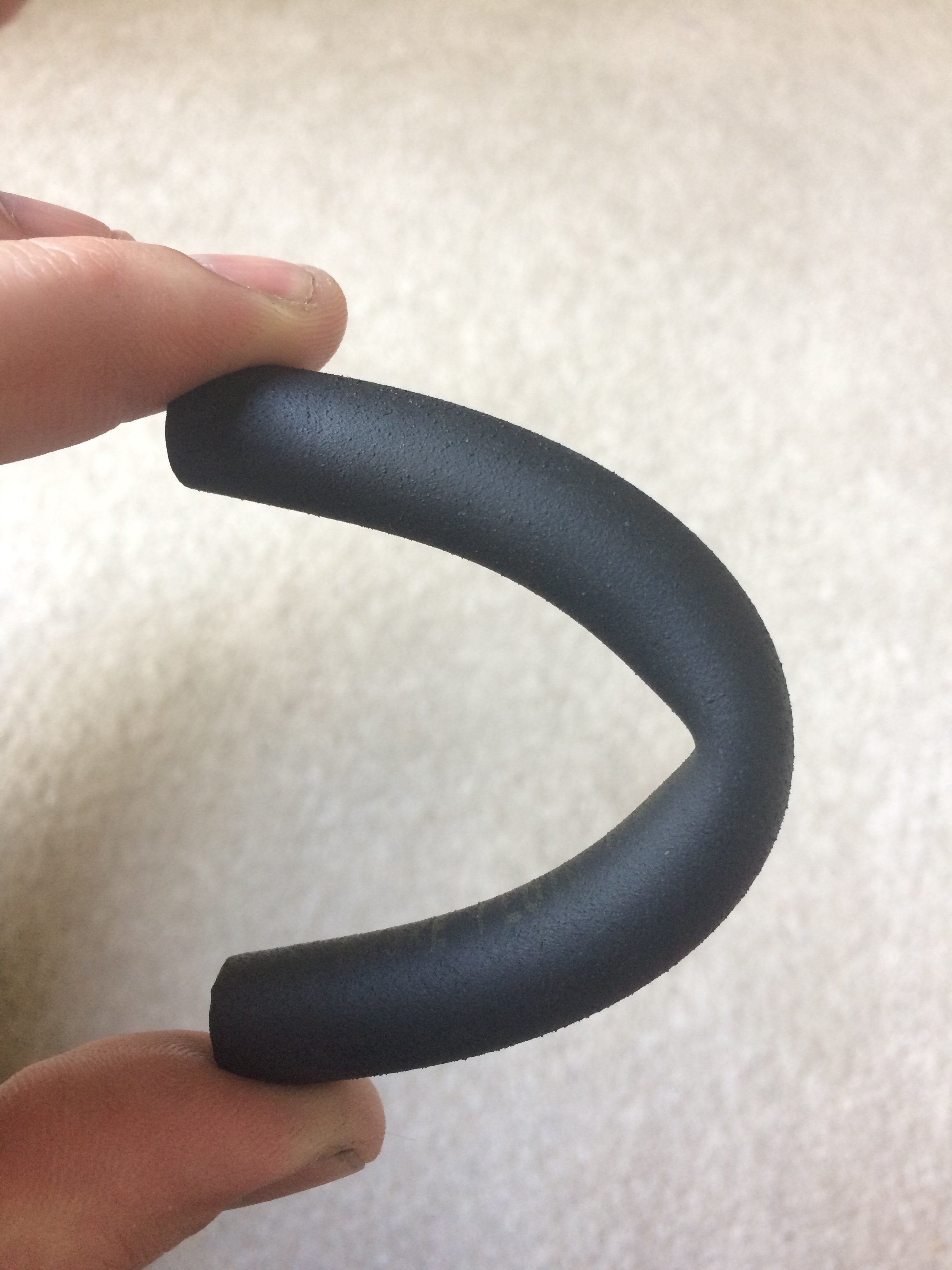

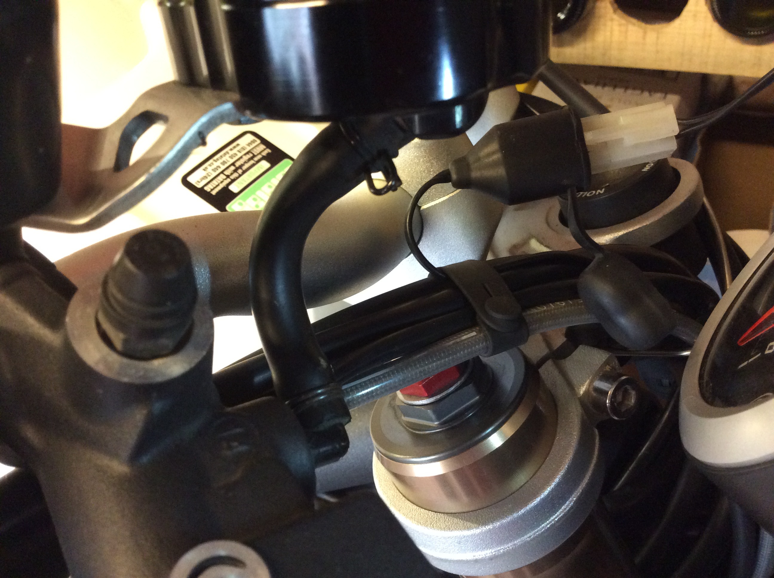

    Hello all, I really need some help.
    I have recently changed my front reservoir on my ‘08 Speedy and noticed that my hose from the reservoir to the master cylinder had a tiny rip in it. I need a new one (it’s a U shape that has been pre-set into that shape) and I can’t find one to buy anywhere. I can just buy some 8mm ID hose but they kink easily and that’s no good.
    I also don’t want to buy the Assembly (ie reservoir included) as I already have 2! And it’s about £60!! Lol
    Any help would be great
    Thanks in advance
    Nick

    Steve,
    Thanks for your reply.
    I have been to a fair few in my area. They have the size I need (8mm ID) but they are all straight
    When you bend them they kink and this wouldn’t be good would it? It’s only low pressure. Would a kink be a major issue do you think?
    Cheers
    Nick

  6. Speed Fr3ak
    Speed Fr3ak Member
    Jul 12, 2018
    36
    Wiltshire, UK
    Thanks for the messsage.
    You can’t get mine as an individual item unfortunately.
    Just out of interest what shape is yours? Is it U Shaped? How long is it please? If it’s similar I may purchase one and see if it fits?
    Don’t suppose you could take a picture for me could you? Lol
    Cheers
    Nick

  8. Yorkshireman
    3,399
    The bend is approximately 90degrees and it’s 70mm long. Bike is a 2015.
