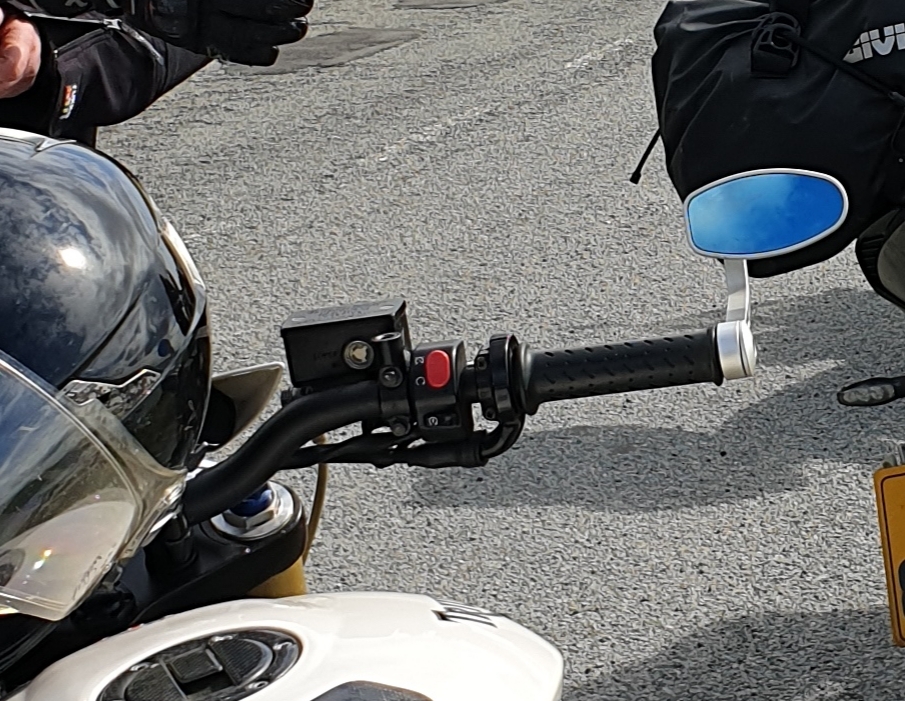

    not keen on the standard item and it’s bracket, seen a few with black Triumph resivoirs which look better, what are the options and pics please.
  2. Yorkshireman
    3,399
    I have the billet Triumph ones on mine, came with the bike. There’s a rear one on eBay at the moment for a reasonable price.

    Do they come with a new bracket too.

    At the front, it uses the original bracket, but you have to trim the hose to a shorter length (or it will kink). If you plan on returning it to stock at some point, you can buy original Brembo hose on eBay for a fraction of the Triumph price. The rear one is a simple swap with no other adjustments.
    I swapped mine out very carefully, taking care not to get air into the system and avoiding the need to do any bleeding. There's a higher volume of fluid in the old reservoir - so as long as you don't spill any, there's no need to buy a top up. Whatever you do, protect the bike from stray brake fluid.
    Instructions attached - although they're slightly confusing as they cover several different Triumphs.
    Shout if you need more specific tips on the procedure (like not squeezing the lever once you've emptied the fluid o_O) - always happy to help a fellow Essex Man.

    Just swapped out my front reservoir. Looks the nuts and only took me 10 minutes. Not cheap though but definitely worth it
