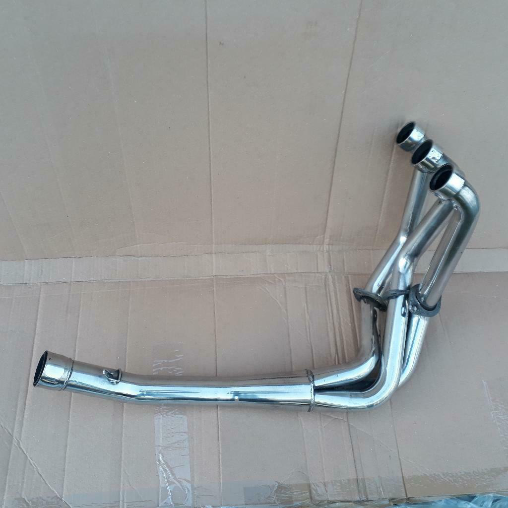

    Gentlemen, I found this on the local for sale site. Listed as a 3 into 1 header for Triumph 955i / T509 . I thought those engines had an oval opening not round but this one looks round. I’m wondering if it’s mis labeled, will this fit a late 90s Sprint/Daytona 900 triple?

    Yes this is a early 509 header the oval shape was about 2002 / 2003.

    so they will not work on a T300 motor? If they won’t, then does anybody need them? 120 euro is the asking

    But they should fit early models no problem. Why sell if you have an early one.

    I don’t have it, I saw it advertised and was about to snap it up, but if I can’t use it, I’d pass on the info to someone who needs it.

    Not sure on those, spacings and fit etc may be different

    Honestly don't know for sure if they will fit or not. My gut instinct is not. Have a look at the Sprint Manufacturing website www.triumphparts.gbr.cc and compare it with what they have on offer.

    I put one on and the collector comes too close to engine casings they do fit but you need to do a bit of engineering (heavy hammer)to give it clearance,just in one area and on 1 pipe.
    I didnt bother in the end and went back to 3 into 2.
    I used on a t300 1994
