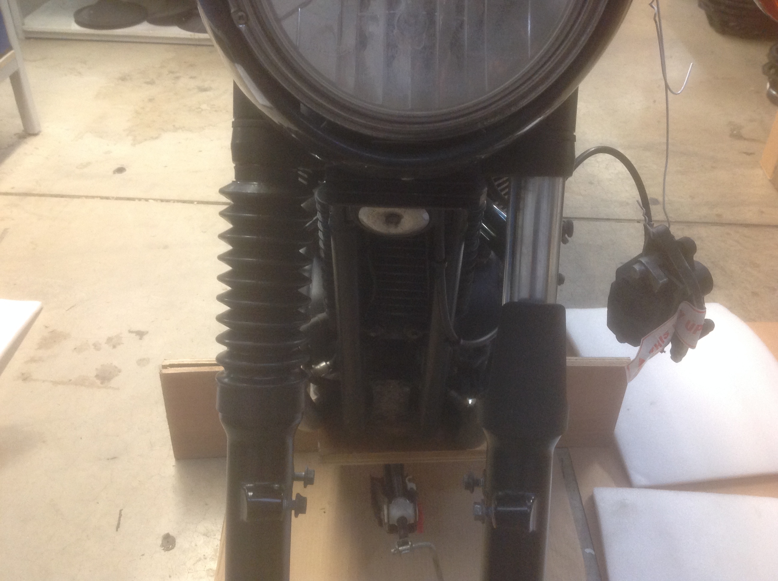

    Hi all,
    Got some new springs to put in and removing the forks to drain looks a pain. Anyone know if it is possible to undo the damper rod bolts at the fork ends and drain it from there?
    Looks doable to me, doesn't mean it is though!
    Any thoughts or tips welcome

    Take the front axle out and up in the forks there is the bolt that holds the dampers in place. I'll attempt a picture!
