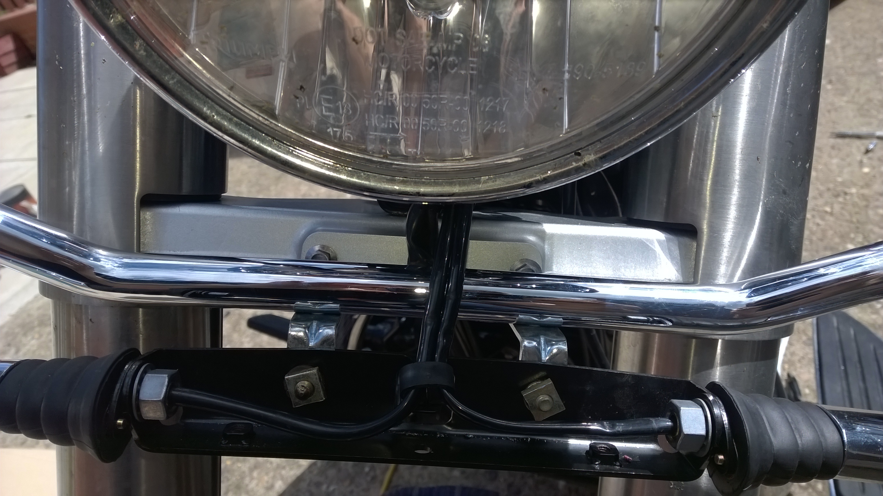

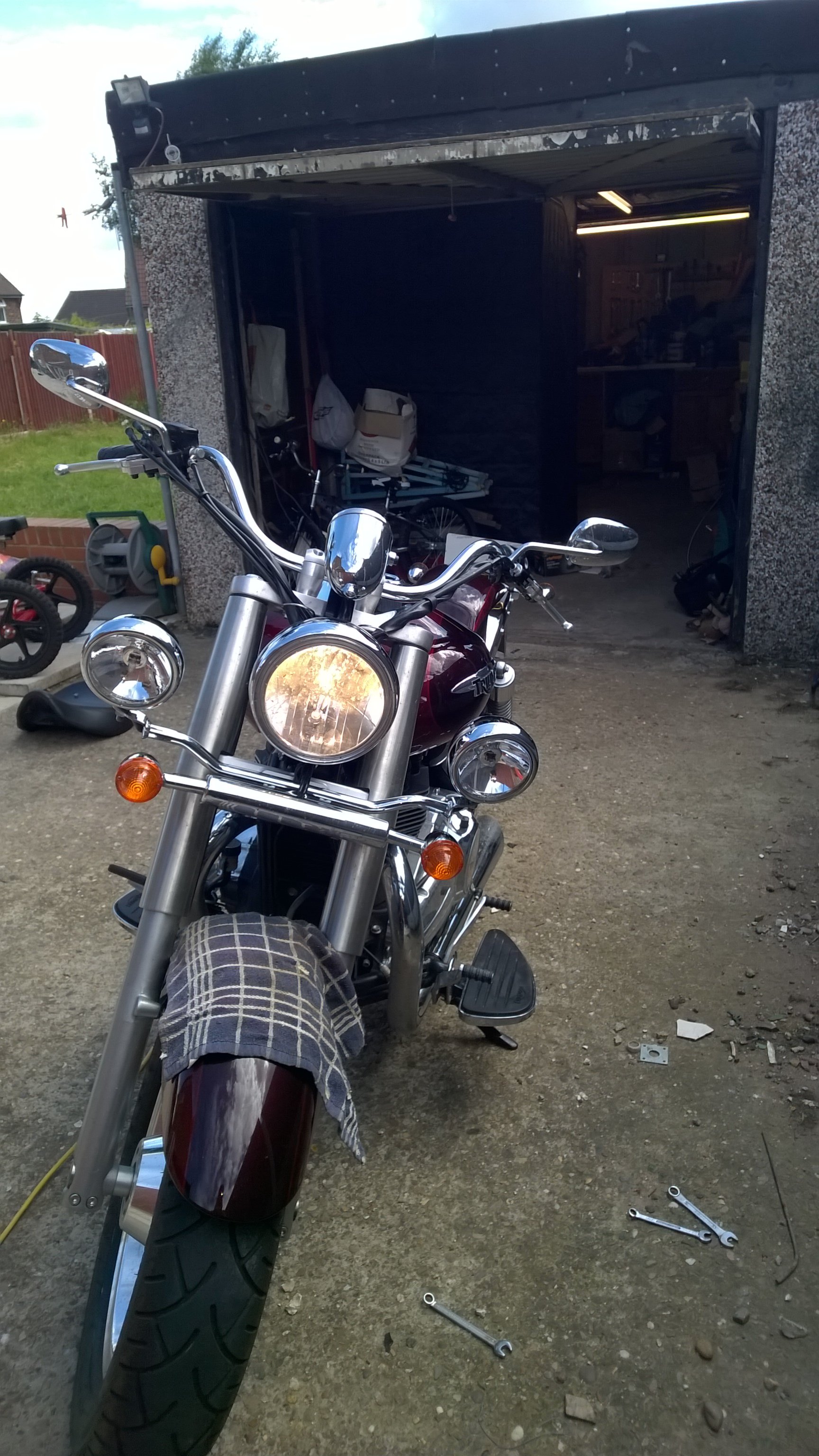

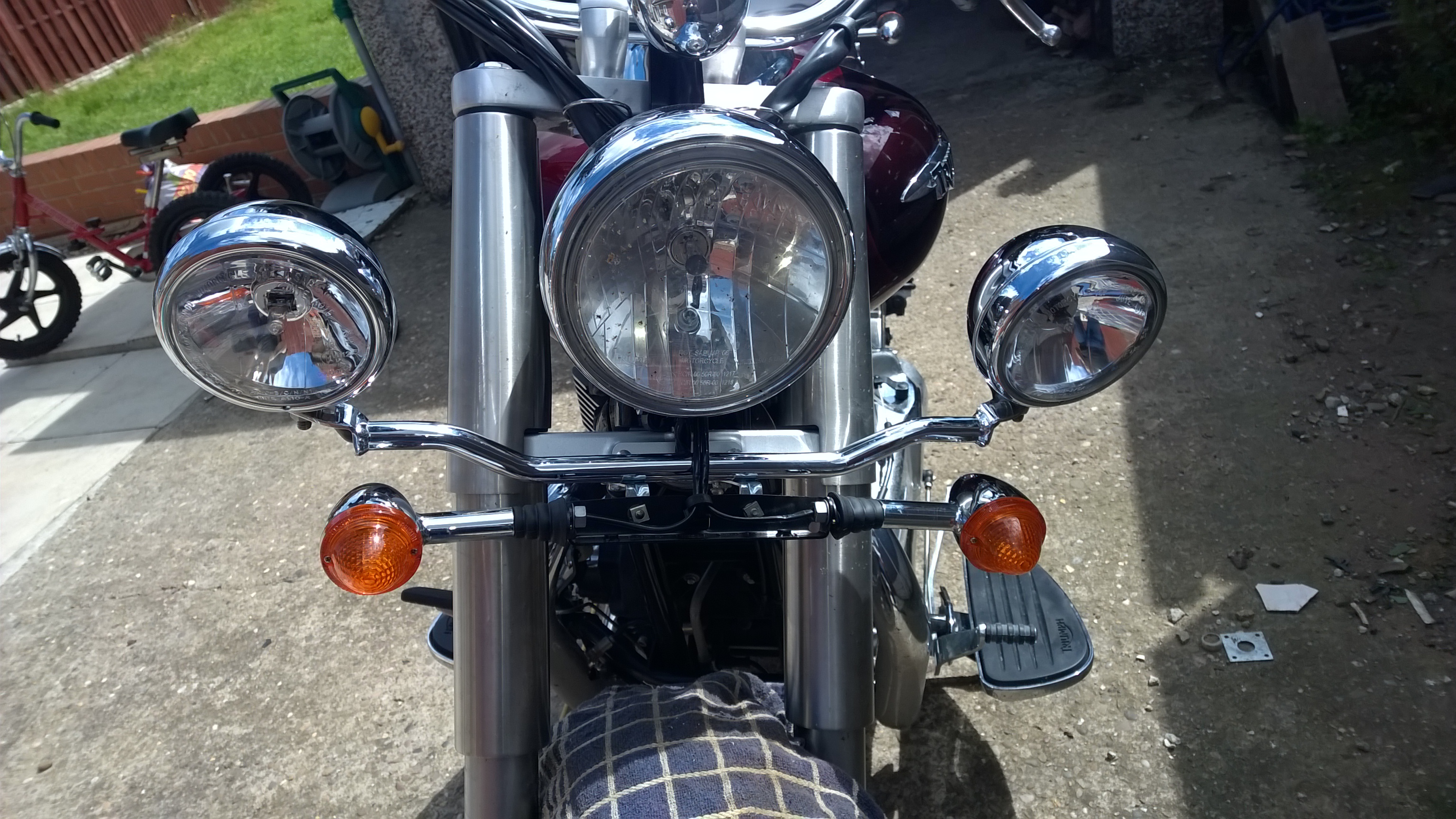

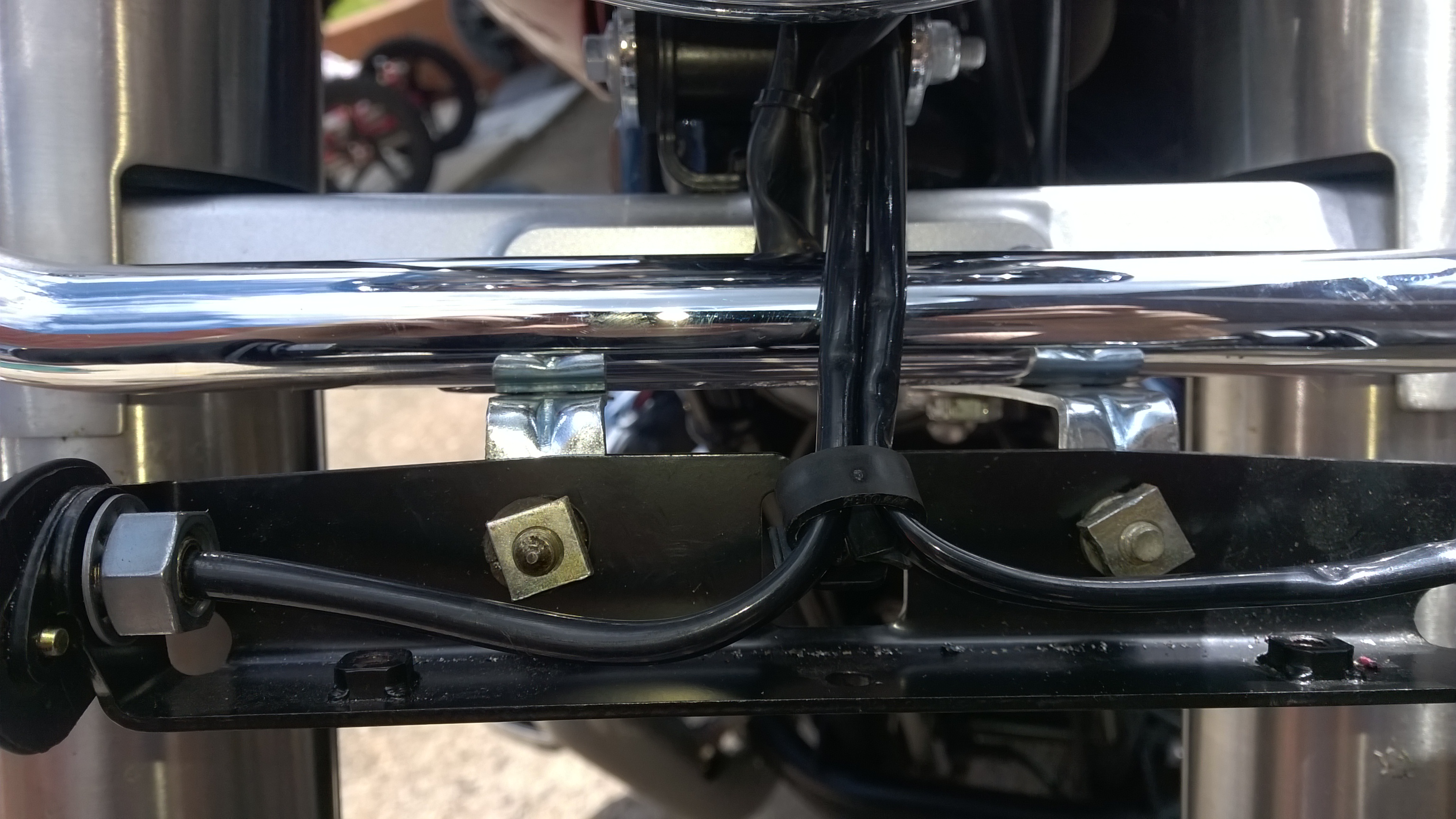

    ok just a brief note on the fitting of the lights, will fill in more detail when I'm on days off.
    lights and light bar are from a 2014 bike and bolt to the yolk, on a 2016 bike you cant bolt them straight on as the indicators interferes with the bar (both want to be in the same place)
    indicators cover un bolted, indicators un bolted from yolk, light bar fitted and wiring fed through, two little brackets made up and bolted to the same position as the light bar, the indicators can be mounted to that.
    as I say when I've got more time I'll do a full write up including tank moving (not removal)
    here's some photos

    Yep well done Tony good job,:) are they the ones I pointed you towards on ebay :rolleyes::rolleyes:

    yes thanks, got them for £70 + £10 pp.

    They where a set for sale on ebay, came pretty much complete I believe, but tony made up two small brackets to
    slightly change the position on bike to avoid something
