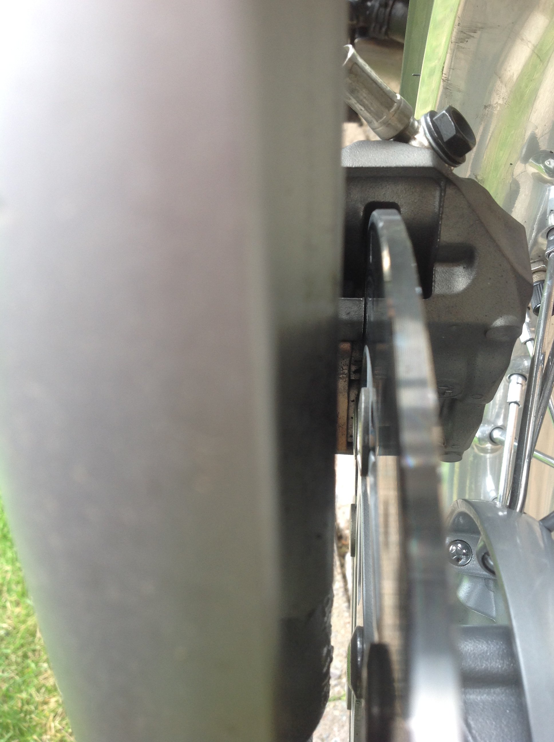

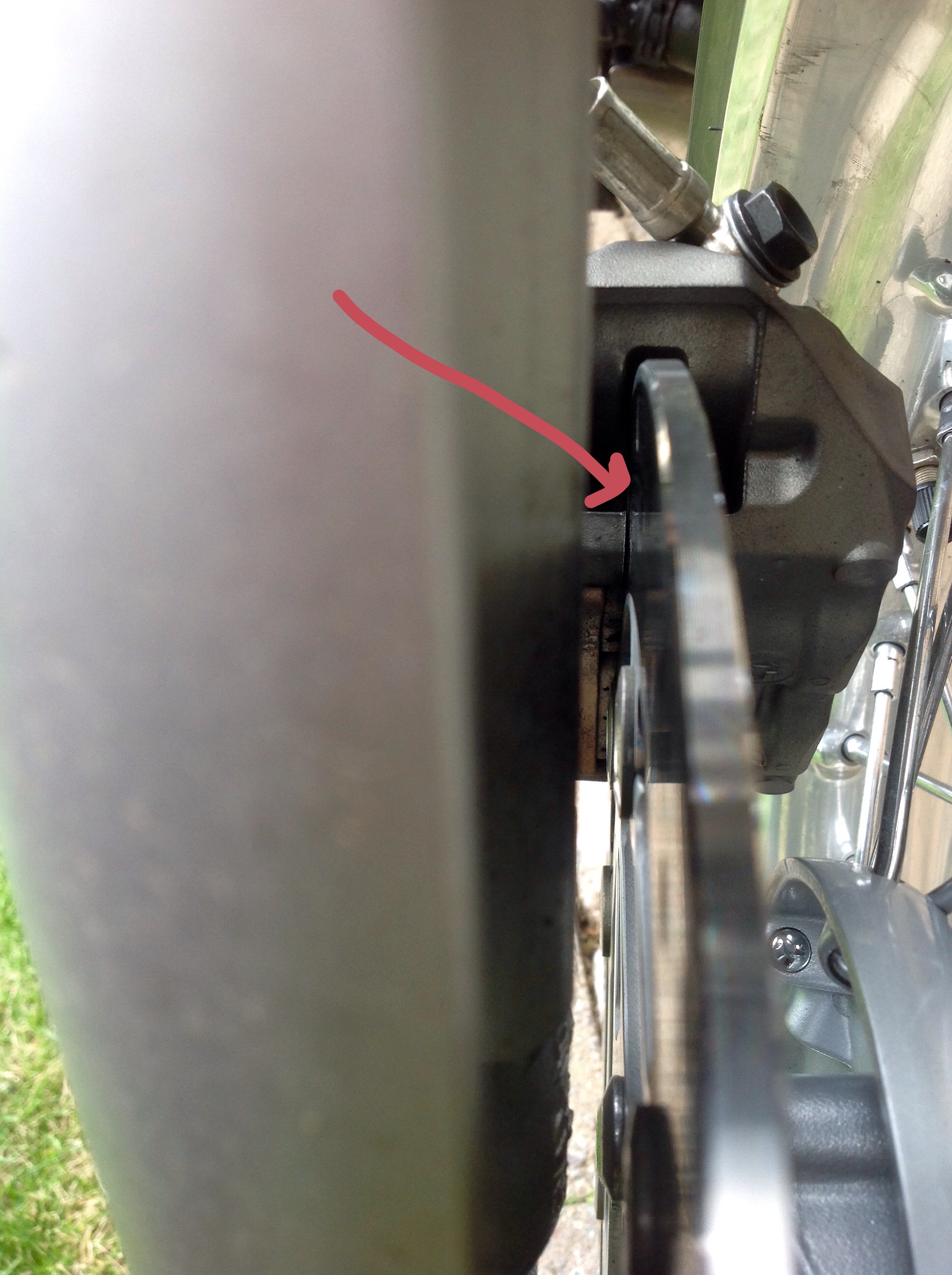

    After its first service today the dealer suggested the noise, which a couple of customers have complained about is the front right hand brake caliper just touching the disc. They took the wheel out and the caliper off and put back together which now gives it a very marginal space compared to the other side. Dealer said they check all Thruxtons at PDI. Perhaps why more noticeable when leaning round roundabouts.
    Thumbs up to Triumph Birmingham.
