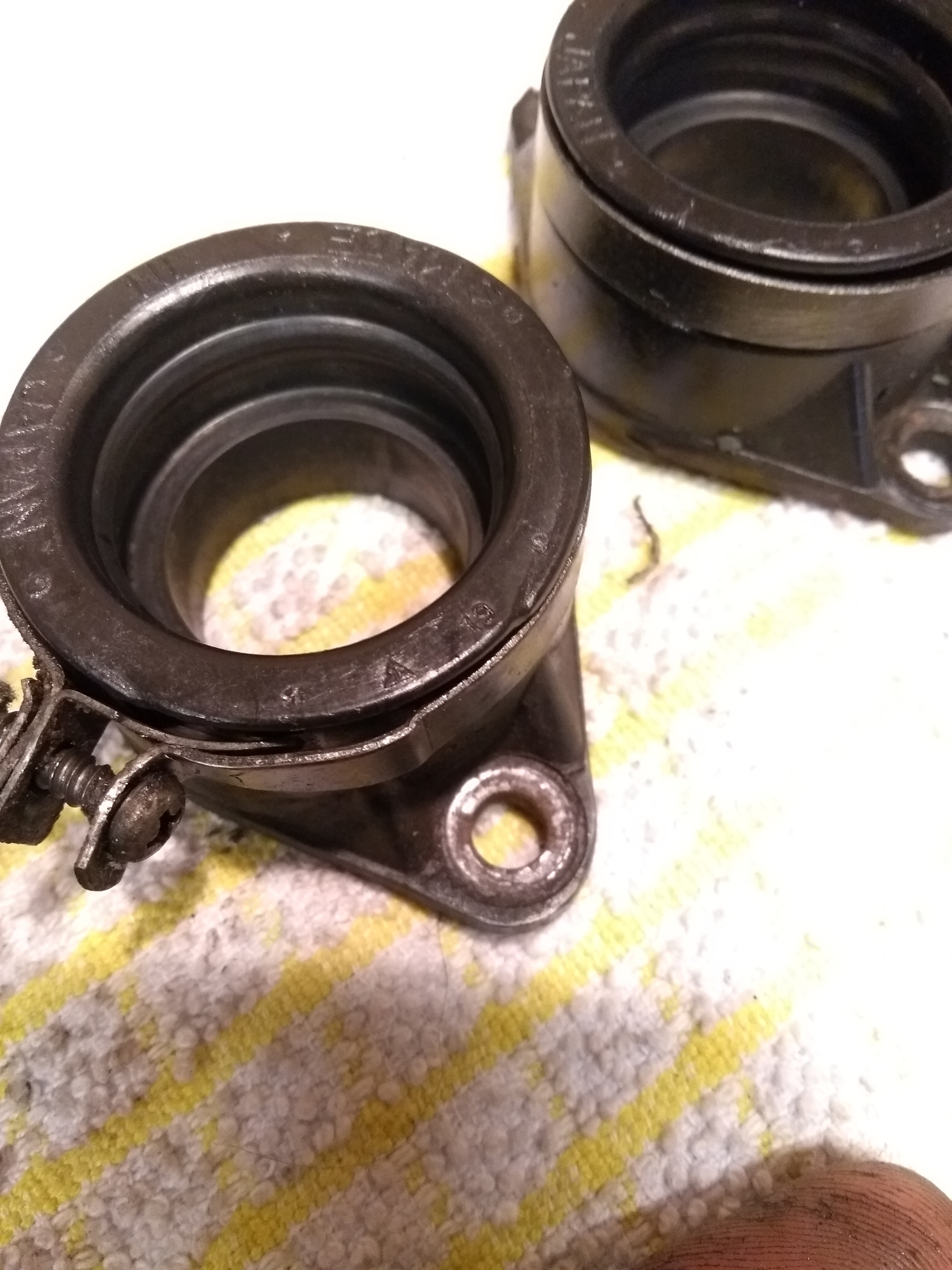

    IMG_20200510_171112745.jpg So started again today.
    Bike starts right up, running on three.
    Third cylinder no show again. I fear my oil level is increasing which would suggest its getting fuel and its not igniting and getting past the rings. I have good compression, over 120 on all cylinders.
    I have good spark.
    So it must be mixture, (guess).
    I have the carbs off again and have rebuild and cleaned again carb 3 and 4, ( 4 for reference and they both seem good.
    These are my inlet rubbers they all seem different and although very similar have different numbers stamped by the Suzuki Made in Japan logo.
    The one with the rubber o ring is from 4 and the other from 3.
    26, 19, 24, 39, they look identical except two have o rings and two don't ,the offending cylinder had no o ring and some clear silicone around it.
    No cuts or tears
    How poorly does it need to fit to loose air and upset the mix enough to stop it firing?
    My only other thought is the bottom adjustment screw on the bottom was further in than the others.
    I cleaned and bench sync these carbs last week the all, have new Main and Primary jets, all other passage ways cleaned and the needle was raised 1 notch on all.
    All input appreciated.

    They all should have an o ring James and don't forget 2 of the pipes from the carbs are breather an should go up hth

    (In my experience) the vacuum connector would be blanked off on every carburettor except the one that is linked to the vacuum-operated petrol tap.
    Oil level rising and cylinder 3 not running suggests that the float needle is allowing petrol to flood number 3.
    Vacuum from carb 1 is connected to carb 3 vacuum. Could the vacuum be affecting the action of the float in carb 3?
    I'd try capping the vacuum pipes that are not linked to the fuel tap. If that makes no difference, then check the floats and float needles, and the float levels.

    I would agree that if the oil level is rising that its due to a bad float/needle on no 3 carb i presume that you have checked the floats for any punctures/leaks and the needles when you rebuilt them? it may be worth checking the fuel levels in each float chamber as that will affect mixture.
    One vacuum hose should be all that's needed for the fuel tap and i would also dump all others as they are a pain.
