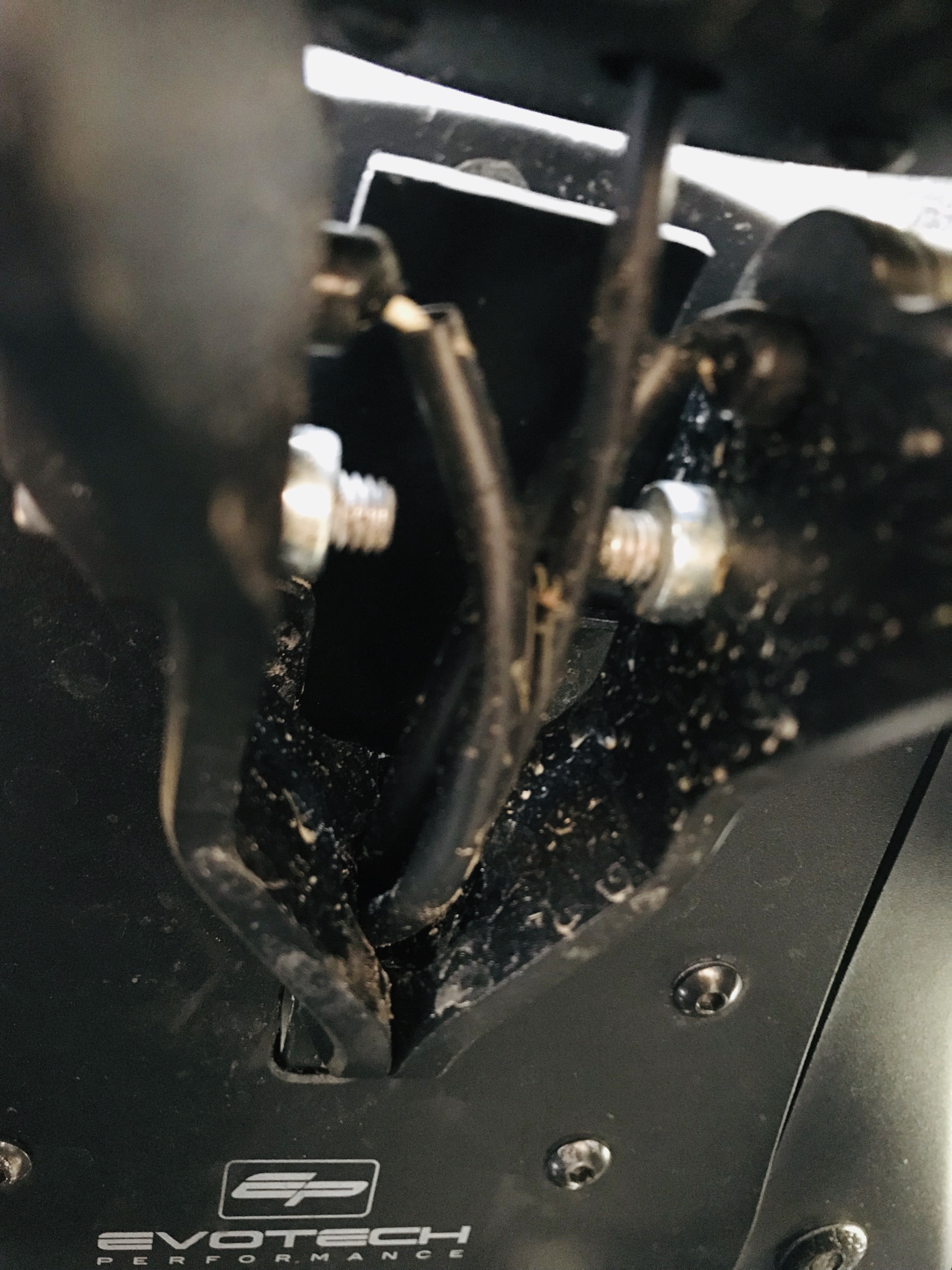

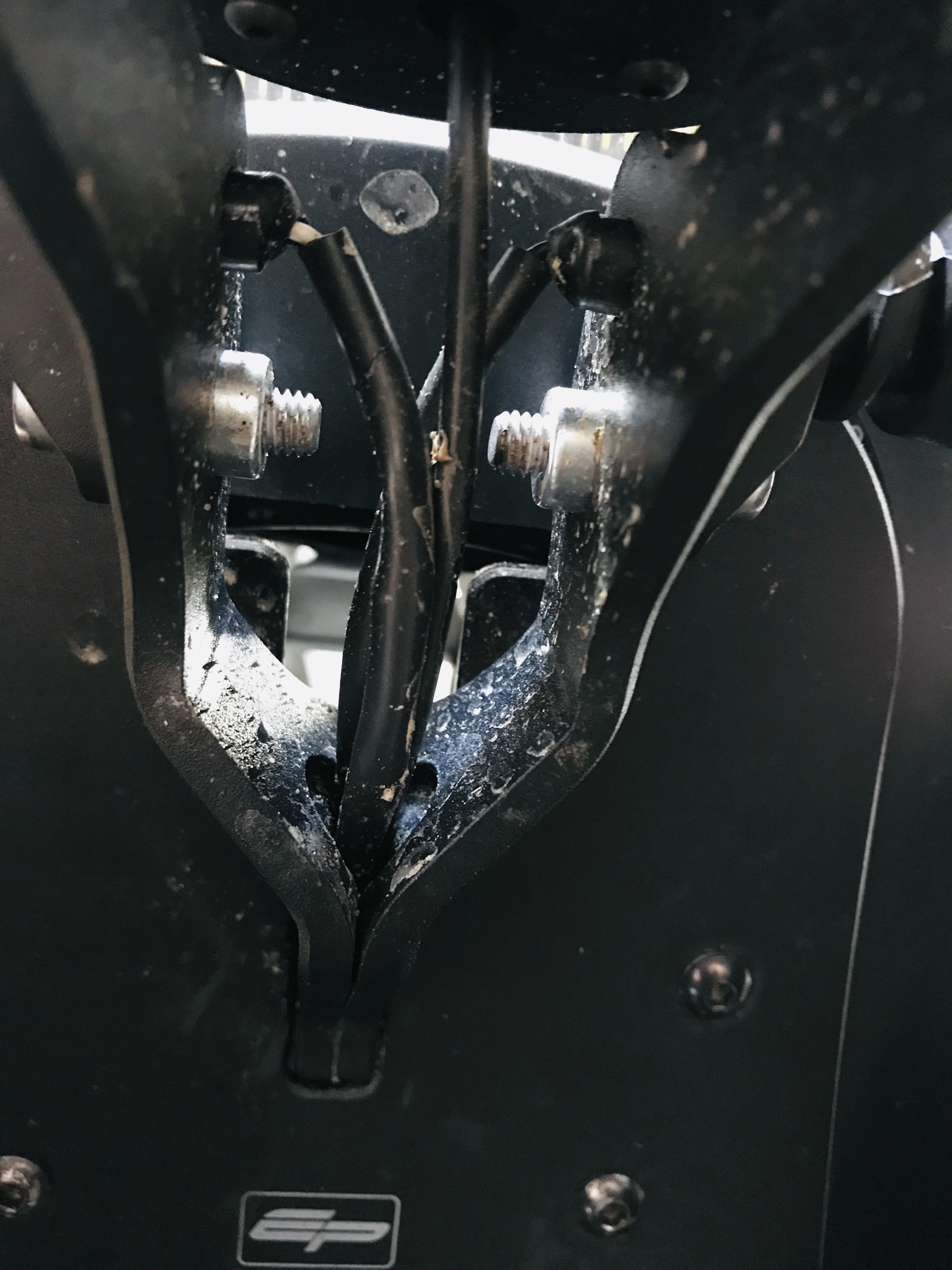

    I was out in the rain a couple of weeks ago and I noticed that under the passenger seat/c was soaked from the evotech. Really soaked under there with crap.
    If ya look underneath, there’s quite a big gap where the wires go up.

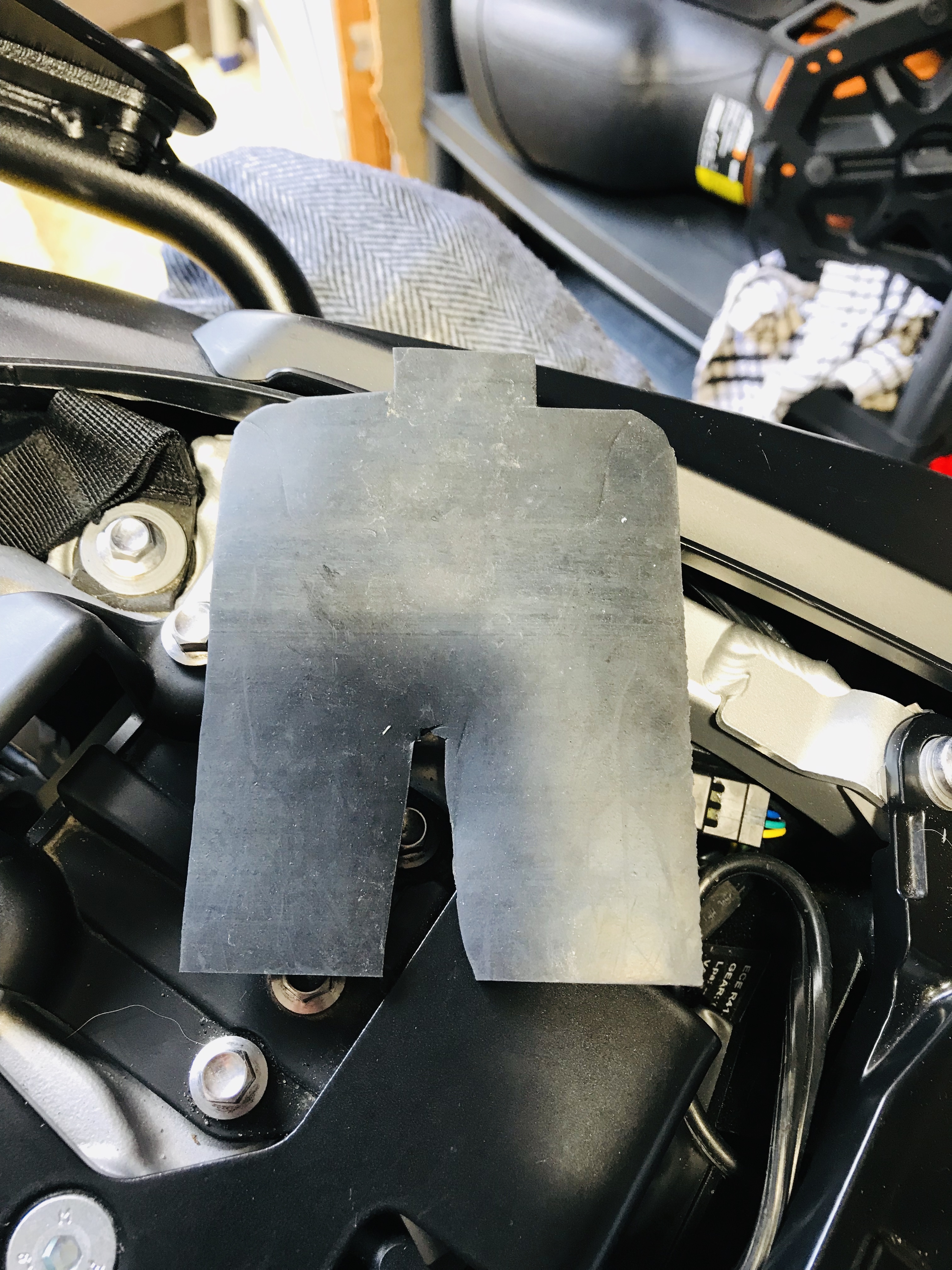

    So, after a couple of “lemonades” I came up with this.
    3mm rubber sheet (from making a fenda extenda for the xdiavel) and viola, no more water into the seat space. Took 2 mins. Just loosen up the bolts for the tail tidy and slide in the rubber seal. Tighten them back up and all sealed up.
    Ideal for nc500 in August!

    That’s a great fix mate. :grinning: You’d think for the money they charge for these tail tidies that they’d think of this sort of thing when developing them.
