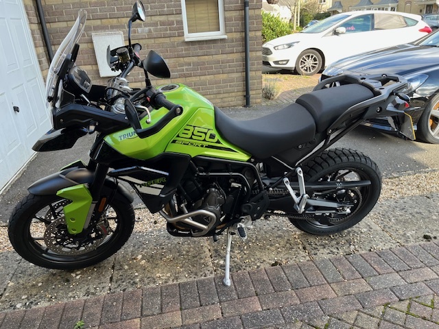

    I have a 2021 850 Sport. My bike is rated at 84 horsepower. This model year 900 Tiger's were rated at 93 horsepower. The 2024 Tiger's are rated 106. The posted engine specifications look the same. Can I get a tune to get some or all of this power out of my engine? I'm out of warrantee, so that's not an issue.
