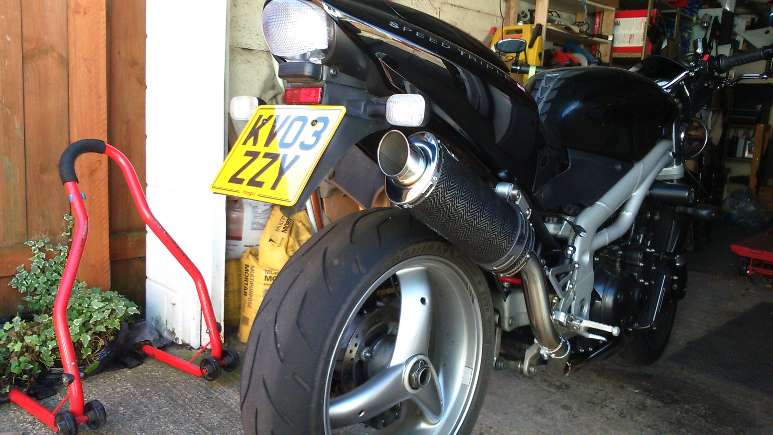

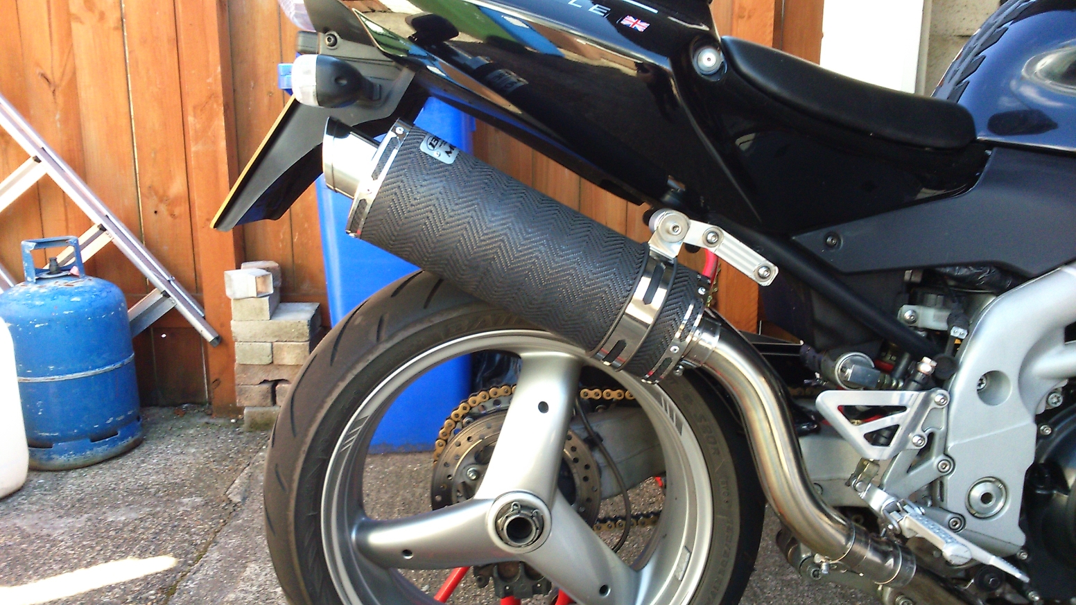

    I use one of my own Bex Moto cans without the baffle on my 955i Speed Triple. I found a benefit from changing the Factory 10158 which I used with the TOR can to the 10158PK map with my can. The map is a tad richer and works better. Easily changed with the free TUNEECU software and an OBD2 cable from Lonetec. DSC_0272.JPG DSC_0268.JPG
