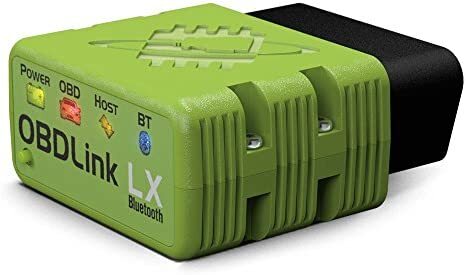

    I use an OBDLINK LX Bluetooth connection and Tuneecu app on my phone. Mainly used to balance throttles and reset service light.

    Hi guys, just reading the posts on a reader for engine management for your bonnie, try this it's the only one that works properly. :)

    That's the one I have and it works well on an 2018 765 rs.
    You can read codes, balance throttle bodies etc.
    Paid £90 for it UK.

    I use my LX reader on a 2004 st, 2010 speed triple and a 97 and 99 daytona, there's also a MX model but has features that we don't (can't) use on motorcycles, worth there weight in gold, it's paid for itself many times over not having to go to a dealership for problems and service aspects. Good luck with your engine light coming on, doesn't sound too bad if after 3 cycles it cancels, had a similar problem with the st when I filled up with fuel right to the top, these things are sent to try us !!!!!

    I carry the OBDLink LX (mentioned above) in my small toolkit. So if I ever got a warning light I can check and reset codes on the road. (I have TuneECU on my phone, but I assume that the OBDLink app would also show codes and allow clearing too).

    @David Aldworth
    Plug that in under the seat.
    Open app on smartphone, mines a Samsung S20 on Android.
    Do what you need to do once it's paired.
