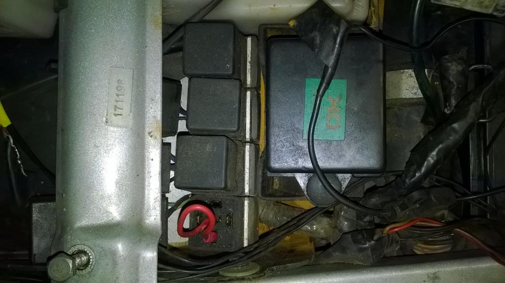

    im starting to dig into the electrics on my 1999 955i triple and have a few questions of you good folk.
    1. Headlight operation, when I stick on sidelights nothing happens, im presuming the two small bulbs are shot so not too worrid, but when I stick on dipped headlights only the left hand light comes on. when I switch to full beam or flash the second full beam comes on as well as the left, bu tthen goes back out when back on dipped. is this normal?
    2. Relays, this may be related to the above, but previous owner seems to have b4stardised the wiring a bit, could this be the cause of my above issues and if so what relay should be here.

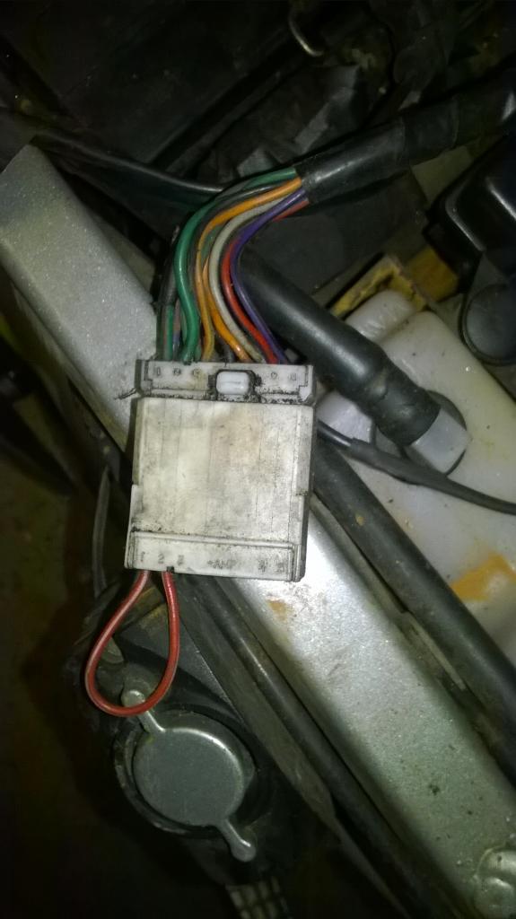

    4. What is this connector, and why the loopback, is this normal?

    The white connector block with the loop of wire is where the factory alarm would fit and is correct.
    The relay bodge will almost definitely be the problem with your lights and could cause other problems such as battery drain etc. You need to fit a new relay, and while you're at it check and clean the others as they are known to be a little problematic.

    Ahh nice one, I can ignore that connector then. I will pop out the relays and clean and get a replacement for the missing unit. Any idea on part number for the missing item, (Sorry I haven't got a service manual just yet).

    I take it that you have replaced the right hand lamp too ? if not it could just be the dips knackered...
  6. nicop
    nicop New Member
    Sep 15, 2014
    2
    yep afraid i have tried another lamp in that one and the same result, swapped the headlight looms also, still looking for the relay part number forthe switchover relay as im a bit slow
