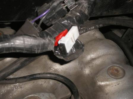

    The diode pack is taped into the harness under the tank over the valve covers.
    The diodes are plugged into the white clip.
