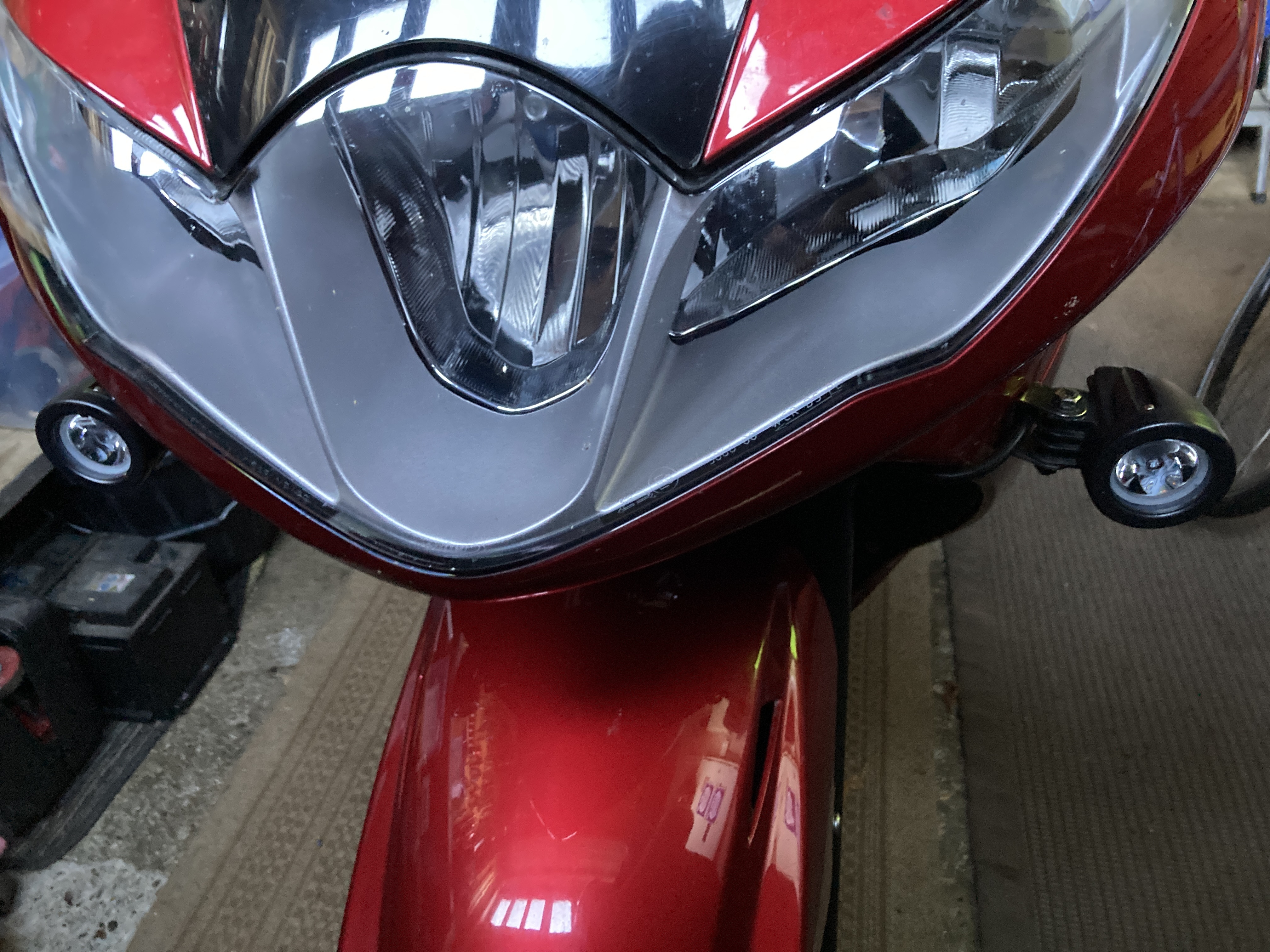

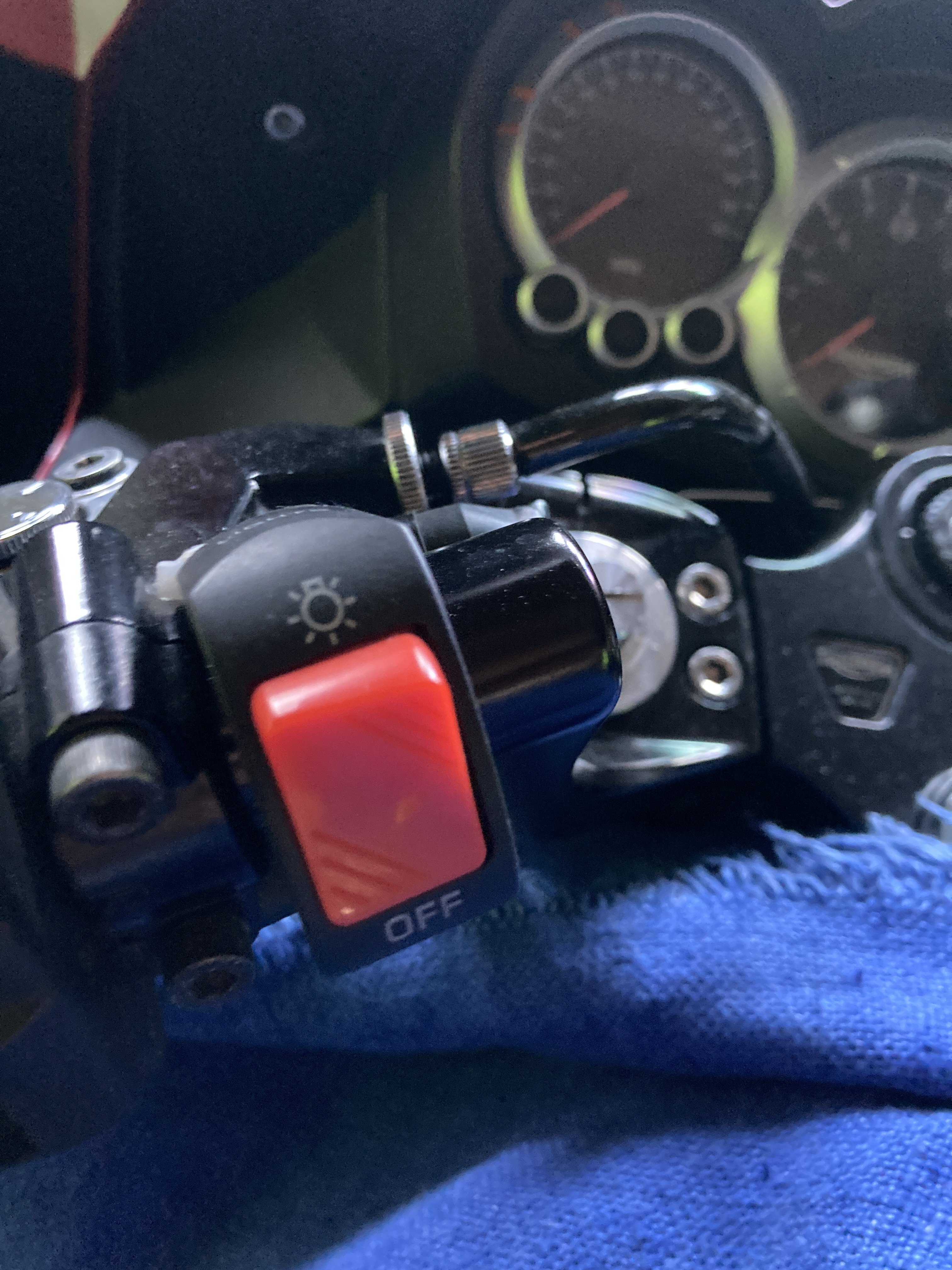

    Couple of pictures of the extra lights on my sprint gt. Bought a switch from ebay and wired them straight to the battery through a relay. Think they are 10w led - weren't very expensive. The driving experience at night is miles better.

    Good looking installation. On my MG Norge, I had mounted a set on the front fender brackets. They worked well. I actually have not added any aux driving lights yet but still in the hunt for some.
