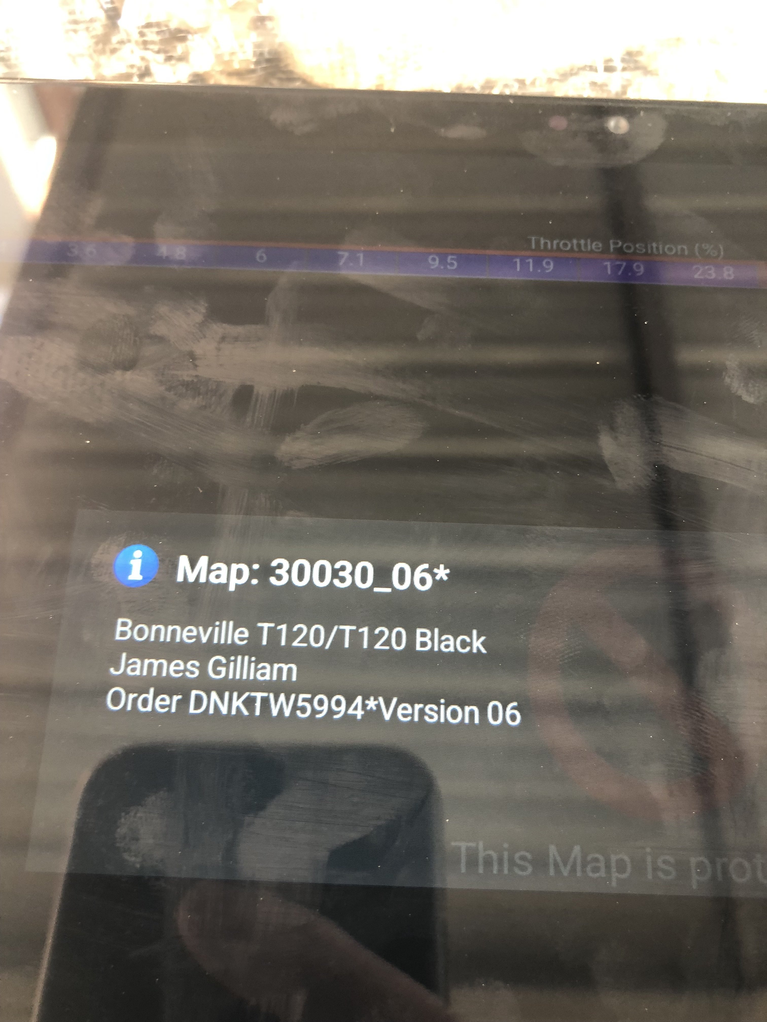

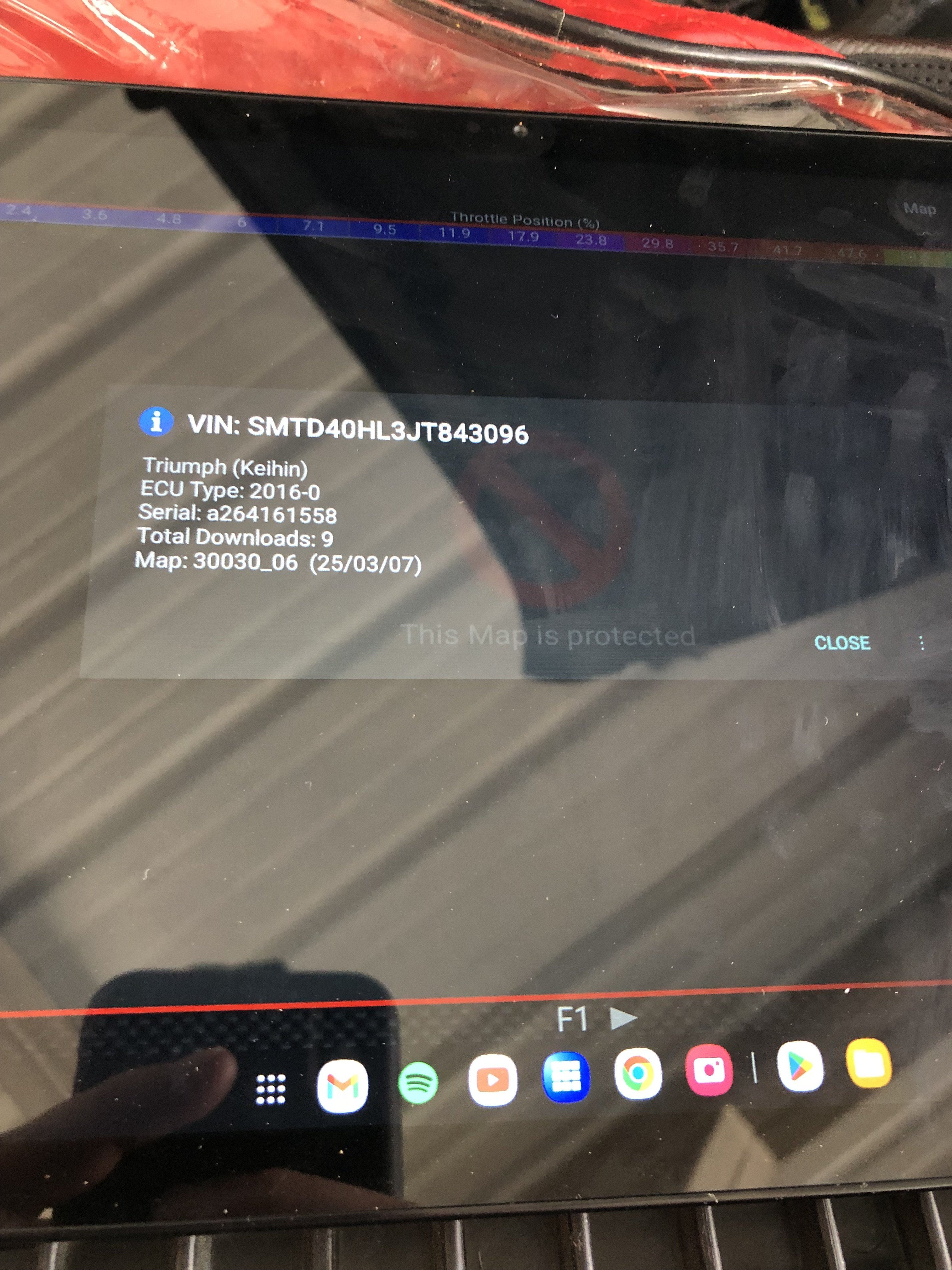

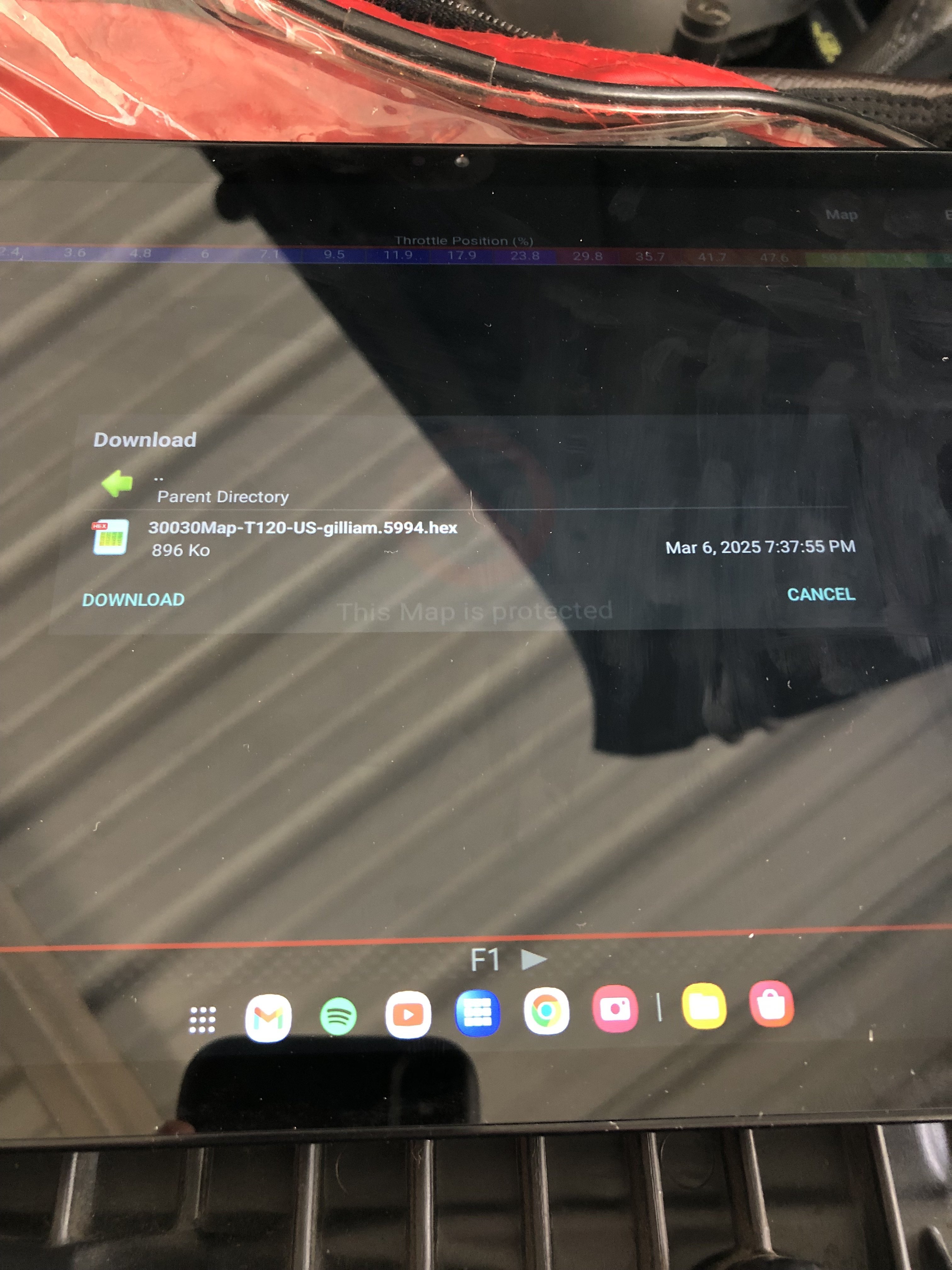

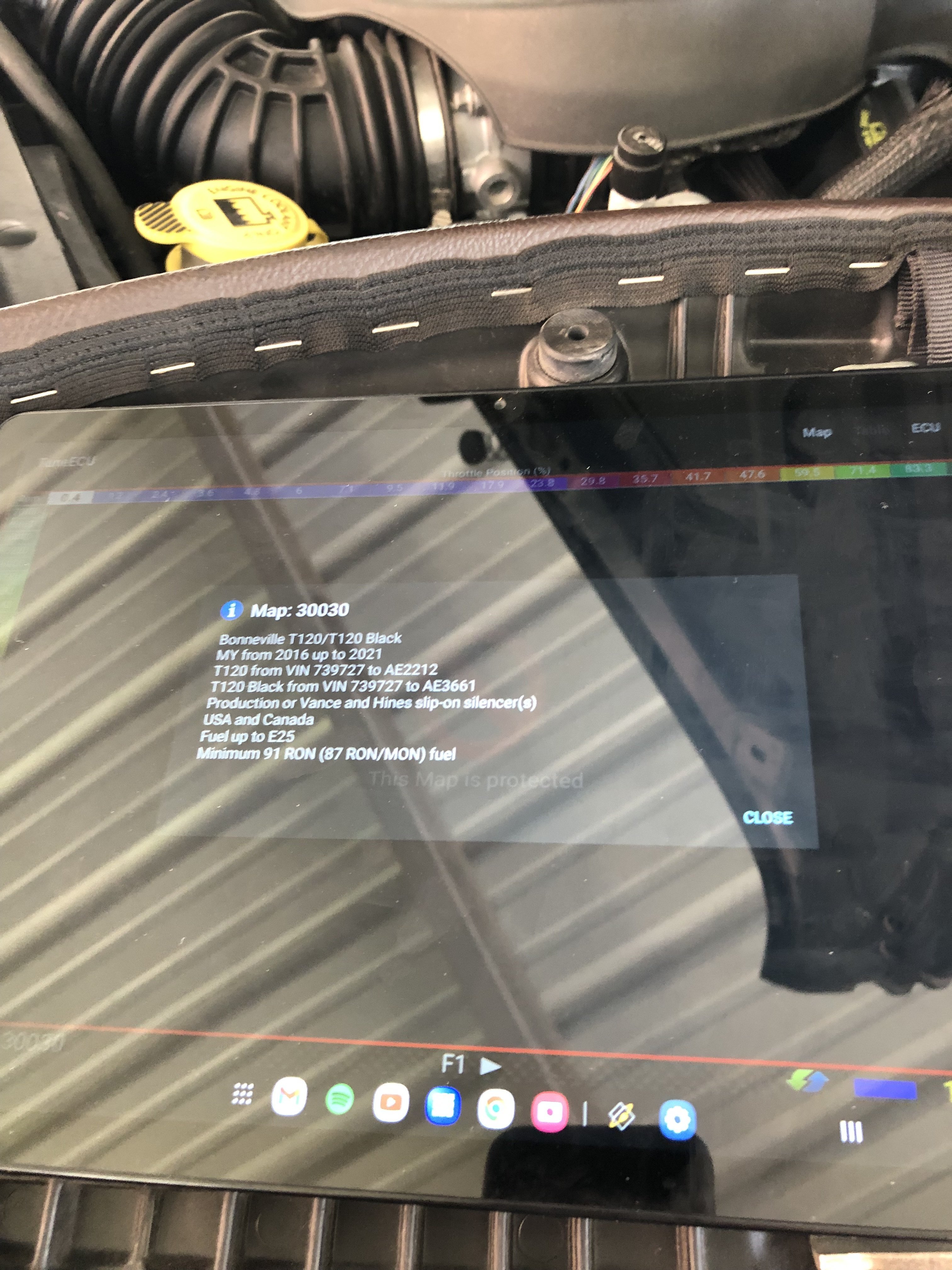

    First two pics are the DNK download file, and the map info
    Second two are what shows when I select “ECU>Information”

    The last photo shows the ‘This Map is protected’ watermark. You may well have been successful!
    The VIN info and the exhaust information shown will in all likelihood be historical left over data from the OEM map as the DNK map fuel & ignition tables are overwritten on top of the stock Triumph map.

    Yes, but that shows any time you simply try to view the map since DNK doesn’t want them to be duplicated.
    I can pull up any other map and view it’s data without uploading it, so long as it’s not protected.
    With the screen that shows my ECU info with my VIN, it shows the stock map and the correlating map info, which is where I would *expect* to see the DNK map, but I could be mistaken. I guess the better question would be, is there a way to verify in TuneECU or elsewhere, that my bike has the new map?
