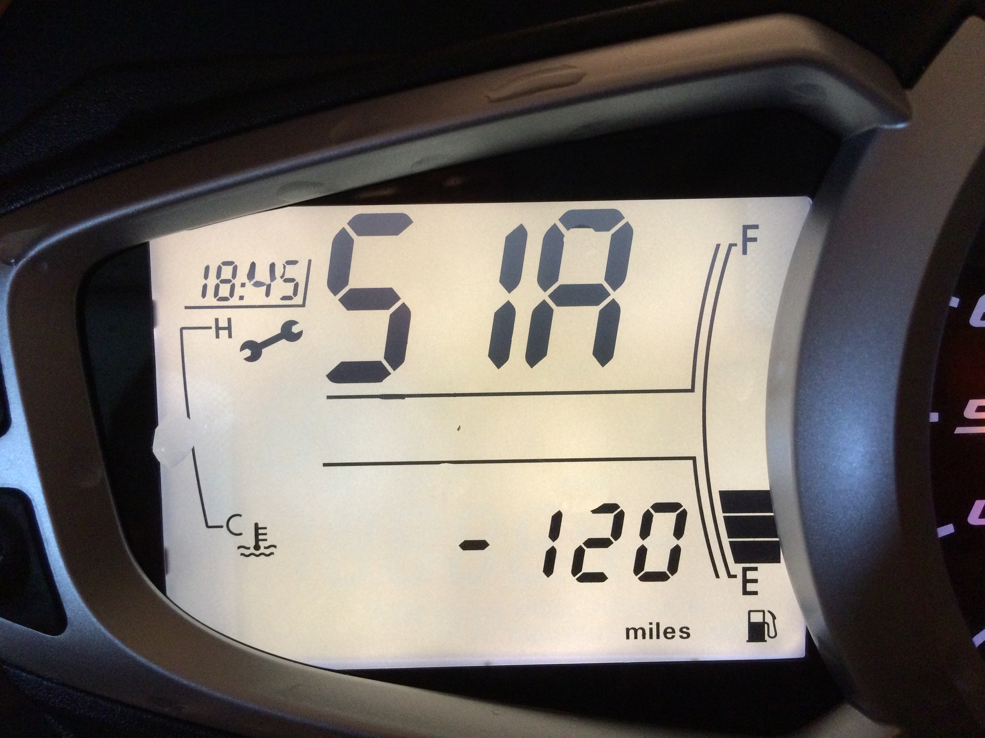

    I have been looking through the set up of my Speed triple 1050 dashboard. After scrolling through the menu ( time, units, shift, odo )the wording 'SIA' ( could be 51A) appeared where the speed numbers would normally be shown.
    I know it is over due a service by 120 miles but I will be doing my own servicing. But I am not sure what this means as there is no mention of it in the handbook.
    Any help would be appreciated.

    I managed to get a picture to clarify the wording. I have asked a couple of my Speed mates and none of them have seen this!
    Any thoughts?

    Just hazarding a guess here but I would think the S may be for SERVICE given it has a spanner next to it. No idea what the 1A stands for but expect it is related.

    Had a quick search and SIA = Service interval announcement. Check out this LINK especially posts 8 & 11, for more info.

    Many thanks for your help the link was very useful.
    I just need to decide if I ride up to Plymouth (160 miles round trip) to get the service reset done or just ignore it.
    I fancy doing all the servicing myself so I know it has been done correctly and I learn more about the bike!
    Perhaps it will just go away after a while if I ignore it, that seems to happen with most other things in life!!

    Using the free Tuneecu program along with an OBD2 lead can remove fault codes but unsure if it can also remove service schedules.

    Nice one with a Dealer Tool link. I do all the maintenance myself. Now I can do the necessary service and turn off the Service indicator and set for the next due service :). Thanks a million

    If you use TuneECU on Android via Bluetooth I believe you can reset the service interval (see here about 3/4 down).

    Thanks for the info Col C, but I only have Iphone and macbook. I am hoping to borrow my wife's work lap top and install the software on that ( i have to persuade her yet)!

    Tony B. The guy you mentioned does have all the kit to remove the 'Wrench' but his kit is away being calibrated at the moment. He sounded a little confused when I spoke to him on the phone so I will ride up there and talk to him in person. I often find that face to face works better!
