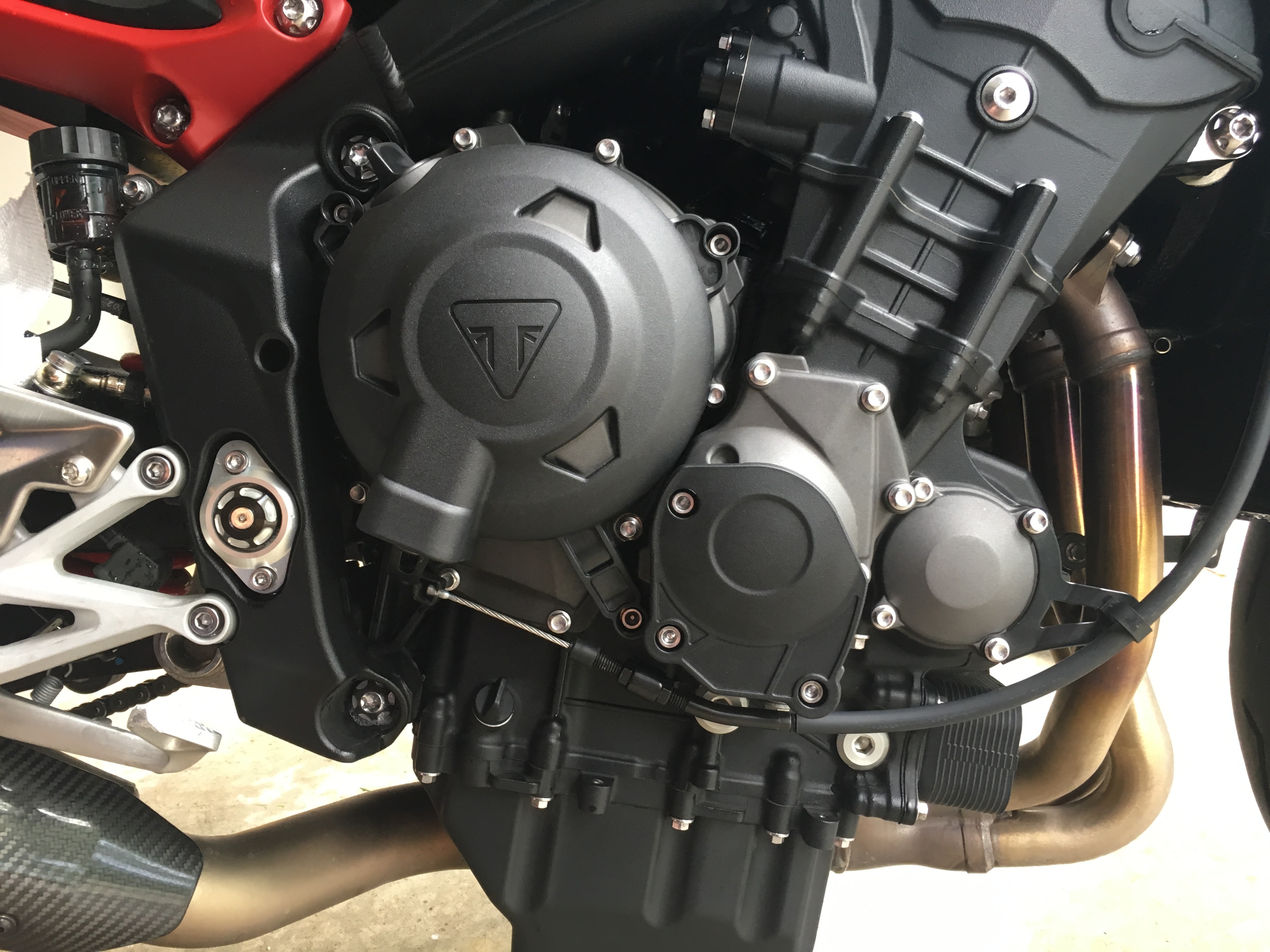

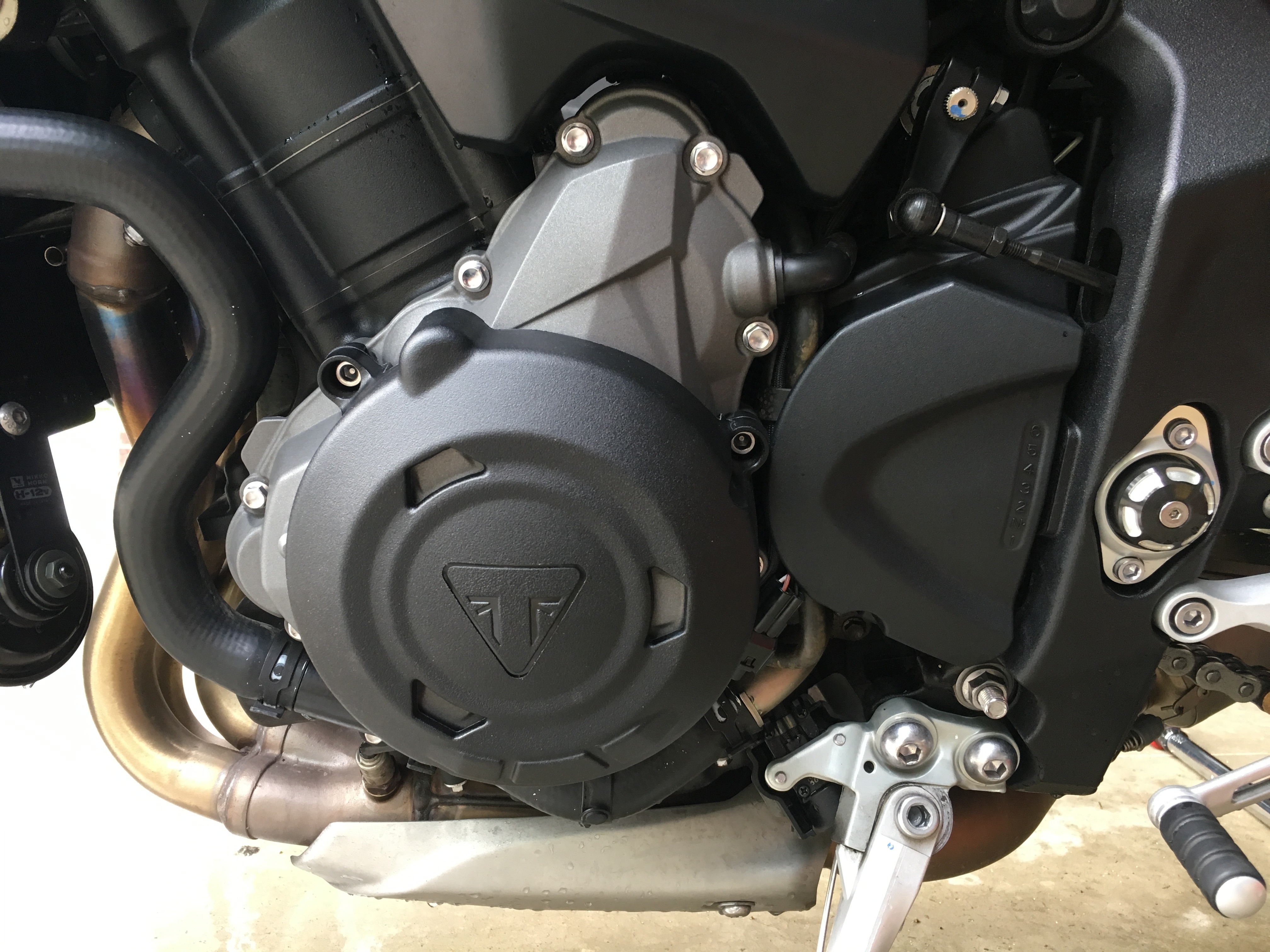

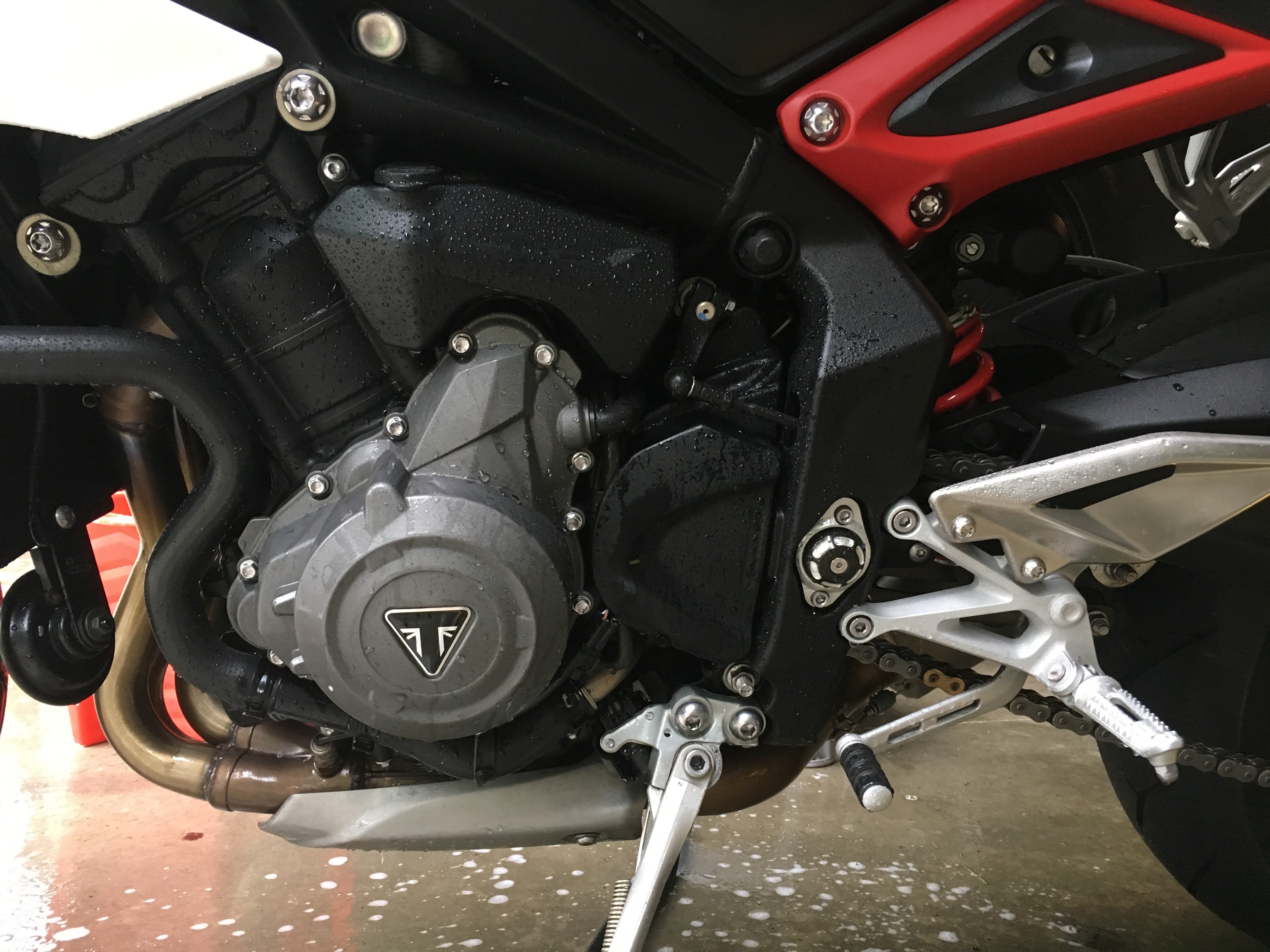

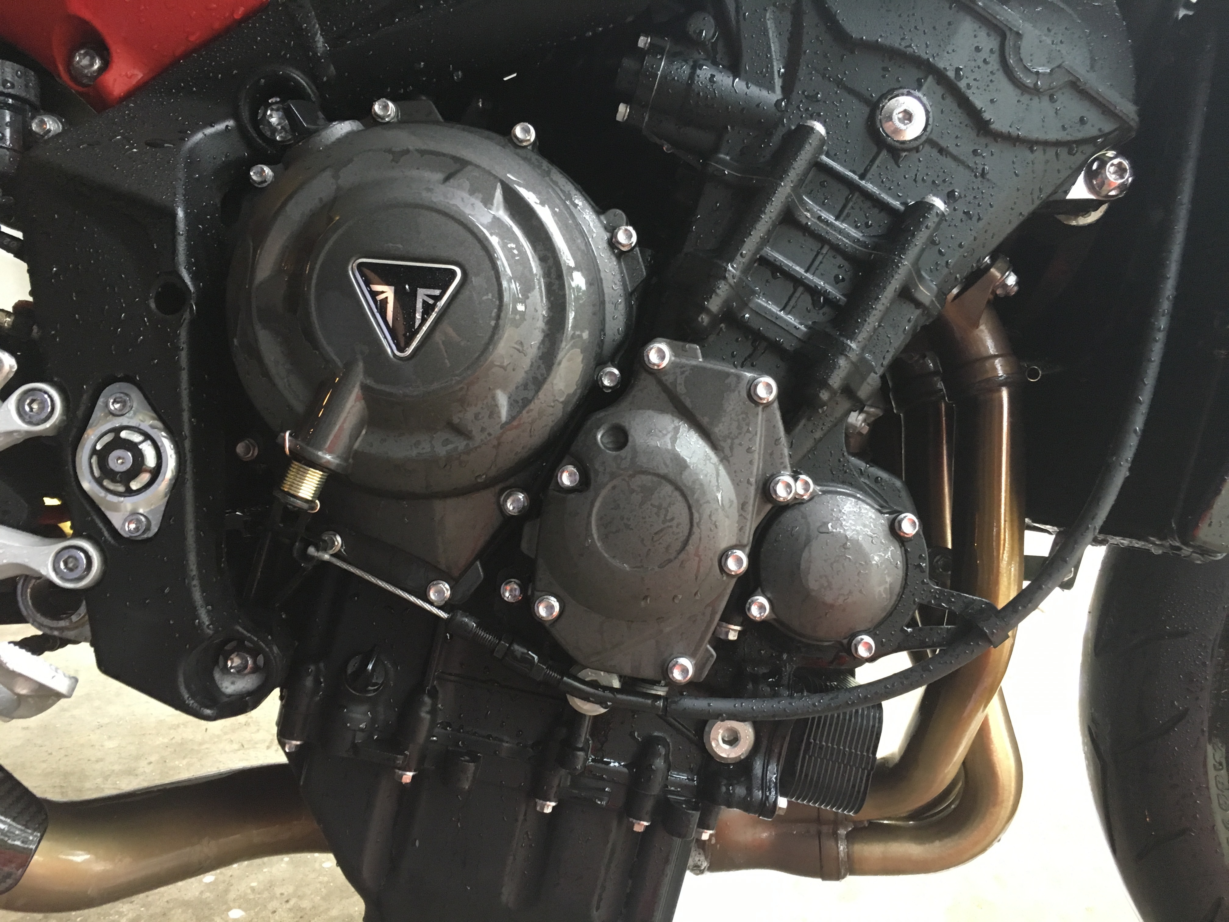

    Hi,
    I’m getting the bike prepped for riding schools and track days.
    Today I installed a set of Triumph engine and clutch case covers.
    I hope neither side leaks after making this change. I don’t have a torque wrench that goes down to 9nm so I just went by feel. Maybe I’ll get a small torque wrench for peace of mind.
    Also, according to triumphinstructions.com, there should have been 1 M6 washer which I didn’t see in the bag of screws. I just grabbed a washer that I had in a bin that’s small enough.
    I thought I’d share before and after pics for those that might be interested at adding these on as well.
    Personally, I like it better without the covers. But having crashed a few times before I appreciate the protection that a fairing provided. I hope these covers, plus frame sliders can limit damage from initial impact.

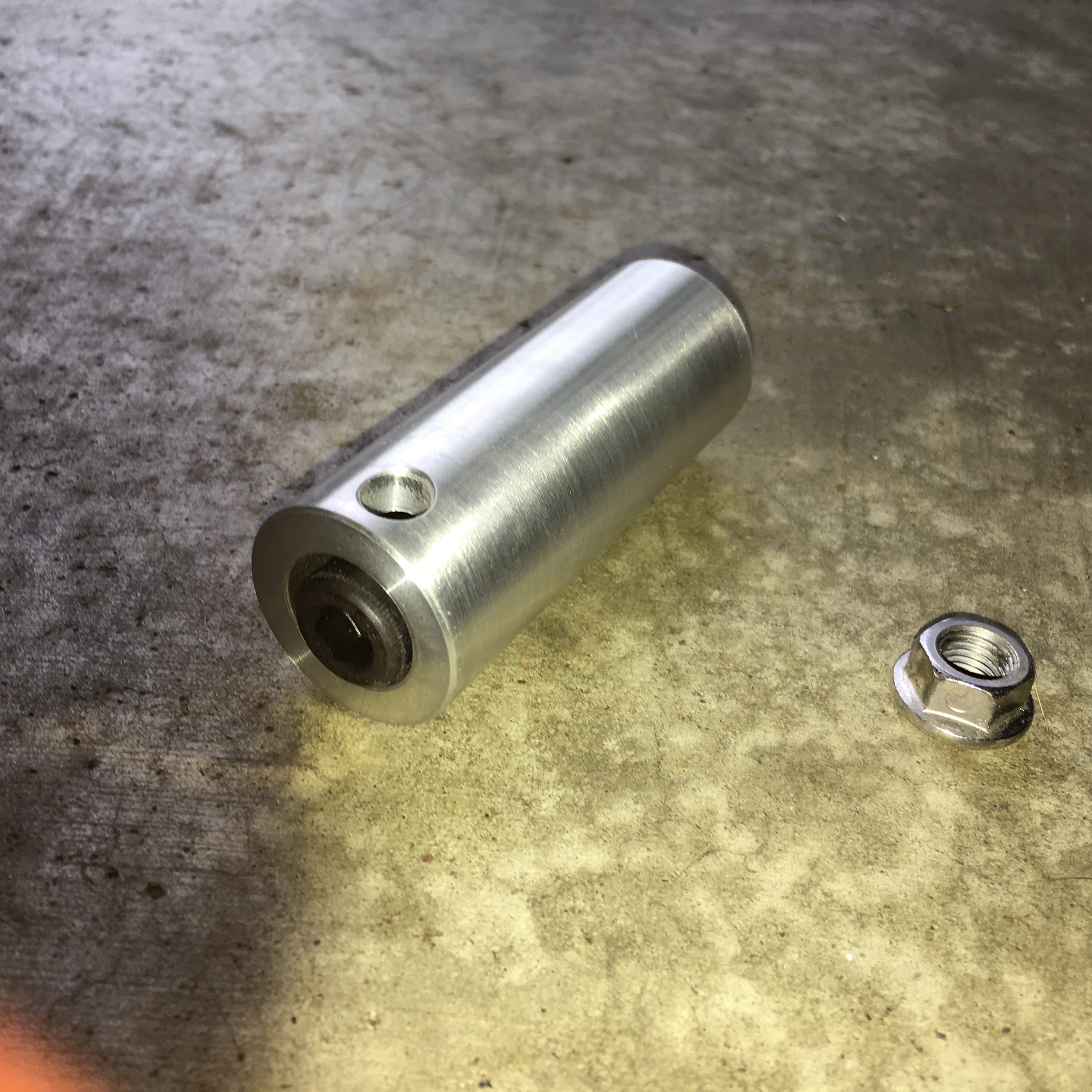

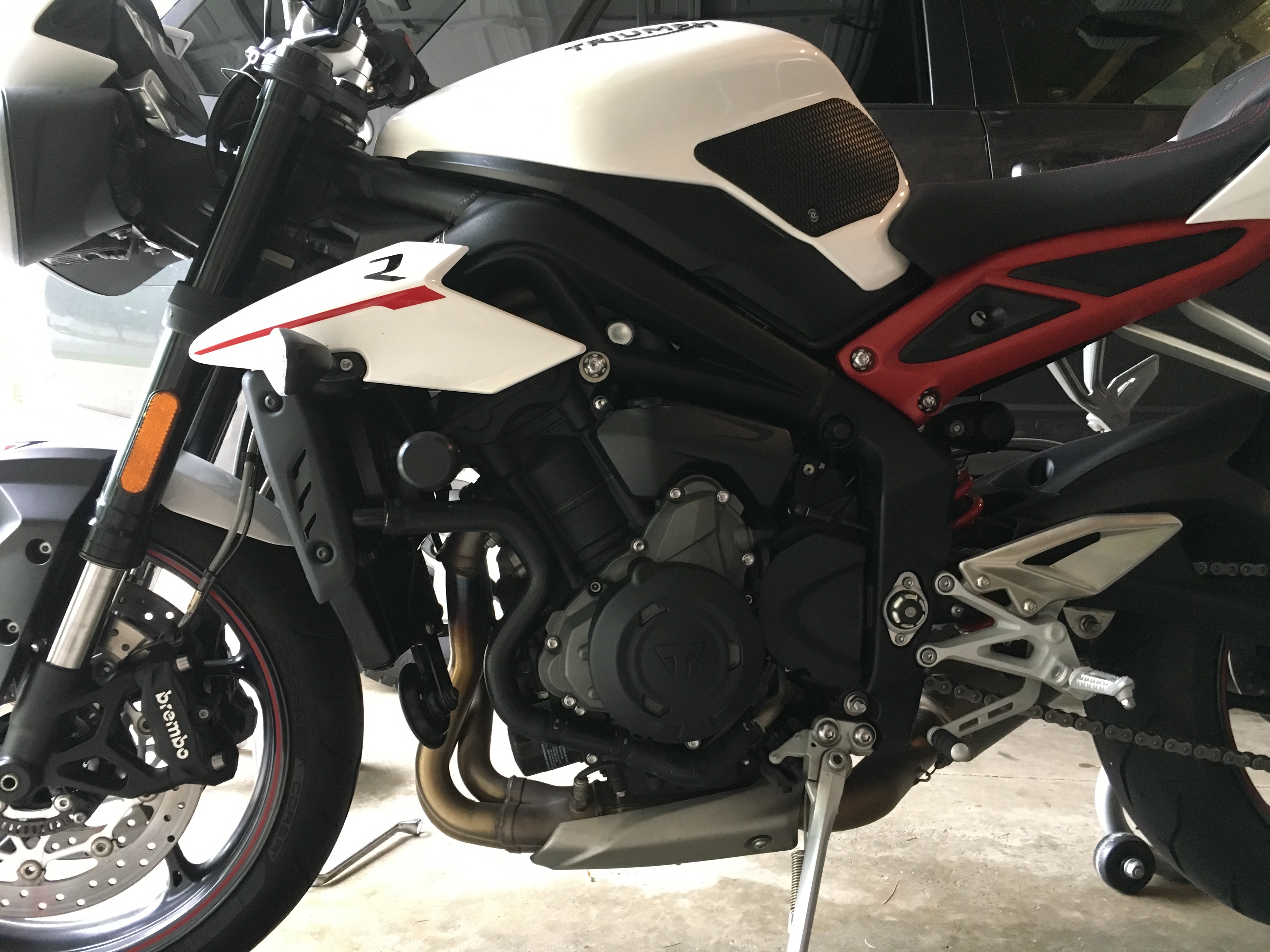

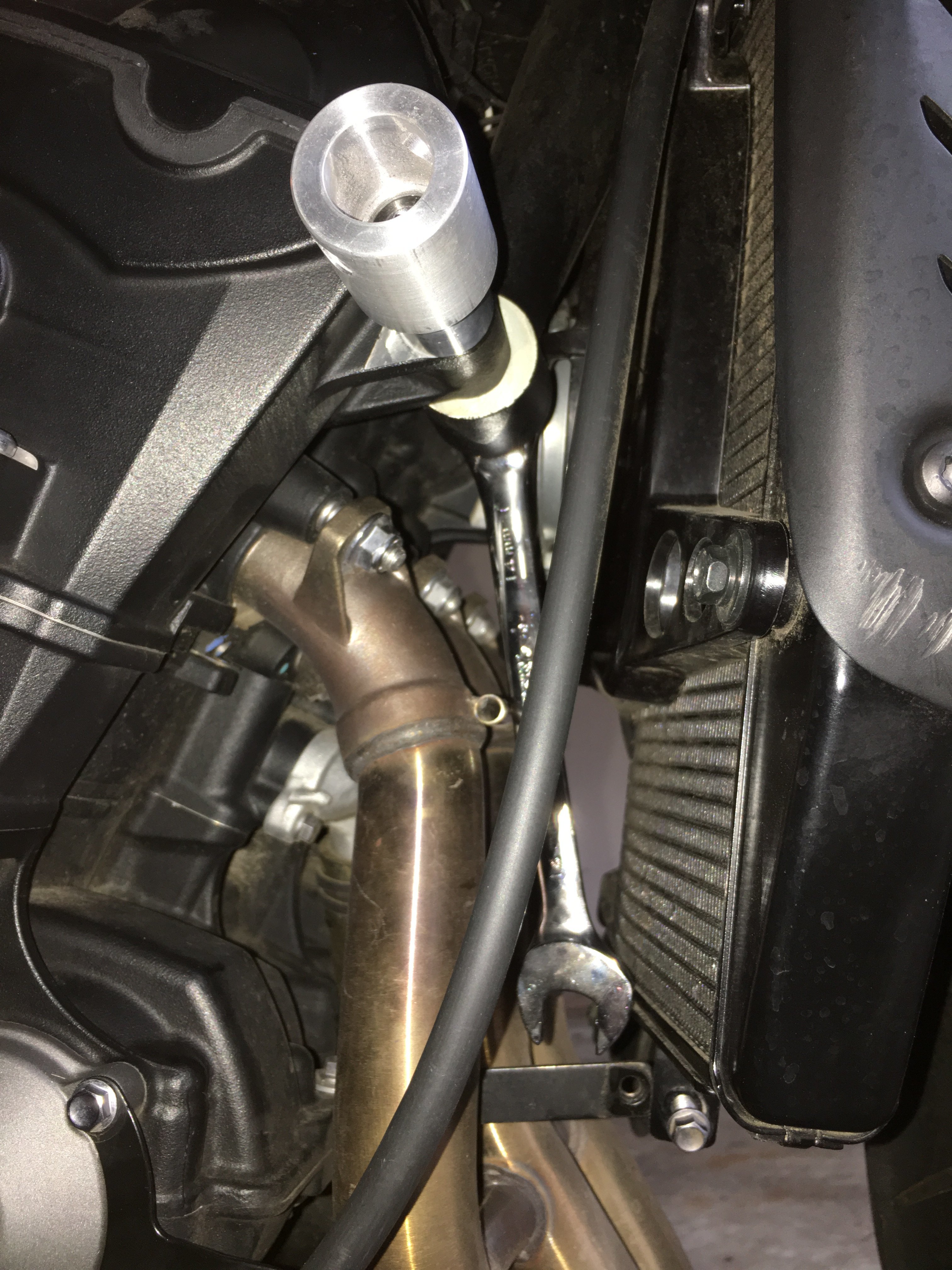

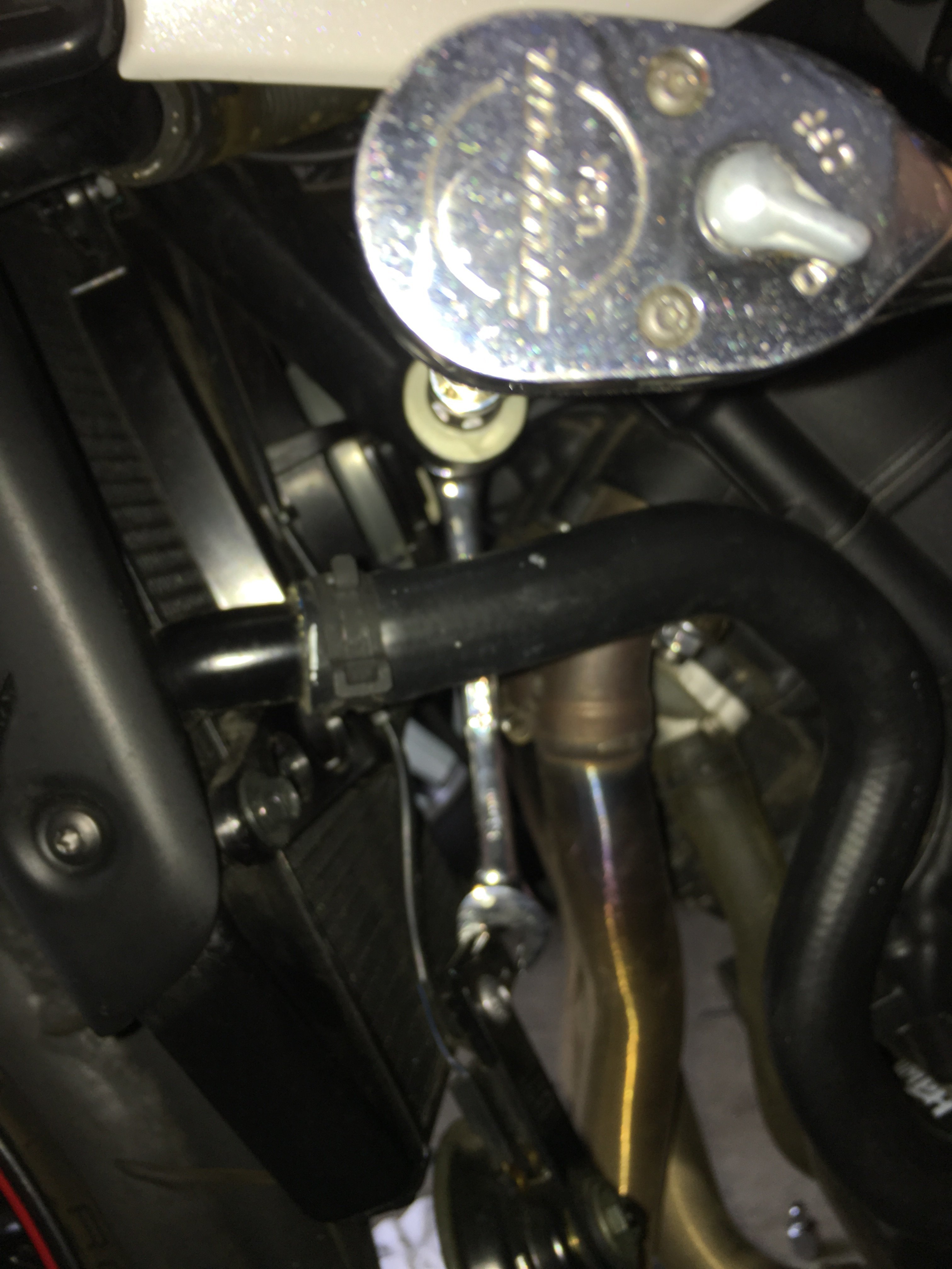

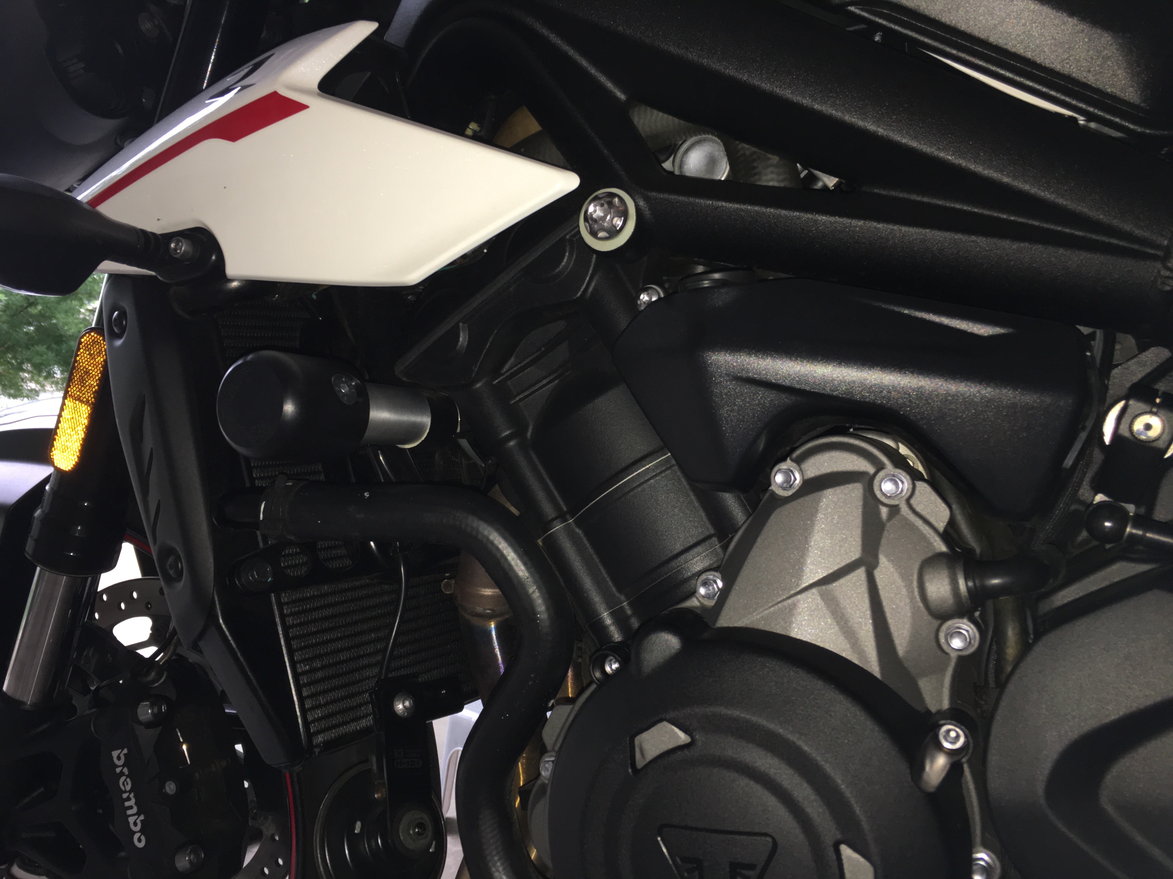

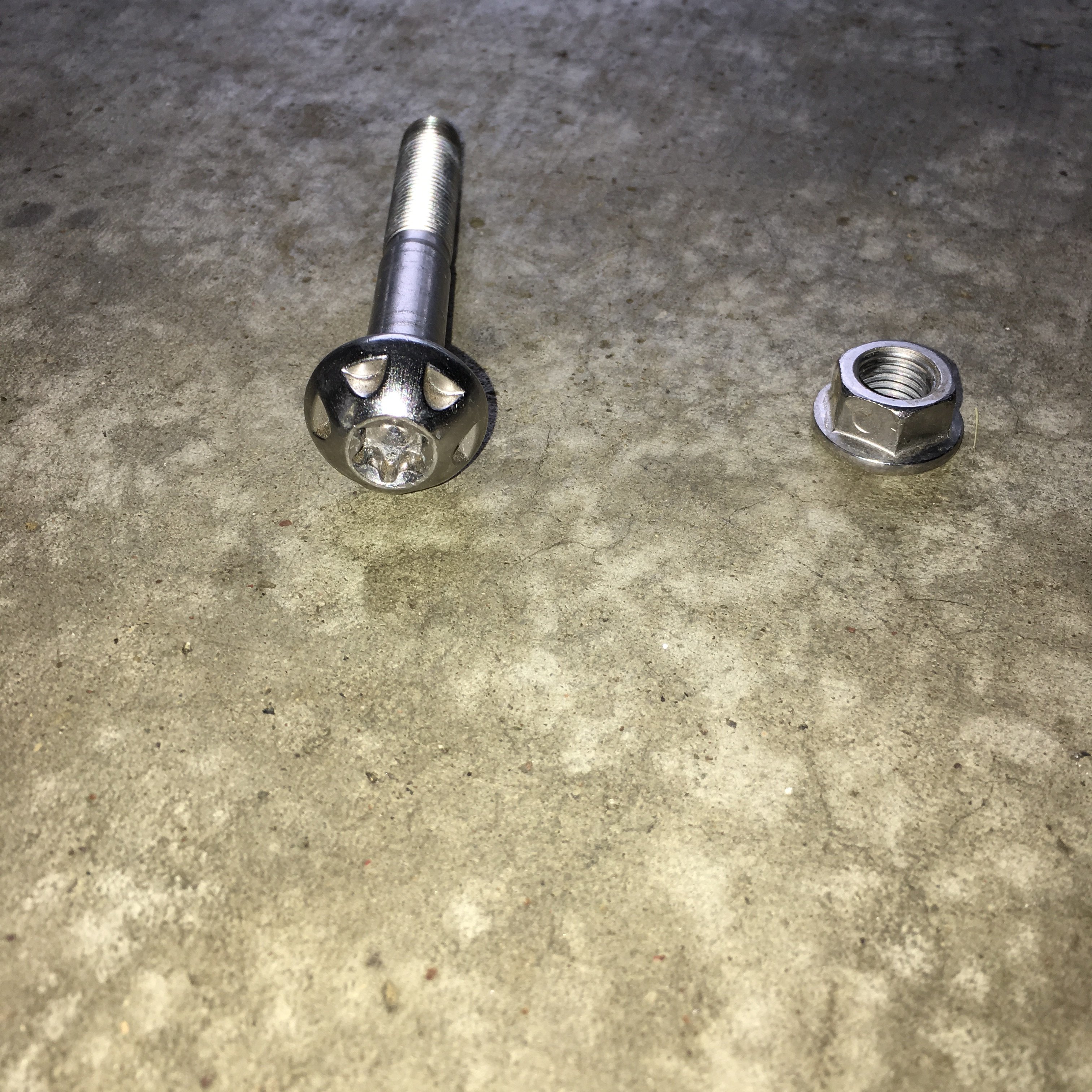

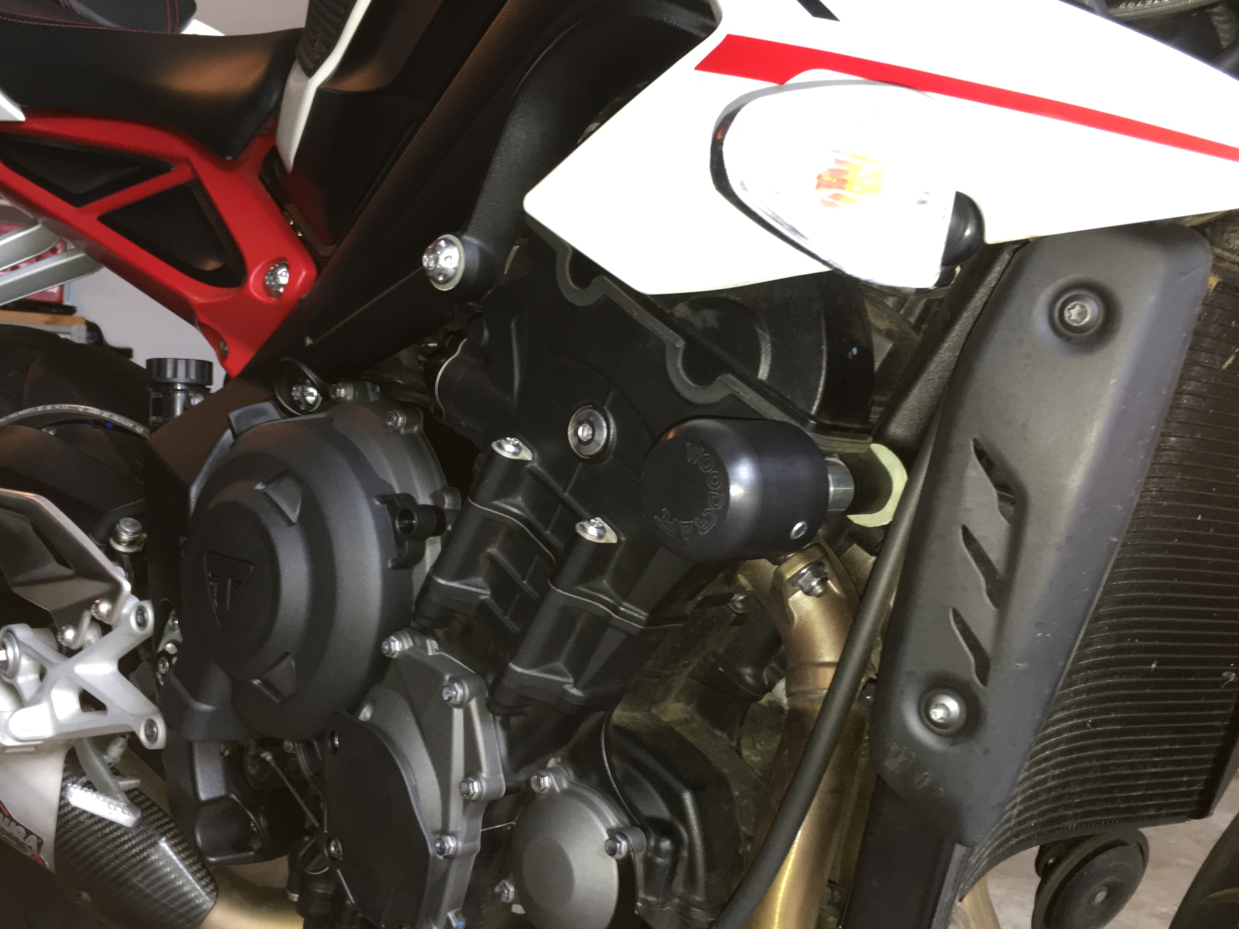

    I just got done installing frame sliders.
    I read so many posts about folks having a hard time with factory engine mount bolt removal because there’s not a lot of room to put a wrench on the nut that’s holding it.
    Hipefully these pictures and trxt help those that want to add frame sliders i. The future.
    If you look at the photos with a wrench hanging off the nut, the trick is to remove the bottom bolt of the radiator and loosen its 2 bolts at the top. This would allow you to swing the radiator away for more room to get to the engine mount nut.

    Have you seen the T-rex engine case sliders in person? Just wondering how they compare to the Triumph ones/ which ones are thicker/ stronger.
  4. topdec
    topdec Member
    May 30, 2018
    Farmington Minnesota
    I think both of those look great. But I don't have real experience with them.
    Woodcrafts are just a fraction of the cost so I went with these.
    If I had to do it again, I would look for sliders similar to the Woodcrafts but those that would stick out farther. I didn't know until I read the instructions that these were actually designed to fit under the 675R fairing.
