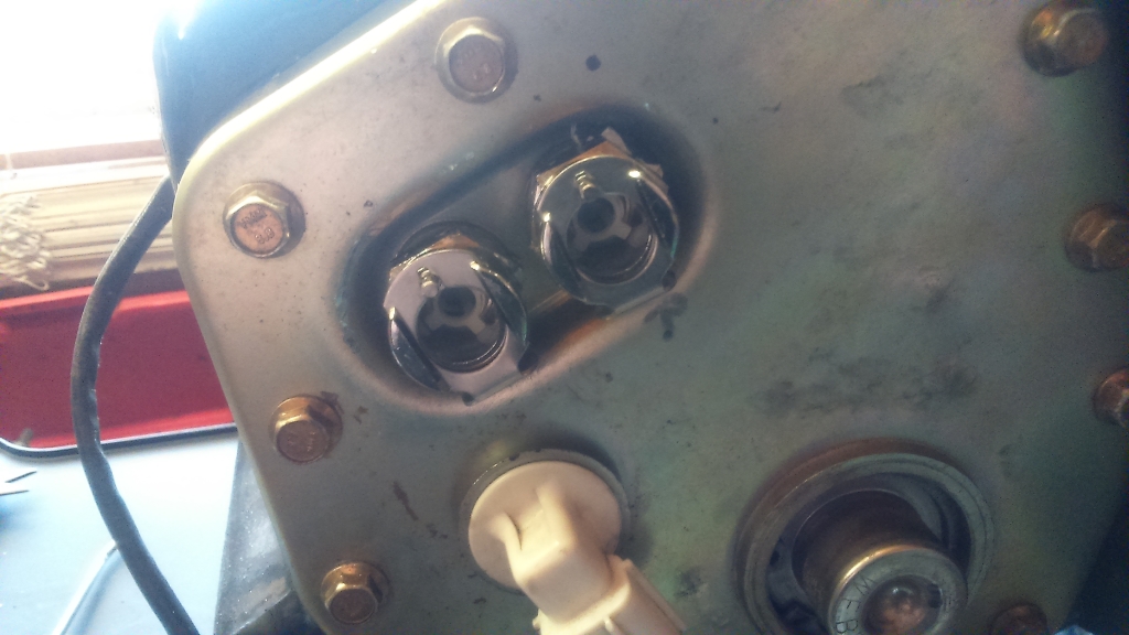

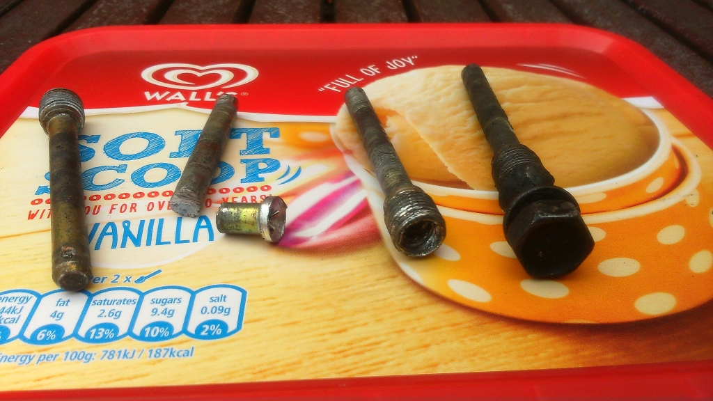

    After finding when putting in new brake pads a serious bodge job on the pad pins on my newly acquired '03 S3 I figured best to go over the bike for piece of mind. I changed front & rear pads and 2 pins needed drilling out and one was found to have a bolt welded to the end. During the week I ordered a couple of metal replacement fuel couplers to replace the standard plastic ones which I believe can be a bit unreliable, good job because first time removing the tank I snap the plastic ones off, DOH! After an hour digging out the plastic remnants I got the metal ones fitted.
    With the tank out of the way I removed the airbox noting the air temp sensor stuck down with tape as connector not clipping to the sensor and the 2 wires having chafed. Easy enough to sort. Pull off the lower airbox and the throttle bodies come away with them, awesome, not even secured to the inlet rubbers. Once secured I connected up by carbtune to balance the throttle bodies, way out as expected but 5 mins and all nicely balanced.

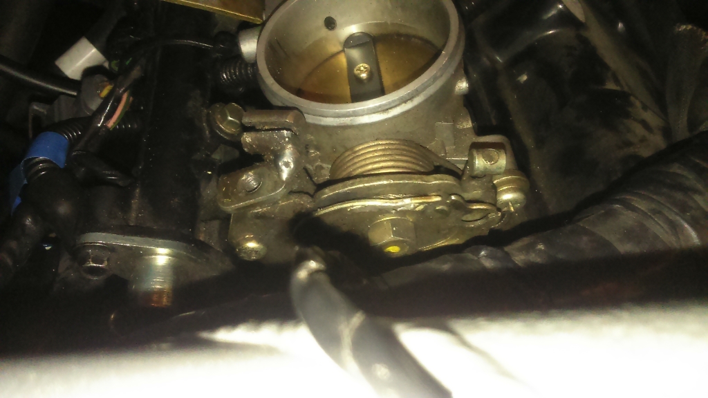

    Since getting the triple I've also found the amount of twist available in the throttle to be too much after previous bikes with Kawi 10R throttles fitted. So milled up a ring of acetal to fit over the cam to increase the diameter from 31.5mm to 38.5mm. After adjusting the throttle cables I can now go from idle to WOT without needing a second grab at the twistgrip. Am finding it much easier to get off the line not needing to twist the throttle so much.

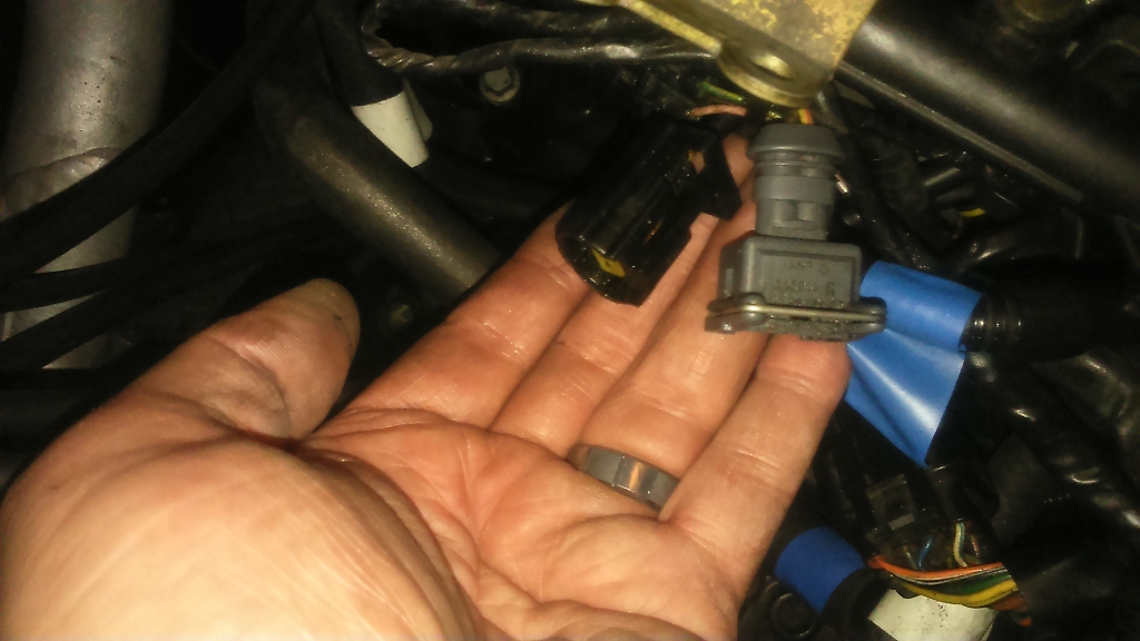

    So if your not bored yet with my rambling there's some pics below and a couple which you may be able to help answer. One is of the throttle cam which I'm unsure about as it appear to have a couple of bits welded on, is this normal? The other is of two connectors that sit under the fuel rail, neither were connected but would be interested to know what they are there for?

    Re the spare wiring linkages, I understand that as the wireing harness is used for Californian models with additional environmental gadgets to reduce immissions, the plugs are on all models just not attached to anything.
    Not sure about the throttle cam...
