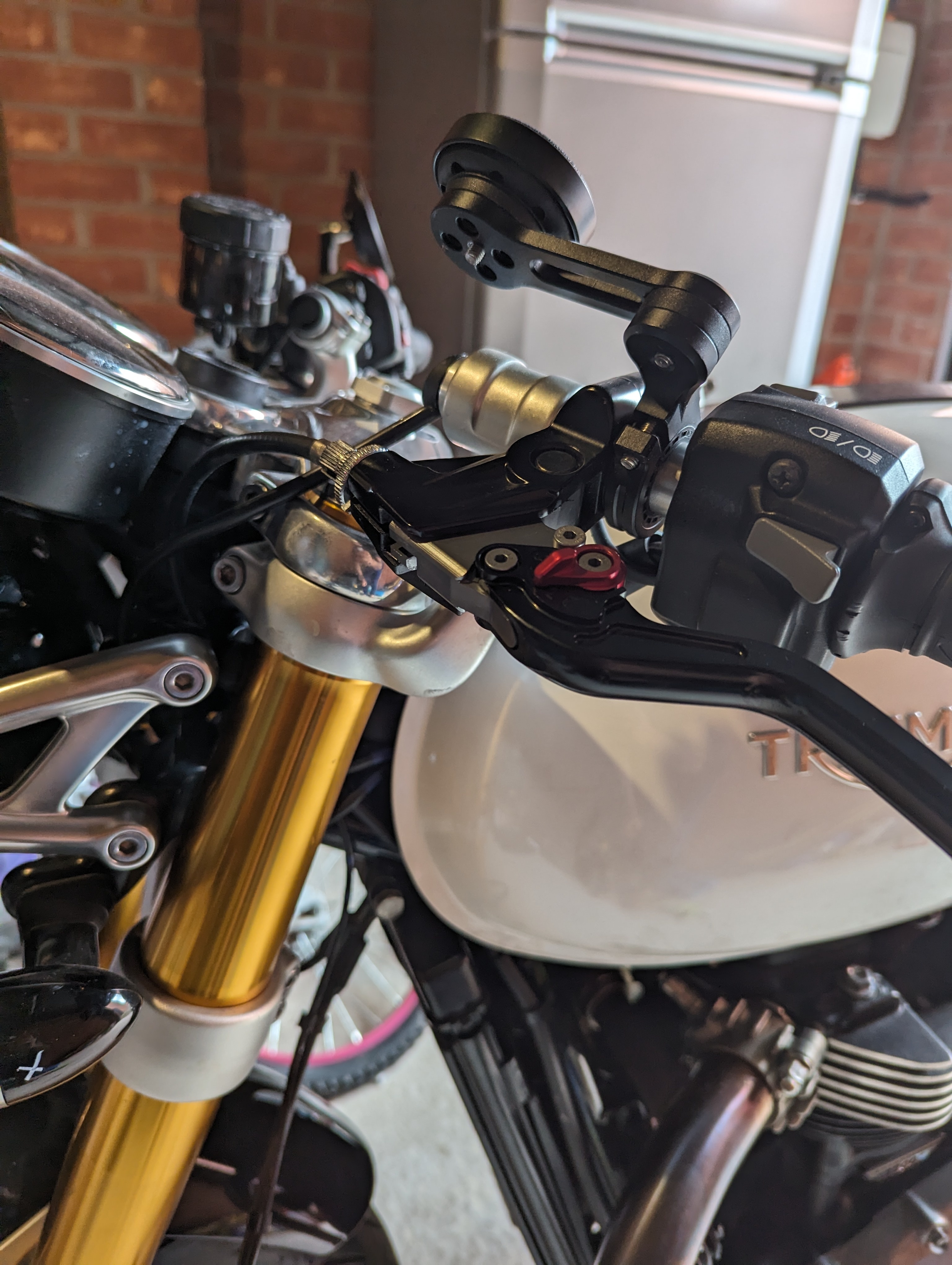

    Upload a picture showing your clutch lever and perch (the bit that fastens it to the handlebars)?
    There is no fluid at the handlebar end to operate a cable clutch, only an hydraulic one.

  9. Camran
    Camran New Member
    Jun 10, 2024
    Worcester

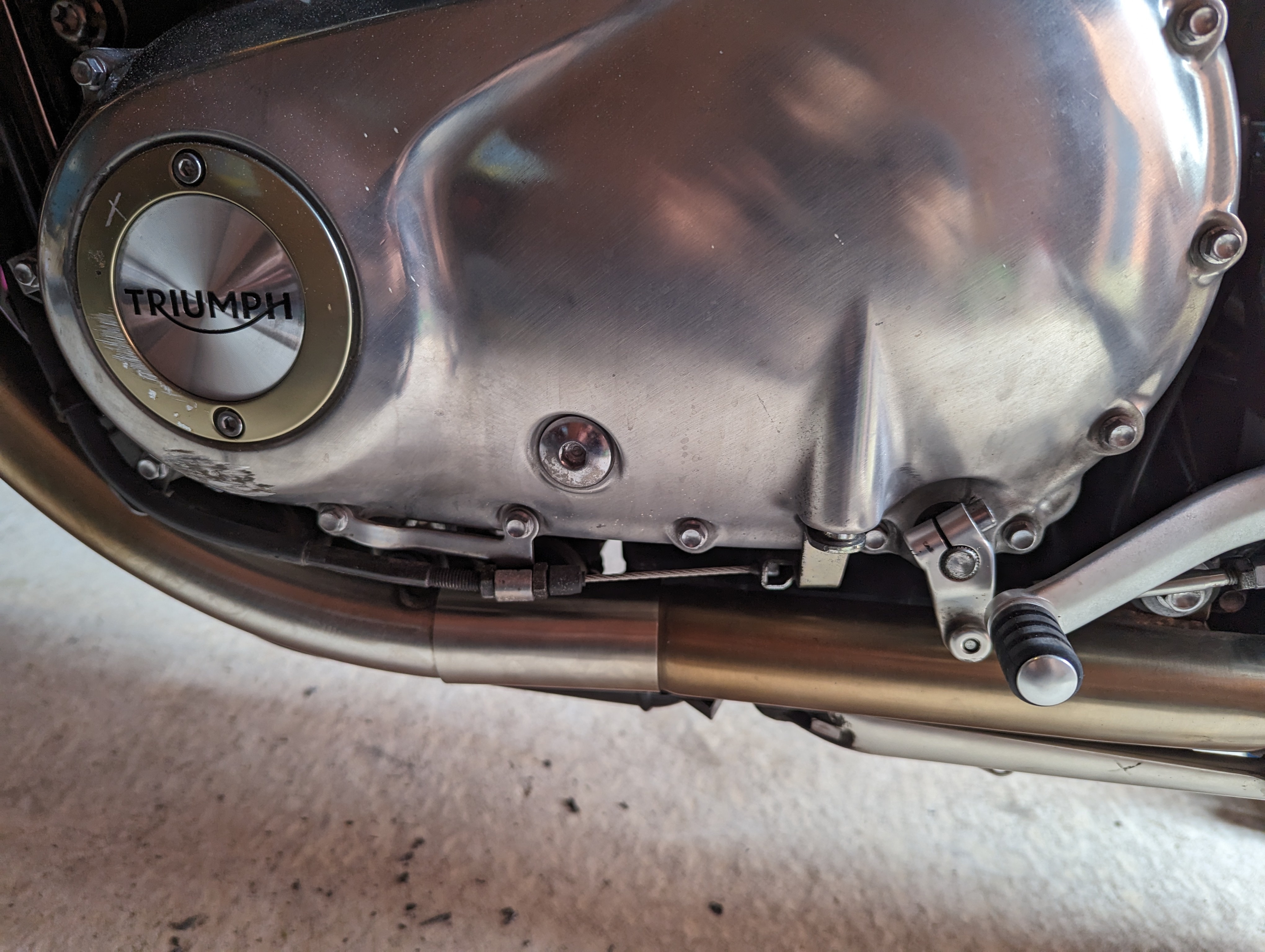

    Nothing in that manual
    Loath to pay 120 pounds plus vat for what should be straight forward but yes it might come to that
  10. Camran
    Camran New Member
    Jun 10, 2024
    Worcester
    Looks like engine oil feeds into the clutch

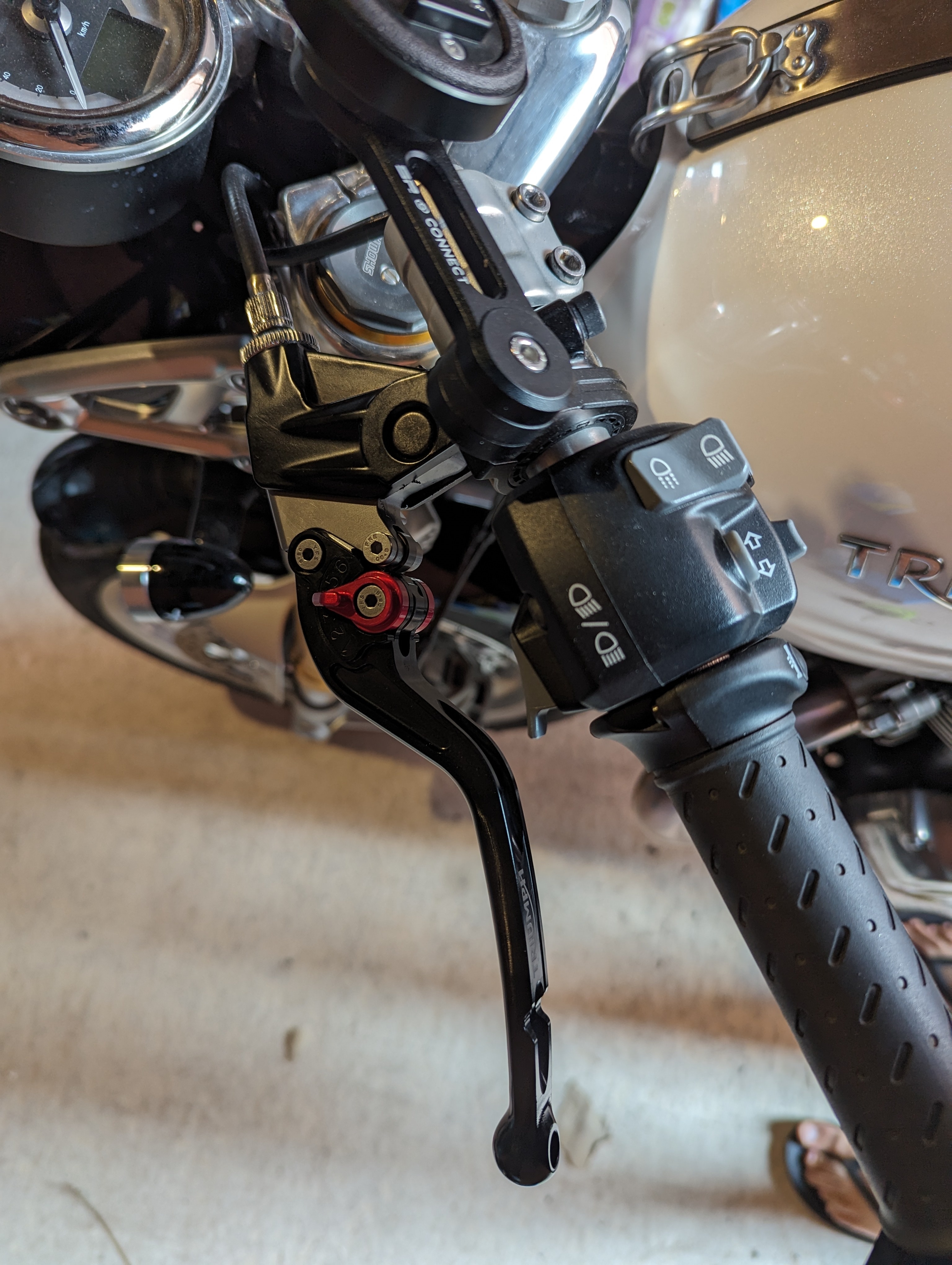

    It has a cable clutch, there is only a fluid reservoir for the front and rear braking system. The clue should have been at the clutch lever with no sign of a hydraulic hose only a visible cable.

    @Camran Seems you got of to a rough start. But mate we all started somewhere. Your clutch is cable operated. Feel the lever and adjust that screw so you have a ml or two free play on your lever job done. That screw on your clutch case is just a gimmick. When you do an oil change it supplies both engine and clutch. Remember when changing your oil to fill to the level. Then run the engine for a couple of minutes then let it settle for a while then recheck the level via the looking glass or dipstick and top back up to the level As it will drop from the engine filling up the bits like oil filter which is on the belly of the engine as is the drain screw. Hope this helps. And welcome to the family.
