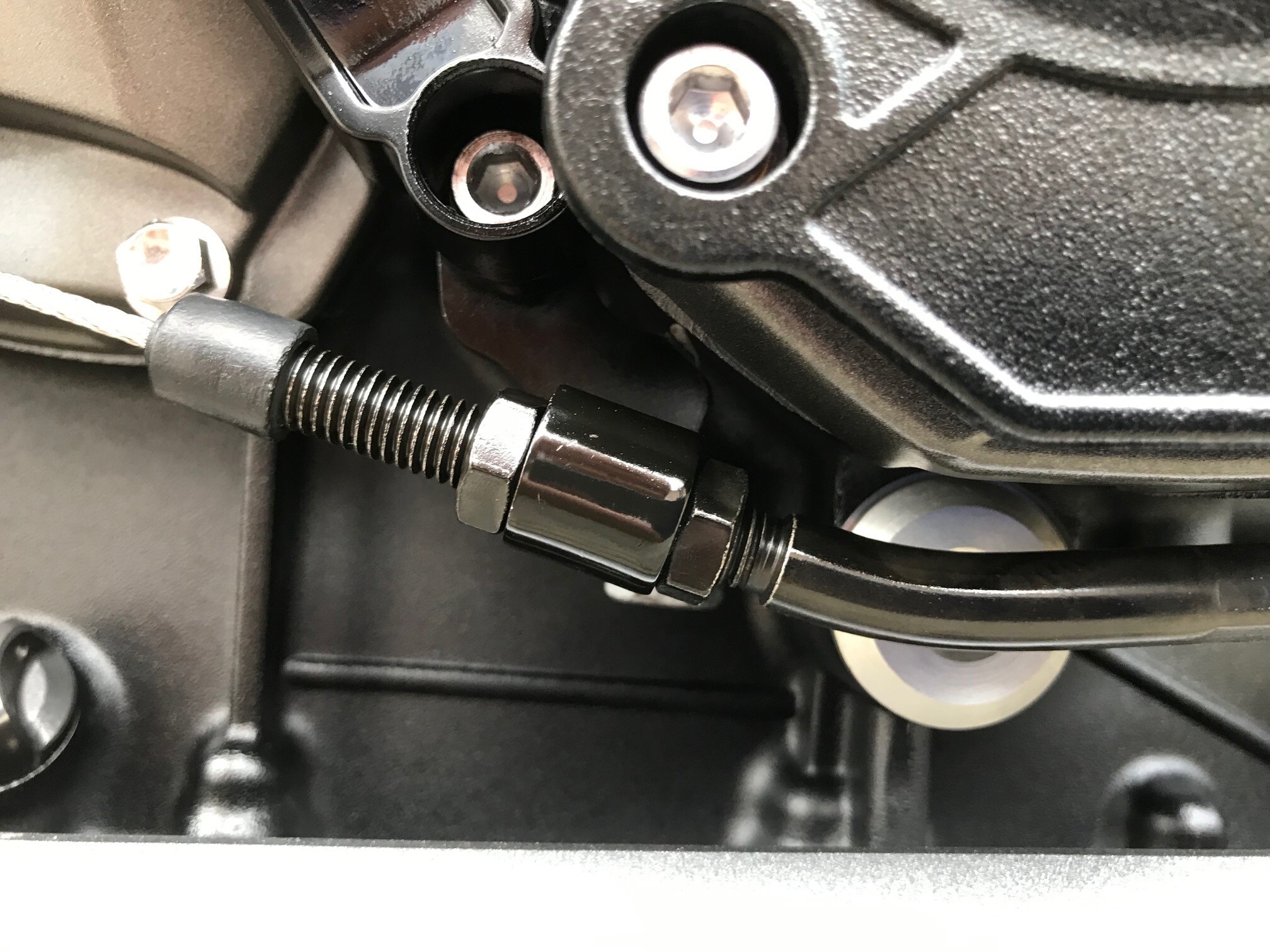

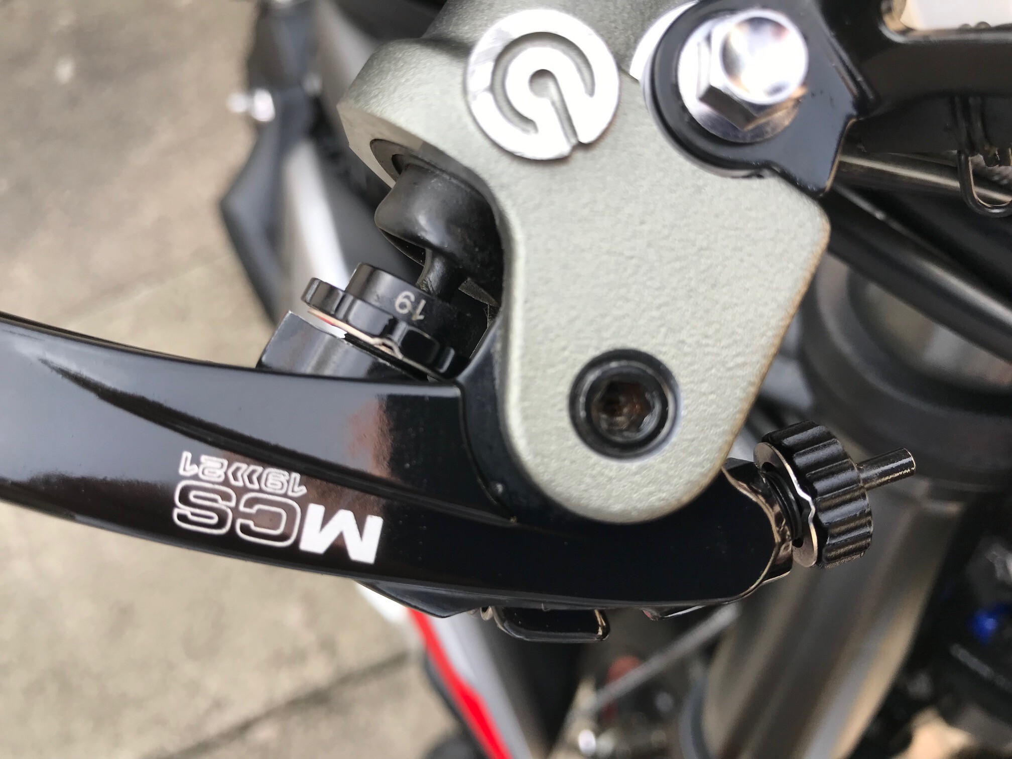

    Hi Superslomo, what you say is incorrect, I have attached 3 photos from my machine that clearly show what I had explained. P1 shows the clutch lever with both the reach adjustment and free play adjustment. P2 shows the front brake lever with both the adjuster for reach and one for altering pressure feel (harder setting for track days) and P3 shows the clutch adjuster at the case. Hope this makes things a little clearer. Ride safe all.

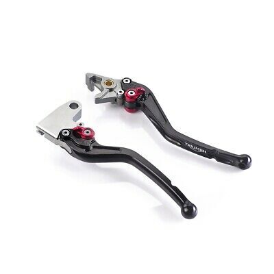

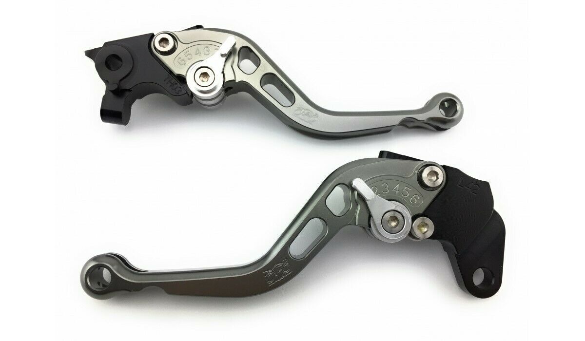

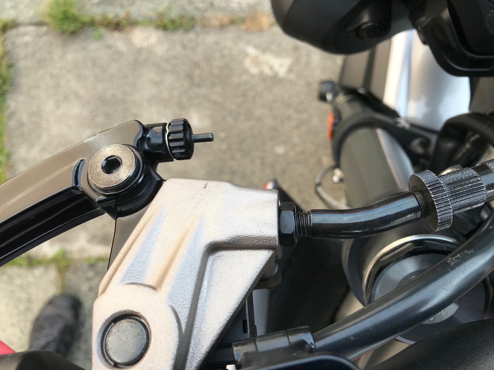

    Hi Superslomo, the picture shown is not unfortunately a 4 position lever, it's a little more sophisticated than that. I have attached photographs showing a 4 position clutch lever (a standard one and an upgrade one, both Triumph), I have also attached a picture showing an aftermarket 6 position clutch lever, however not the 765 variant. I have also attached the correct procedure taken from the official Triumph handbook. I certainly do not wish to be pedantic, however I was offering some assistance to a fellow forum member who originally put the post on, the information I gave initially is correct and hope our friend from the Netherlands has not been to confused.
