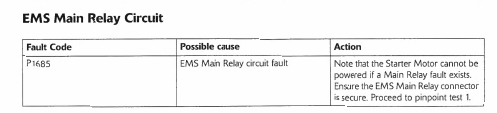

    Found this...
    The code refers to the ECU relay that lives under the seat. Have a look at it and see that it's seated and plugged in correctly. The code can also come up if fuse number 5 is faulty or has a faulty connection. It's labelled as "ECM relay" on this photo:
    And this
    On a 2014 Triumph Speed Triple R, code P1685 typically indicates a fault related to the "Throttle Position Sensor (TPS)" circuit, signifying that the motorcycle's computer is not receiving a proper signal regarding the throttle position, potentially leading to issues with engine performance and fuel delivery.
