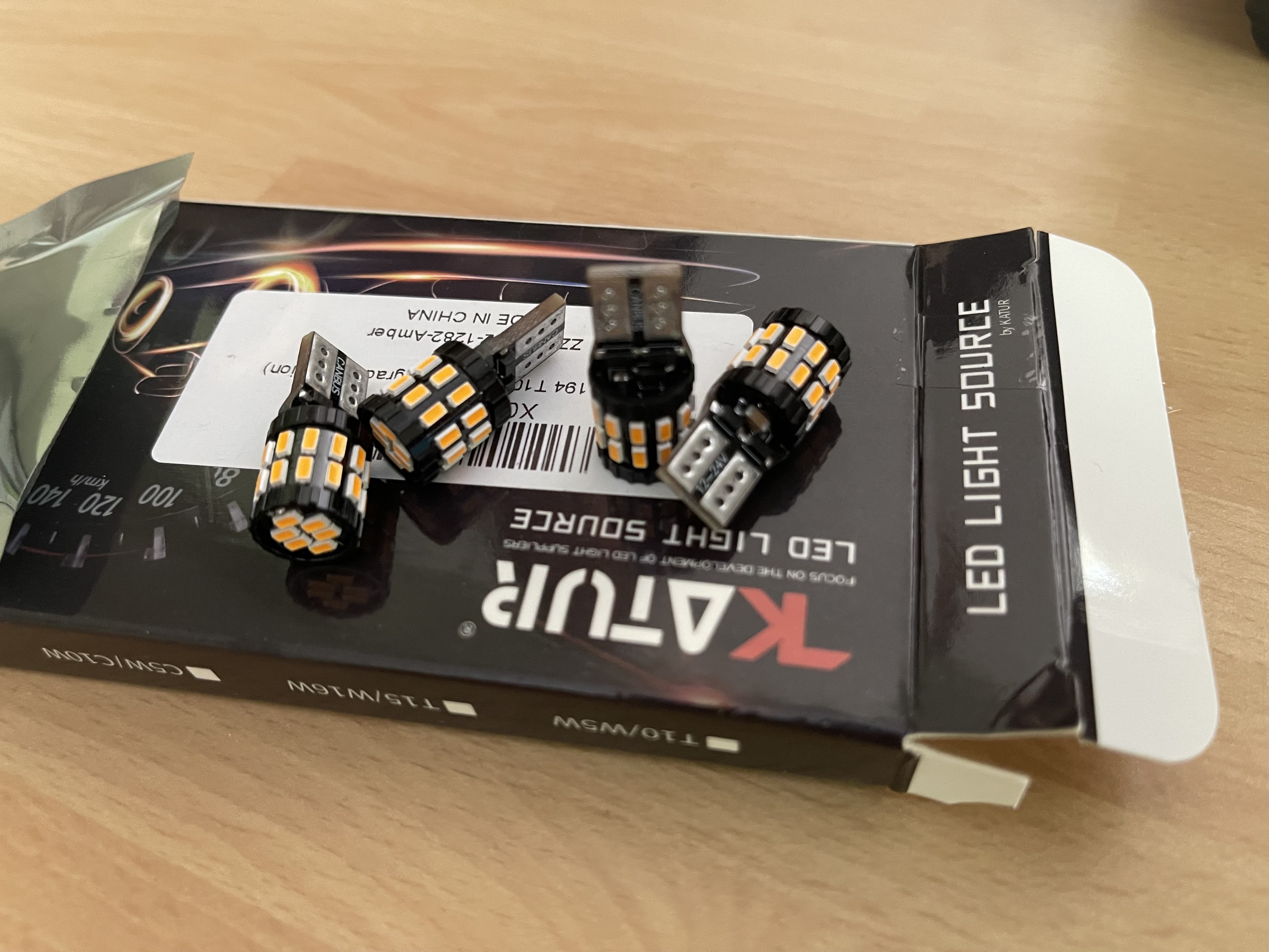

    Gone and ordered some LED T10 bulbs to swap out for the filament ones and see if that makes a difference - should be here tomorrow so I’ll update the thread.

    I’m super pleased to announce that the replacement LED bulbs work fine.
    These where the ones I went for should anyone else find this thread. Cost about £10 on Amazong.
