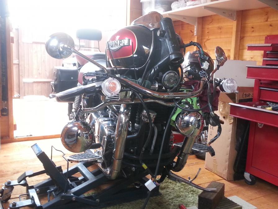

    The bike lift gets my vote....
    The bike is very stable when lifted & you get a lot more lift than you would with a centre stand. My lift can get the wheels a good 12" off the ground!
  8. folkbloke
    folkbloke Well-Known Member
    Jul 20, 2013
    310
    Sussex
    Despite the issues I'd still recommend the centre stand. If you're touring it makes life so much easier. Trying to clean and oil the chain properly without a centre stand is a real pain.
    It's worth pointing out that I had a mate here yesterday who scoffed at my difficulties and proceeded to put it on the centre stand. Not easily but it went! Weaklings'r'us.......
    I guess if you have a garage (I don't) and aren't bothered about touring then the bike lift is a useful tool.
